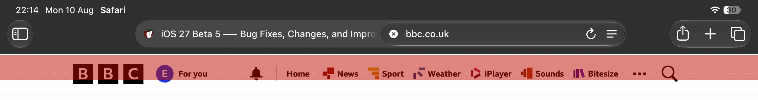

I am having issues with touch alignment in Safari with top menu bars on sites like Gmail and Facebook.
Indeed, I’m finding the red zone pictured is unresponsive to touch.
If I can’t touch the lowest part of a button (or search field) below the red zone I have to pinch to zoom larger to tap.
