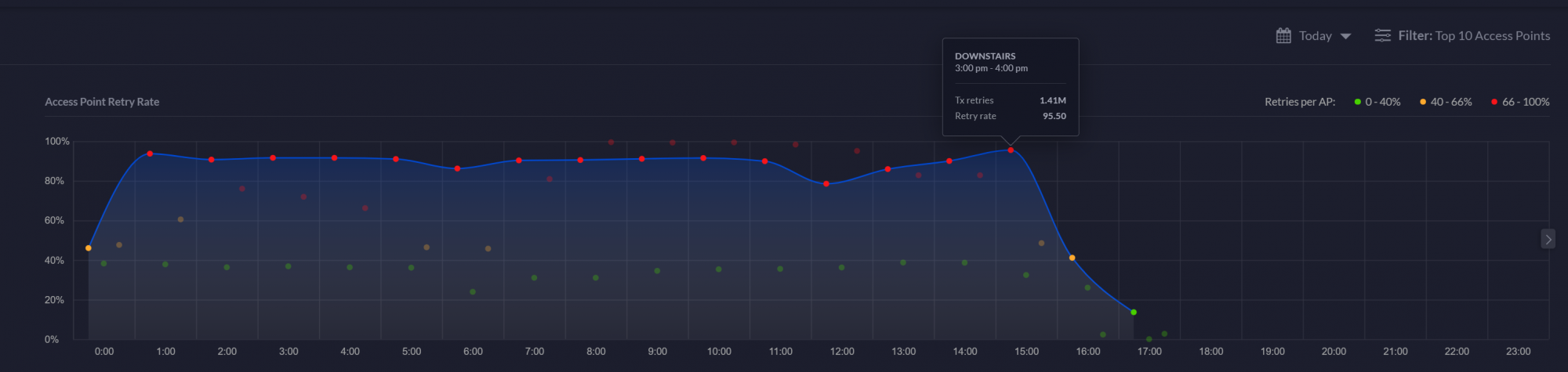

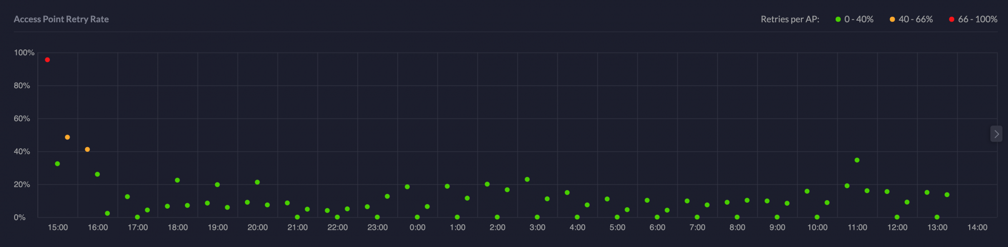

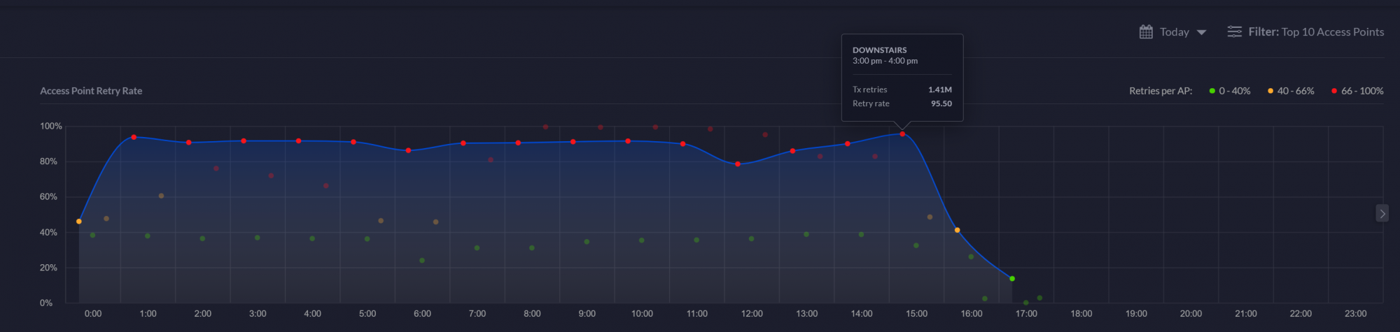

Making these changes seems to have also resolved a (likely related) issue I've noticed for a while now - access point Transmit Retry Rates were through the roof prior to the changes made today - and have dropped off to less than 20% (normal) since. Woo!
So far so good - no dropouts watching streaming media last night since changing to channel 36 HE80. I also found a cabling issue on my wan/lan ports that was causing spanning tree loops I hadn't noticed until I started staring at the logs and graphs - amazed it was working at all >.<.
