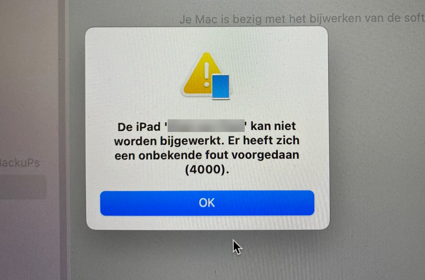

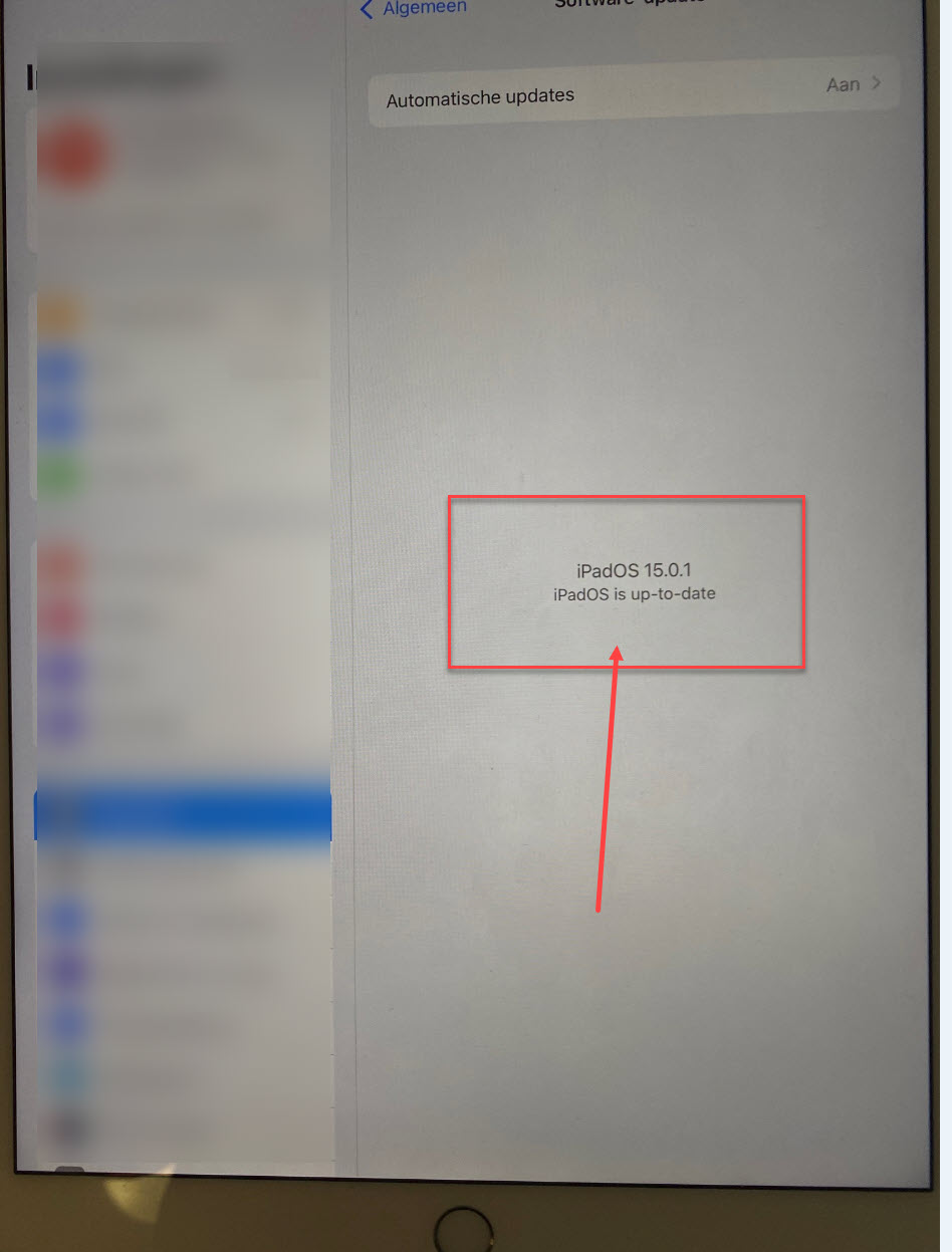

THE SOLUTION
Use the Apple Configurator 2 !
Connecting to the ipad on my macbook pro by finder and try to update also did not work either and resulted in a 4000 error. Apple says its a bad usb cable or connection. That is total crap. Many others are reporting this error aswell on the internet. As if we all have a bad usb cable or connection on the macbook or imac.
It just does not finish and produces a 4000 error .
But updating by the apple configurator 2 Worked perfectly! It took a while and it had to restore the backup after the update, but all went automatically and it updated !
I think apple should debug this issue as it hits many users

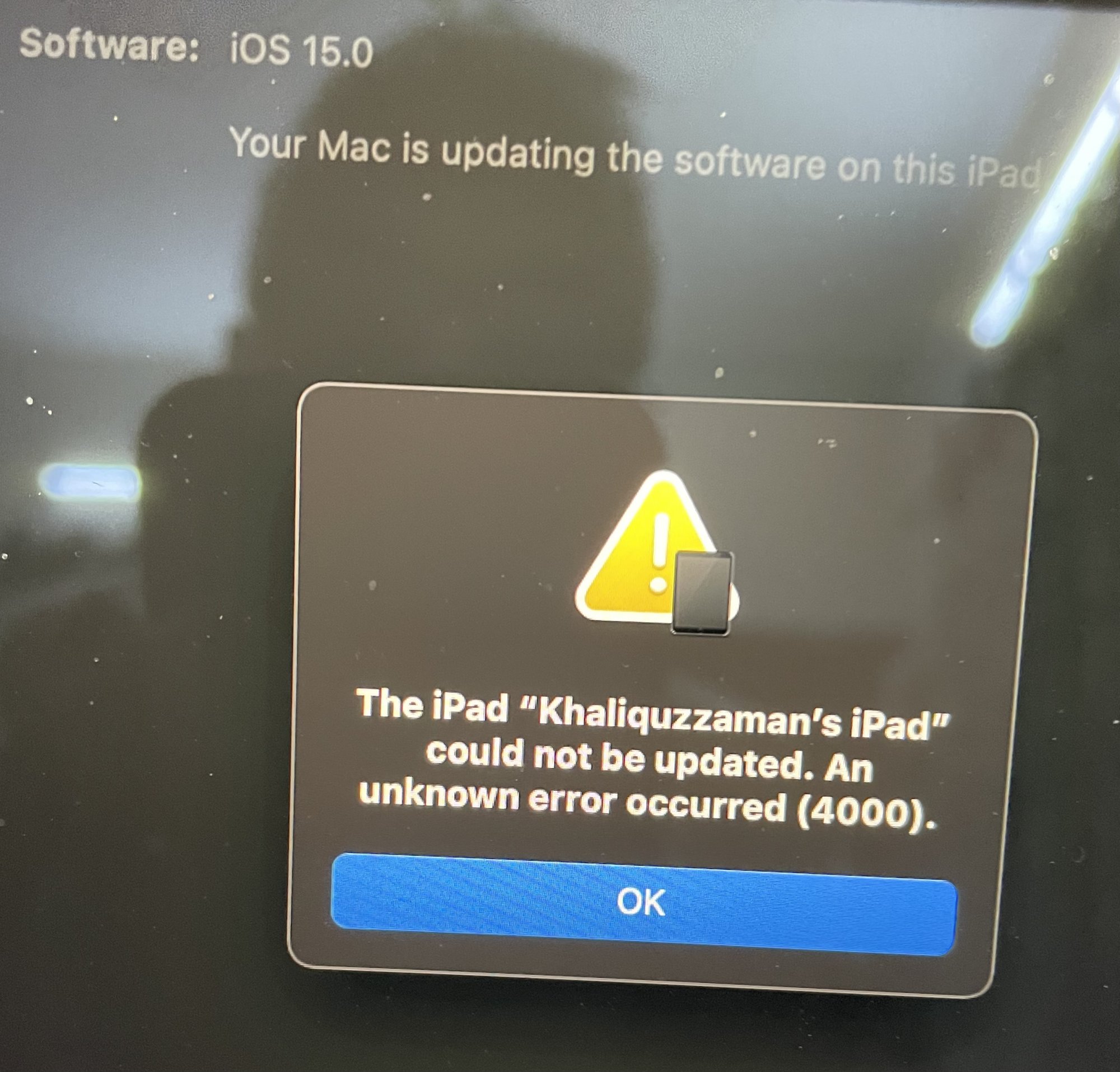

15.0.1 update didn't work OTA or through Finder.
Using Apple Configurator 2, however, did. No need to put into DFU or Recovery Mode, nor was it necessary to reset any settings or turn off WiFi.
The iPad did have to go through a data recovery (the screen "Attempting data recovery" came up, along with a progress bar), but that only took about 15 minutes for me and was successful. I left the iPad plugged in and had Apple Configurator still up during this time. As with any update, make sure you have a backup (either local or iCloud) just in case.
Something is obviously broken, but hopefully this helps someone.
Thank you. This worked for me. (and it happened exactly as you describe: "attempting data recovery" etc)

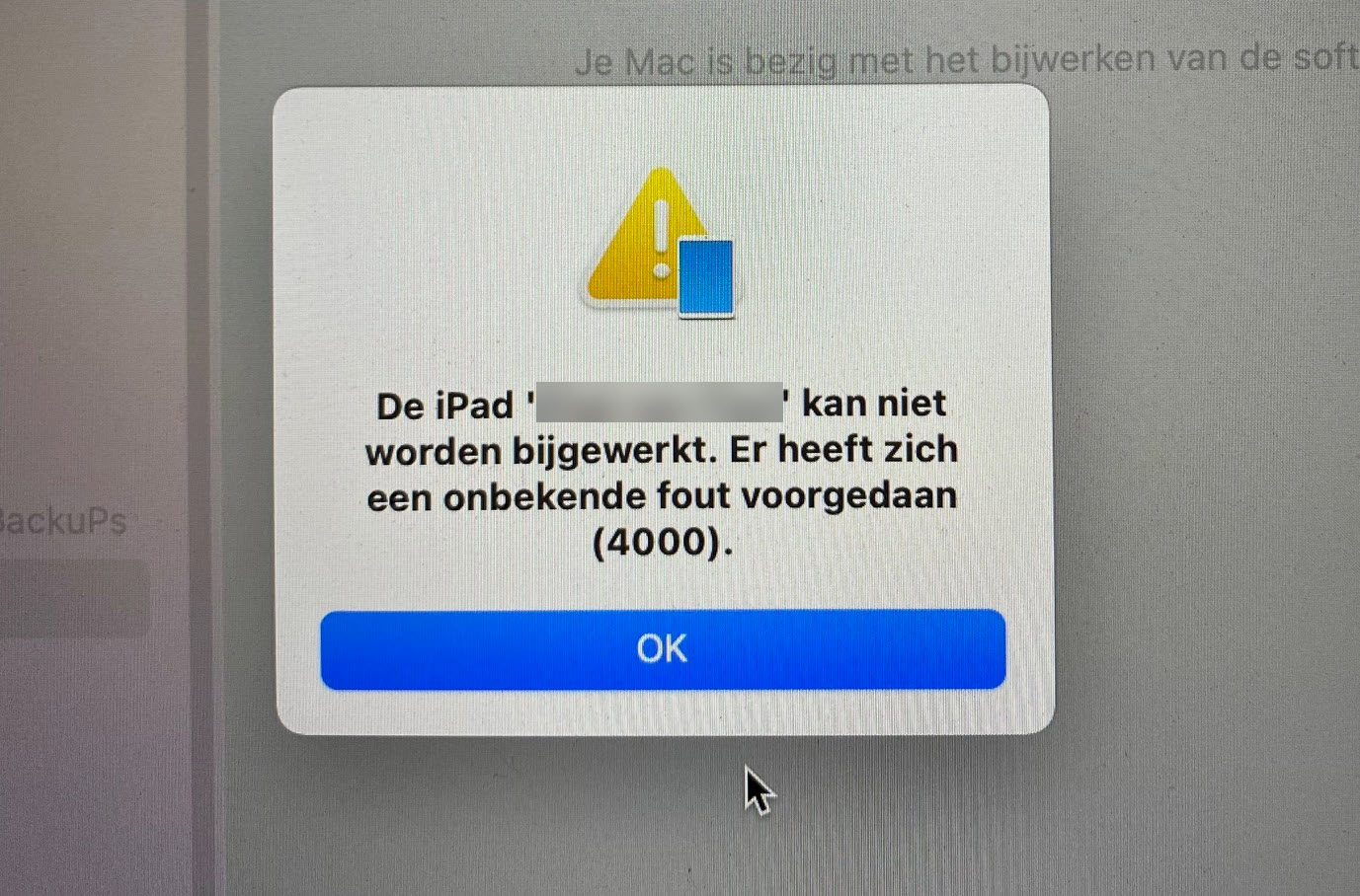

THE SOLUTION

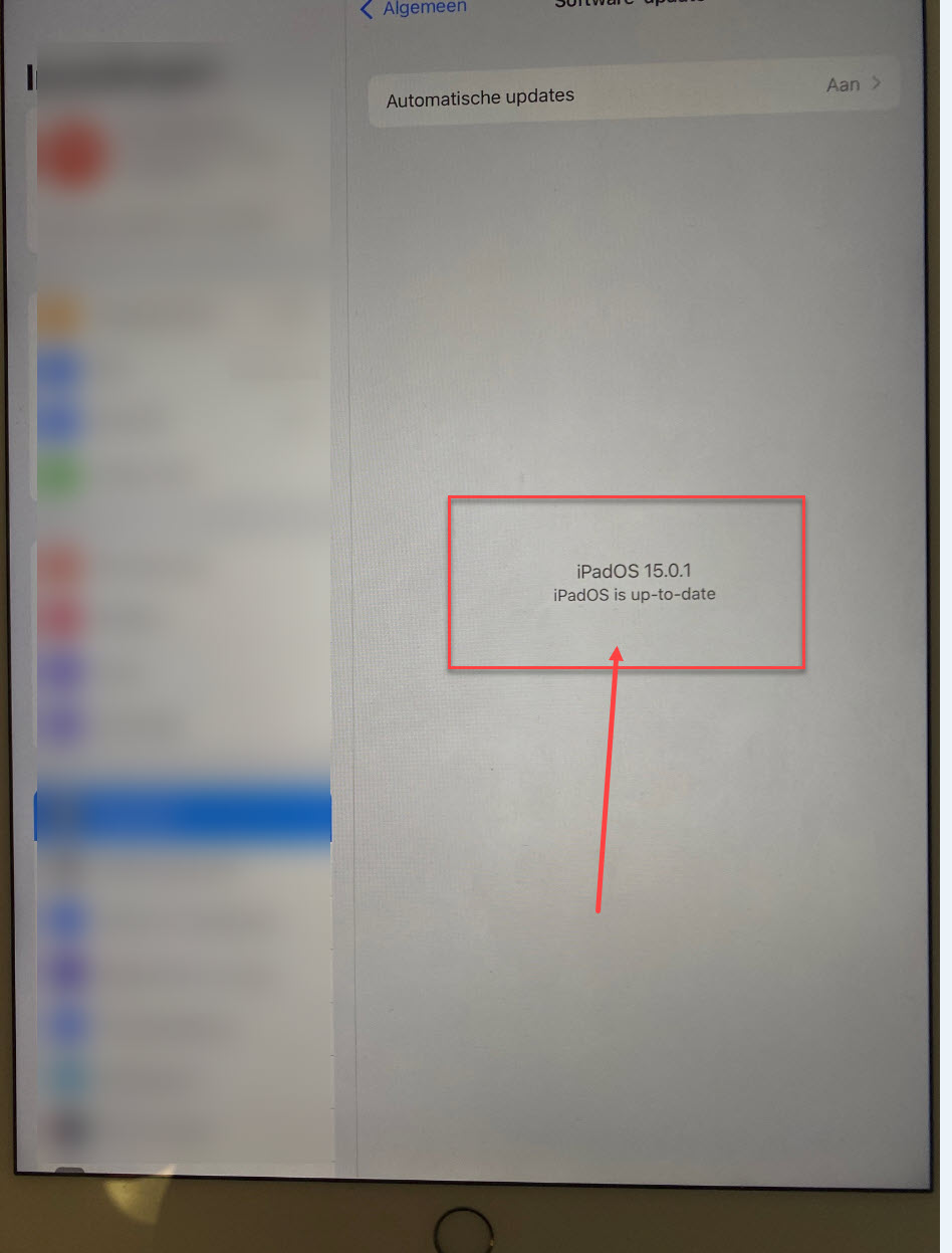

THE SOLUTION
