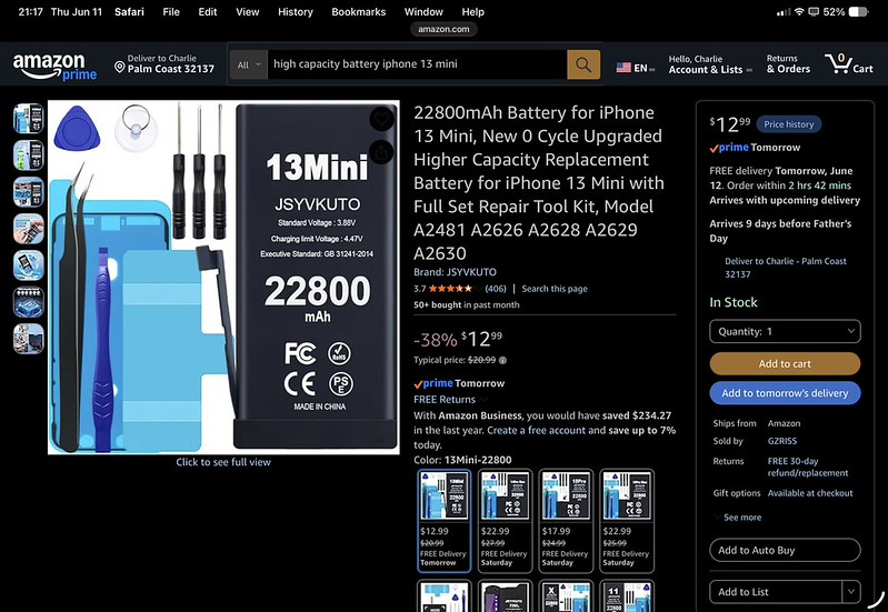

ok, I'm all for DIY as I do anything on my cars DIY but those batteries are fake as hell and there's nothing top stop those small chinese sellers from stating over inflated battery capacity claims.

I have a 13 mini I recently had Apple replace the battery in it and another where I installed that high capacity diagnostic compatible battery in. I’m comparing both over long term to see how well the aftermarket SUNWODA battery will perform over time by collecting actual data between both devices. Only time will tell but for now the 13 mini with the aftermarket battery has been performing very well.
I’m posting this based on what I am seeing over time. I do agree some are simply over rated crap made in China being sold. There’s no way you can have a 15,000 mAh battery, or 22,800 mAh battery in this example below, inside a 13 mini.
Here is an example of one of those fake batteries being sold for the 13 mini I found for sale on Amazon.

The battery I had Apple perform my battery replacement service on last December, my Pink 512GB 13 mini, is a SUNWODA 2443 mAh battery. A genuine Apple replacement battery which provided my 13 mini with 102% battery health over the 2392 mAh design capacity for this device.
The battery I purchased is a more realistic 2654 mAh SUNWODA battery. Same battery manufacturer as the genuine Apple battery providing 110% battery health which, to me, is more believable than that 22,800 mAh battery example I posted above. Also since I am doing my battery service, I know the work being done to my device and how that work is being performed every step of this process including the parts used.
