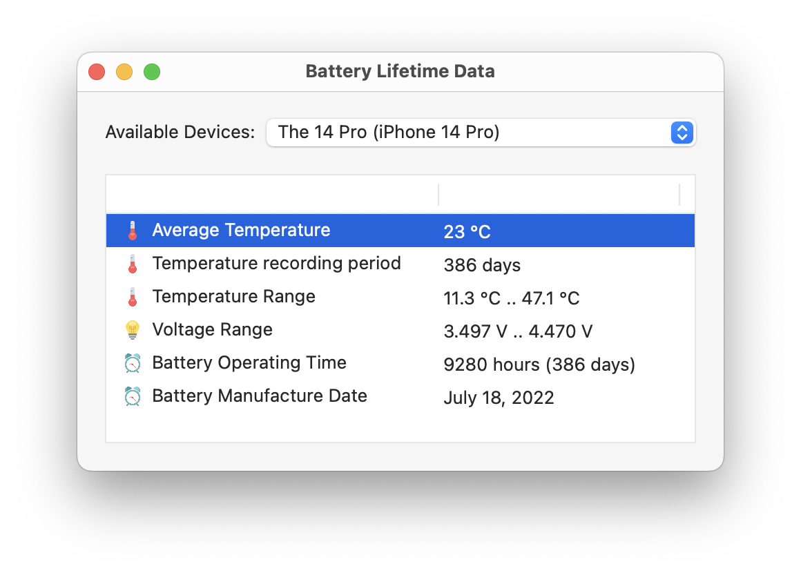

iPhone 14 Pro, launch day unit.
coconutBattery shows 100% however iPhone shows 99% of maximum capacity.
Cycle Count:223
Mixed of contactless charging (MagSafe charger, MagSafe Duo, Lab22 charging stand), external battery pack, CarPlay, and Lighting cable; pair with Apple 20W or dual 35W power adapter. I have a case on too.
