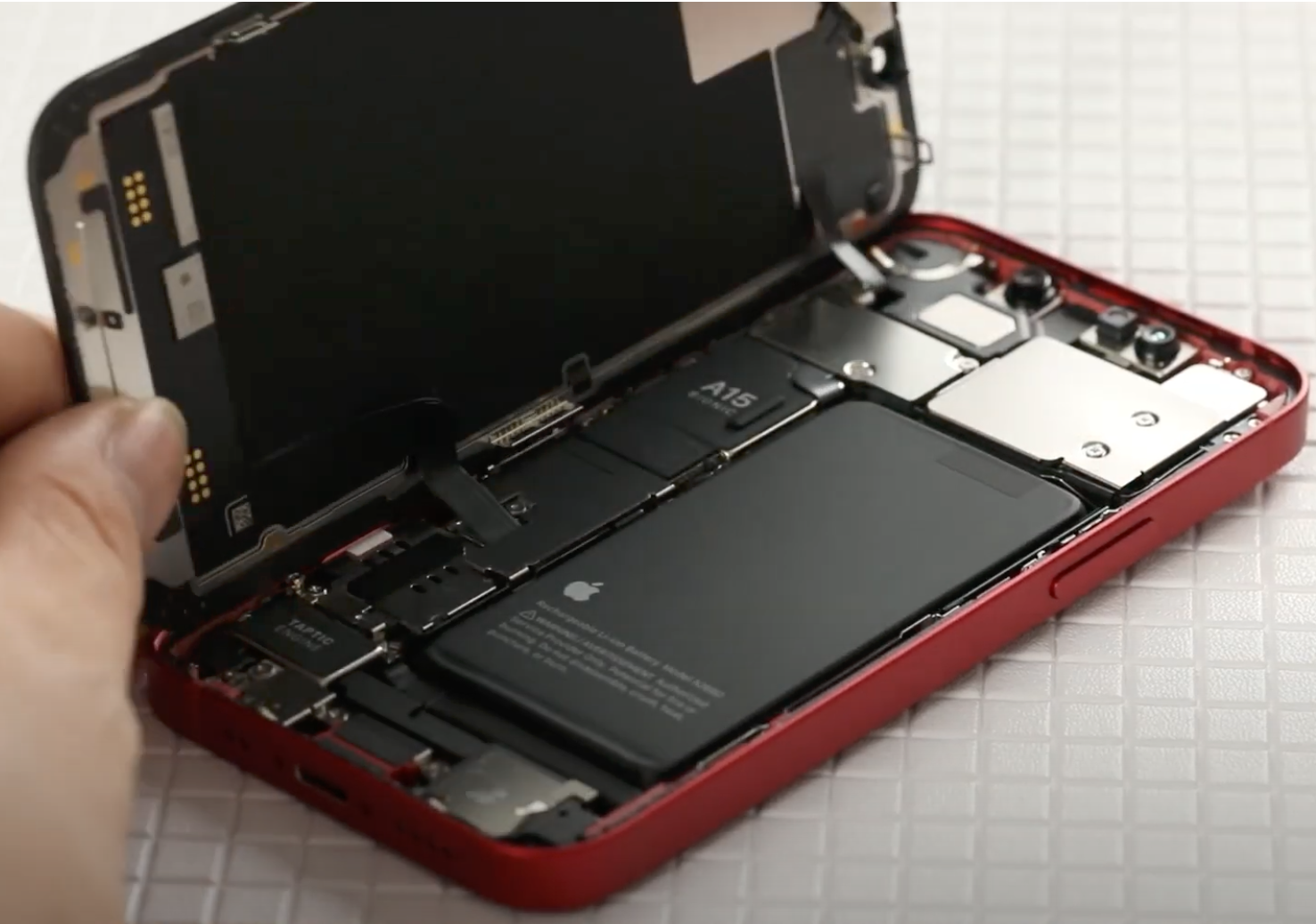

1) Let's do a back-of-the-envelope calculation. Based on the photo below, I'd estimate the 13 Mini's battery to have a surface of about 75 mm x 40 mm (by comparison with the length of the phone). And since the Mini's exterior thickness is 7.65 mm, let's estimate the battery's thickness as 6 mm. This gives a volume of about 75 mm x 40 mm x 6 mm =18,000 mm^3.
The exterior height x width of the case is 131.5 mm x 64.2 mm. So if we increase the thickness by 1 mm, and use (as I proposed) the extra volume for a larger battery (which Apple could do, and is certainly capable of doing, by rearranging things, redesigning the aspect ratios of the other components so they are thicker but have a smaller surface area, enabling the battery to have a greater surface area), that gives an extra volume of about 130 mm x 63 mm (subtracting from the exterior dimensions for case thickness) x 1 mm = 8,000 mm^3, for a total of about 18,000 mm^3 + 8,000 mm^3 = 26,000 mm^3. That gives a 26,000/18,000 = 1.44 ⟹ ≈ 40% increase in battery volume.
You can quibble about the details, including the extent to which Apple could rearrange components. But that misses the point of this type of calculation, which is a very effective way to get a ballpark estimate. Besides, it doesn't need to be 1 mm thicker exactly--it could be, say 1.3 mm thicker.

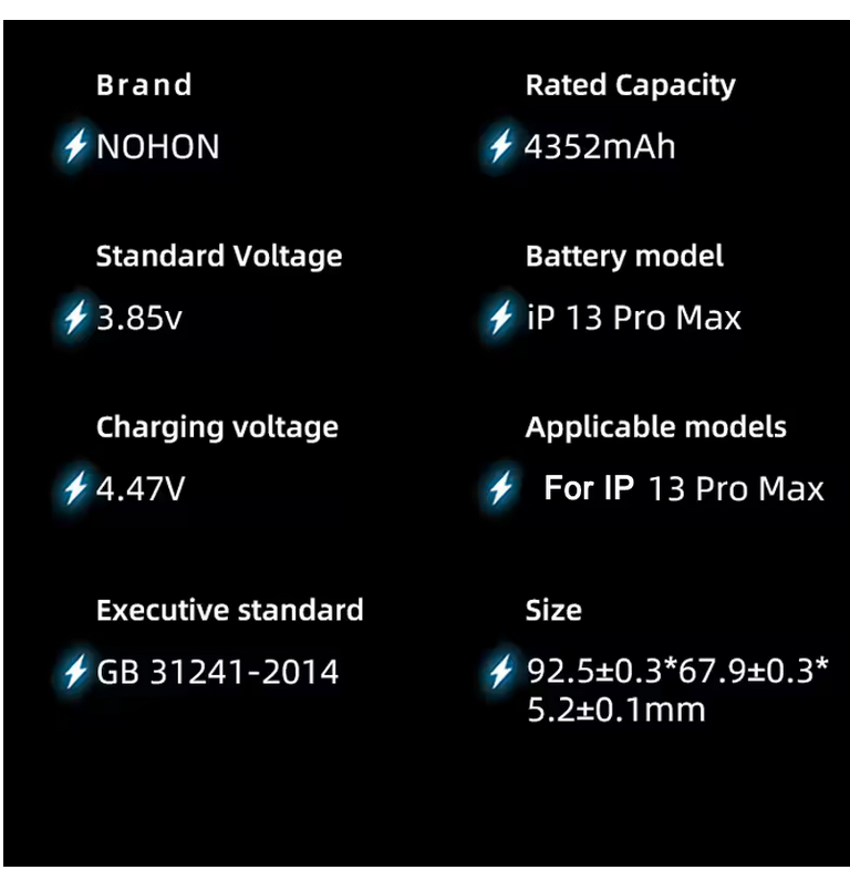

EDIT: Alternate calculation: On https://www.aliexpress.com/i/3256805014678999.html?gatewayAdapt=4itemAdapt, I found these dimensions for the iPhone 13 Pro Max battery: 92.5 mm x 67.9 mm x 5.2 mm = 32,660 mm^3. Since it's from the same generation, if we assume capacity is proportional to volume, then we can estimate the 13 Mini's battery volume as 32,660 mm^3 x 2,340 mAH/4,352 mAH ≈17,600 mm^3, which is surprising close to my estimate above.
