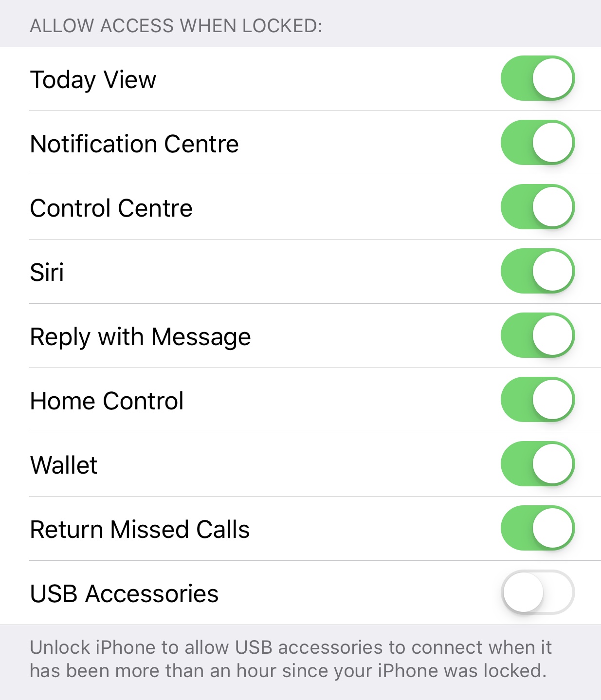

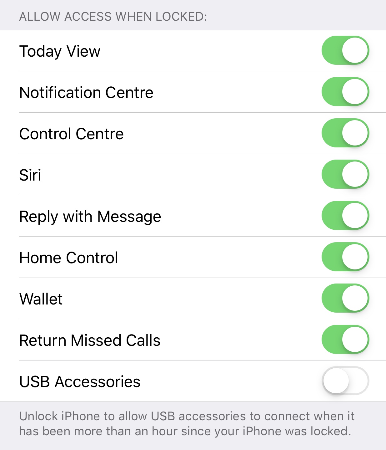

Sigh. Turn off USB Accessories. Go to settings>face ID and Password>USB Accessories. Turn it off, reboot, problem gone.

I don't even know what you are trying to say. Turning OFF usb accessories in settings>Face ID and password is what turns this feature off. You may need to then reboot the phone. Thanks for the attempt at being clever though.
Regardless of the USB Accessories choice on my phones, the problem persists. I can still do data transfer, I did a complete iTunes backup, and the phone never started charging.
Not trying to be clever. Turning the toggle off enables data access and I’m sorry for being confusing. However toggle on, toggle off, phone restarted etc nothing made it work consistently. 12.1 fixes completely which is a dream. Weirdly the other fix was using a fast charger, which apple support recommended - either wireless charger or a fast charger fixed the issue before the beta. Screenshot attached to explain the toggle on confusion. It seems illogical; but turning the toggle off turns data transfer on.
