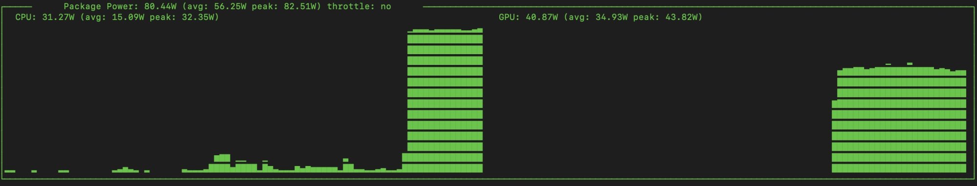

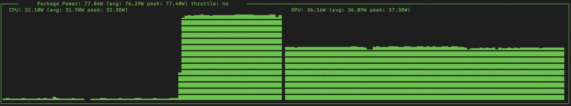

There is no question that Apple Silicon is much more efficient than any other currently available hardware. But this doesn't mean that it's incapable of high power operation. I can easily make it run at 80W without even trying by starting
an ALU-heavy GPU kernel as well as some intensive work on all cores, see below. I could probably push it further by also adding some memory bandwidth heavy stuff to the GPU (that would be additional 5-10W for the main RAM) as well as loading up the AMX units.
The new chassis has no problem whatsoever with this kind of load. It can run this 80 watts workloads pretty much indefinitely, and the fans stay quiet for a while. Even after several minutes they are still way below their max RPM.
In contrast, with the 2019 16" chassis you would start observing CPU throttling if you tried to push the CPU+GPU over 70 watts and the machine would immediately get very loud (in Cpu only operation, the 2019 chassis can run the CPU at 60W sustained, in CPU+GPU it quickly drops the limit down to 30W or less). All this despite the 2019 hardware capable of much higher peak power consumption. This suggests that the 2019 chassis struggles with these higher power operation while for the new chassis it's a breeze.
P.S. Regarding power efficiency — the M1 Max summary CPU+GPU compute throughput is at least 2-3 higher than the 2019 Intel model at the same power consumption. So this does not in any way contests your statement about higher efficiency of Apple hardware.

I am comparing the actual power usage of these systems. The Apple Silicon system is capable of using more total power without throttling in the new chassis than the (less efficient) Intel system in the 2019 chassis. These are facts. Thich suggest that the new chassis is better for power dissipation than the 2019 chassis.
