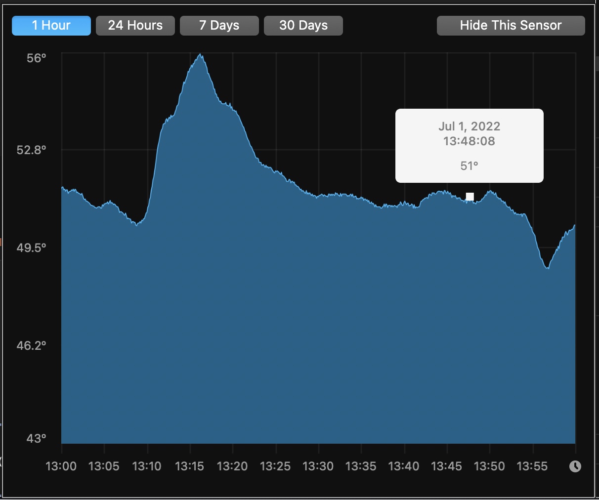

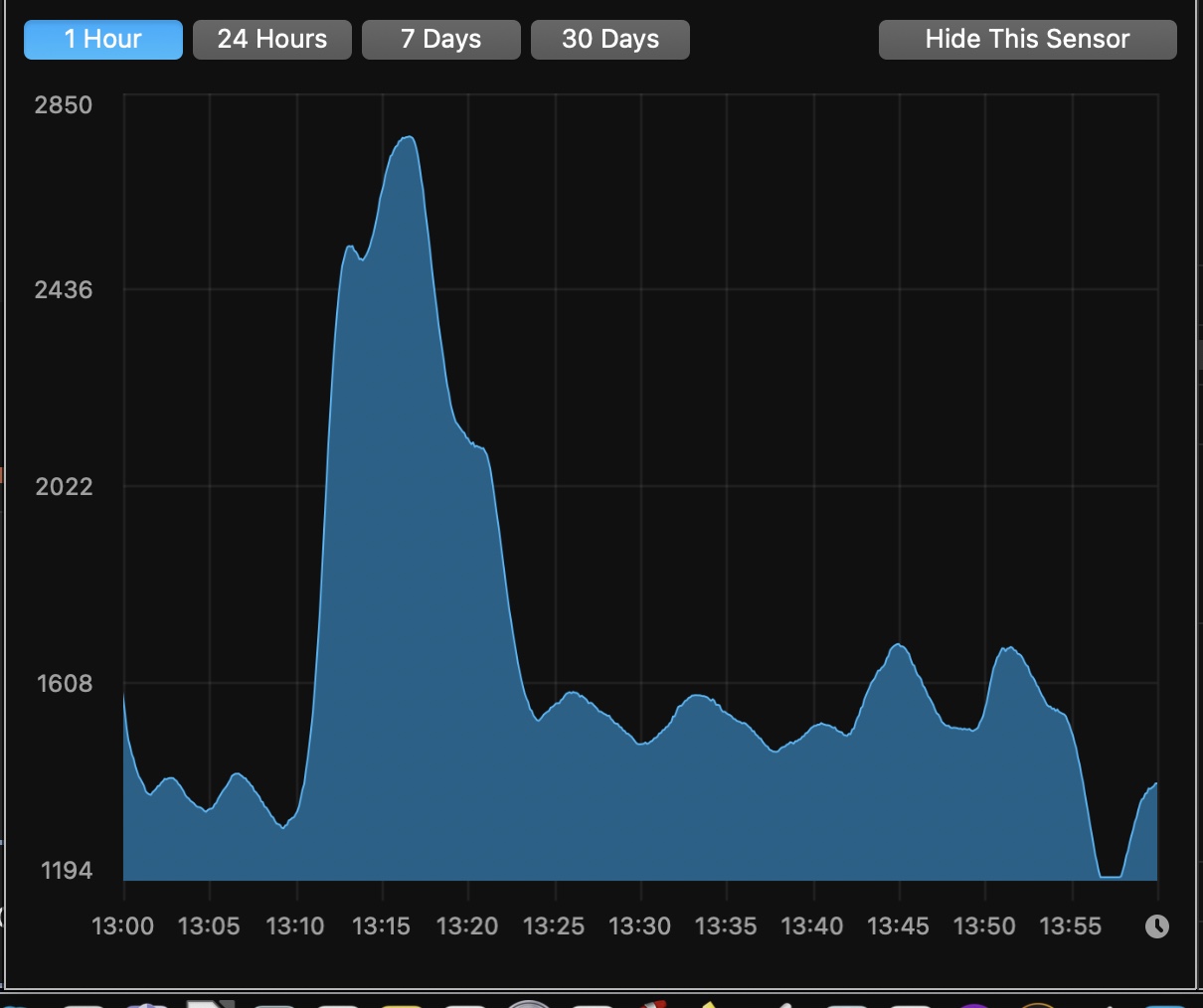

It was suggested that excessive heat might be causing RAM failures or otherwise account for the panics. I decided to use a few tools to check this.
As mentioned above, I installed Macs Fan Control. I also have iStat Menus which can display a history of things like RAM temperature and fan speed.
I also ran this command and directed the output to a file:
Code:
sudo powermetrics --samplers thermal
Some results:
The powermetrics command shown above returns the thermal pressure level of the machine. Apple's documentation of this is contradictory, but the "normal" level is called Nominal. The level above that is referred to as either Fair or Moderate. Levels of higher thermal pressure are Heavy and worse.
I ran this continuously from about 10:30 this morning until 2:00 this afternoon. At no time did the pressure level go higher than Moderate: 1439 Nominal readings and 1261 Moderate readings. In other words, the temperate pressure never reached critical levels even though the ambient temperate in my computer room is now 34.4ºC (94ºF)
Here are some charts from iStat Menus showing the fan speed and RAM proximity temperature for the hour from 2:00 to 3:00, the hottest hour of the day.
FAN SPEED
RAM (Memory) Proximity.
I have no idea what was going on when both the temperature and fan speed peaked. I was in a very hot kitchen preparing Burmese pork curry. But, even at that time the thermal pressure was reported as Moderate.
My impression here is that the machine is operating normally and even on a very hot day the RAM temperature and fan speed are at acceptable levels and not likely to shut the machine down.

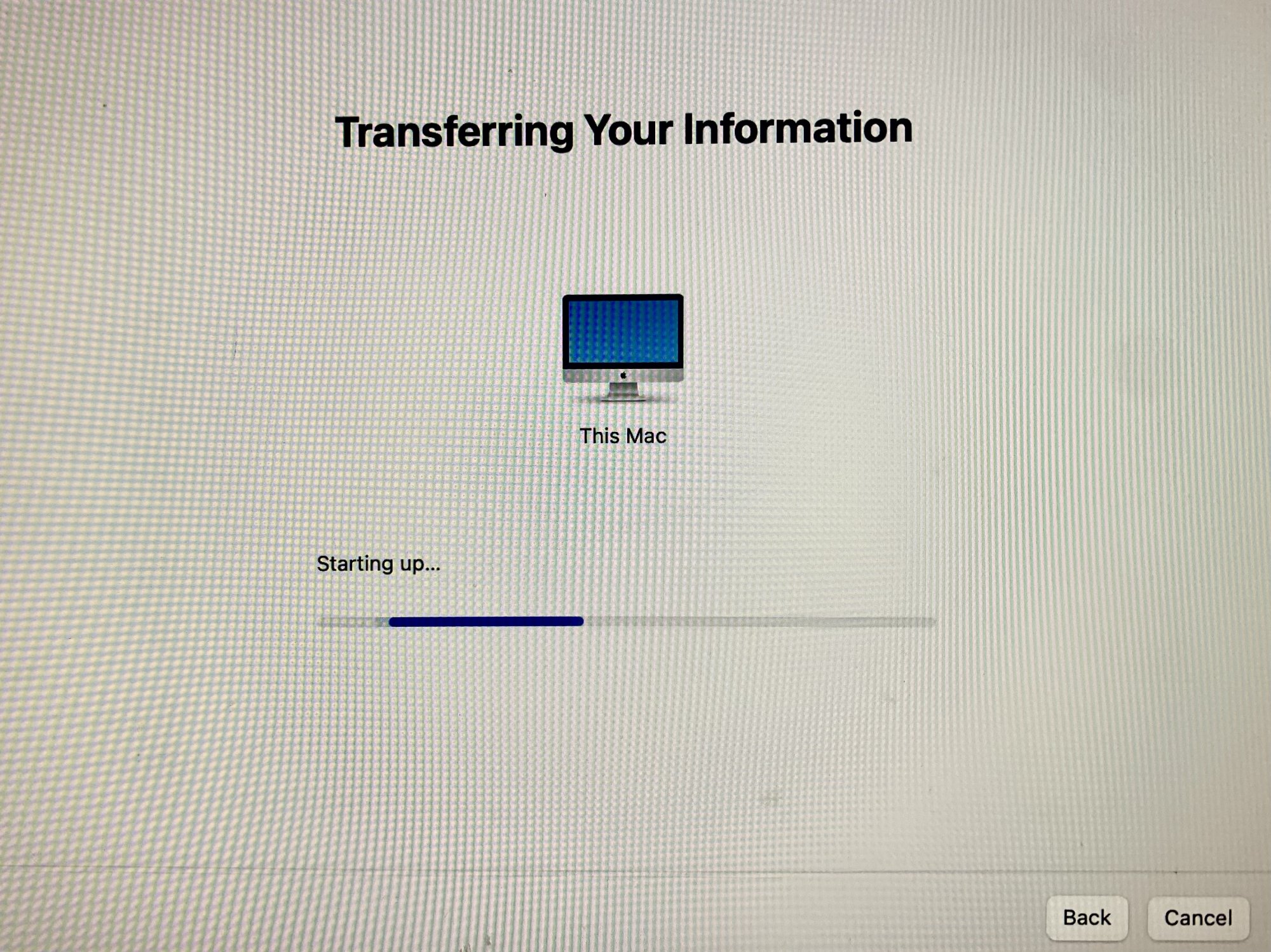

The machine rebooted and I was asked, again, all the questions about region, language, keyboard, etc. Why twice for all those?
From there it went here:
Where I’ve been stuck for four hours.
Does it really take that long, or should I abort?
Are you on wifi or ethernet? wifi might take awhile, depending on your connection speeds and amount of data. ethernet takes a couple of hours.

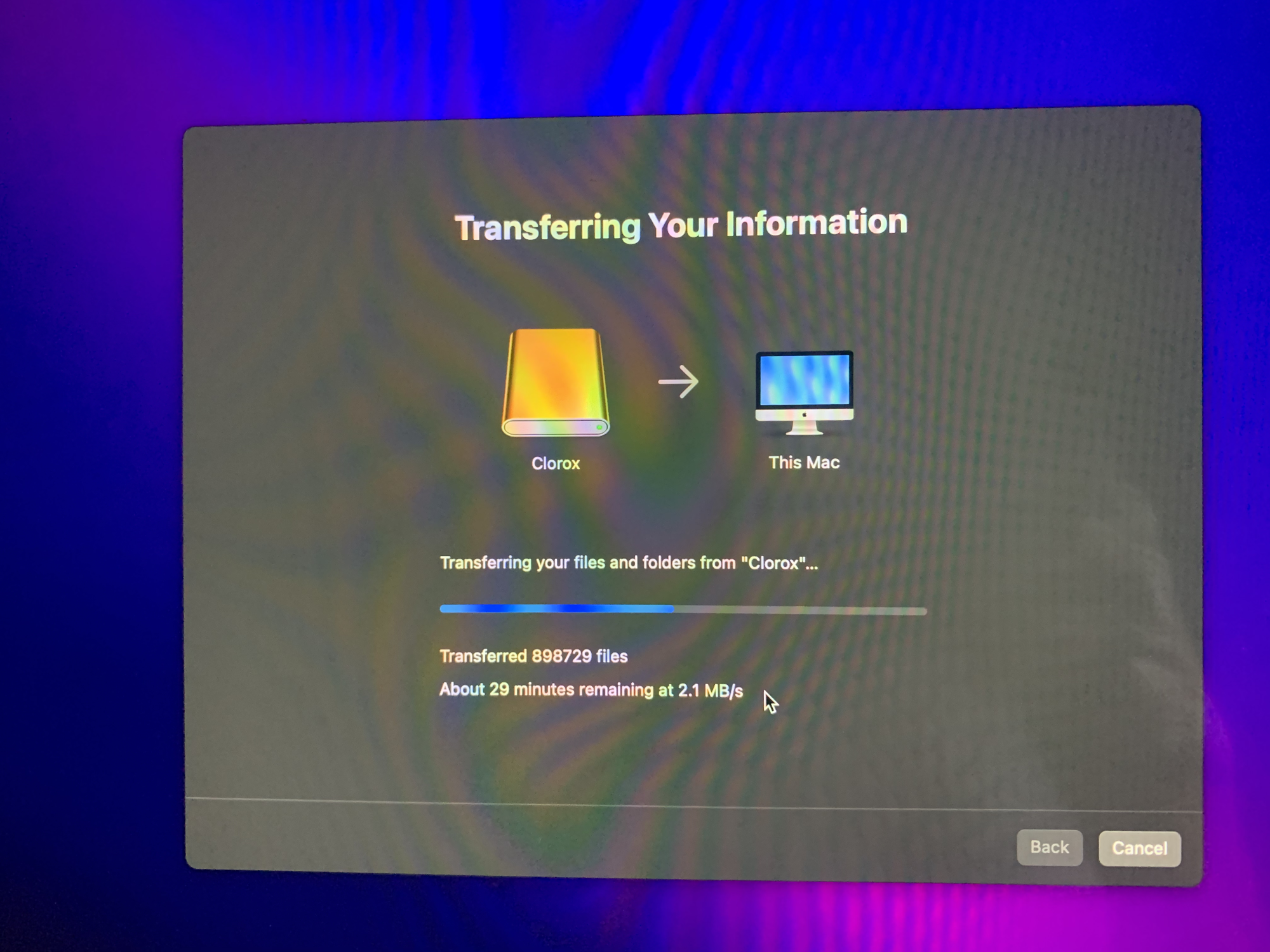

I think the time it takes will depend on how much data you are transferring. I have an older macbook pro and it is really slow transferring info from an external. I'd give it a few more hours to see if there is any progress. I've personally never trusted migration assistant which is why I recommended the manual move of your files/data. My fear is that migration assistant would transfer the same problem/issue that was originally causing the panic. Here is an article that might help if it appears to be stuck https://mactakeawaydata.com/migration-assistant-stuck/
After seven hours I decided nothing was happening, so I cancelled the process. The machine rebooted. The previous ordinary users were created, but nothing at all had been migrated. When I logged in I was faced with an empty desktop, a non-functional dock and no menubar. Clicking icons in the dock did nothing. So, I used the power button to reboot. This time I got a functioning UI, but it was very clearly that nothing had been migrated: no apps, no data. So, I opened Migration Assistant and tried again. This time I got a proper migration progress window:
This time the projected time was reasonable considering I was migrating from an SSD attached to the Mac (no WiFi or Ethernet involved). I went to sleep before the migration was finished.
When I got up this morning it was done. I had to jump through a bunch of hoops enabling various apps to do this and that via System Preferences. And, just as I was finishing that up
