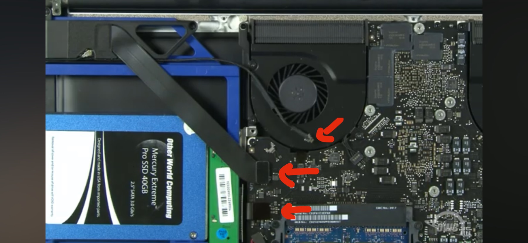

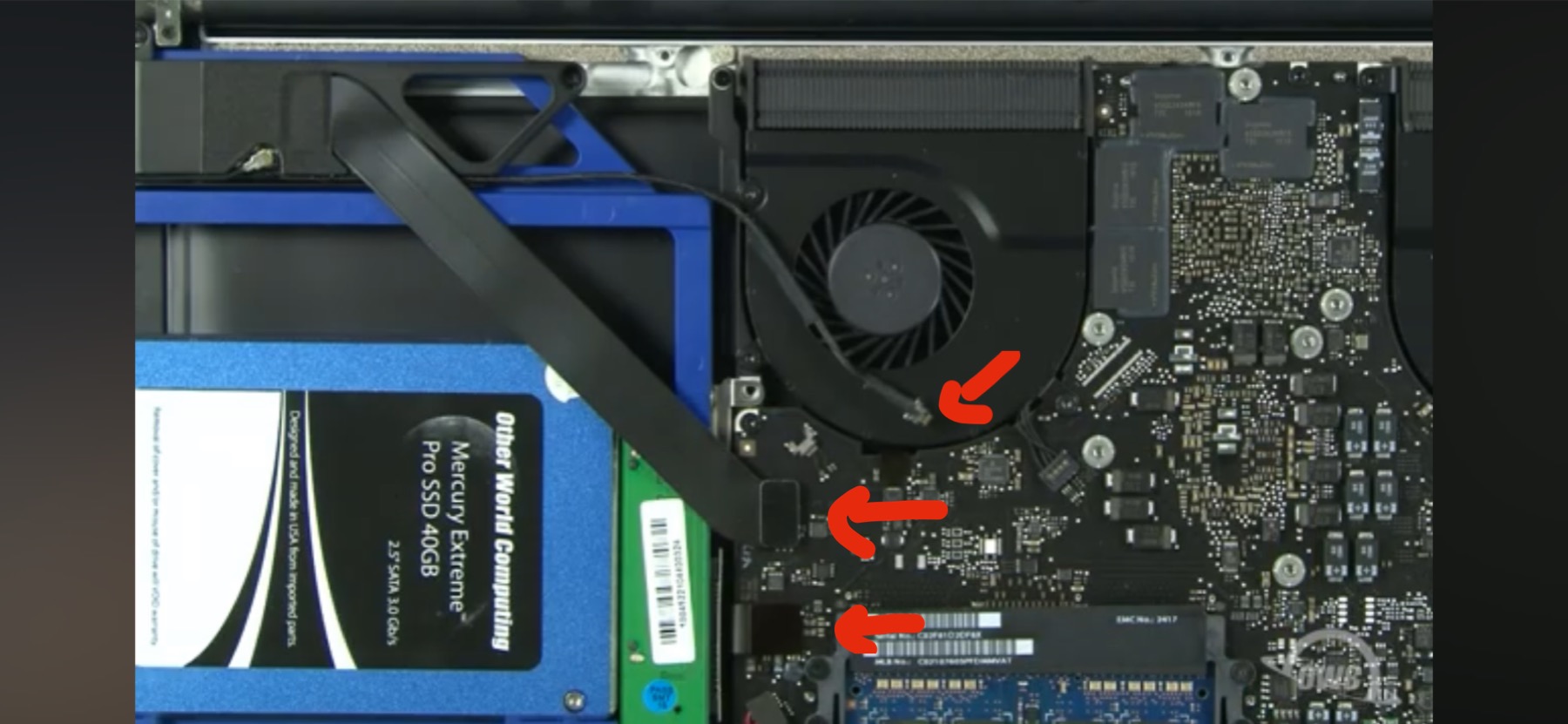

Oh, if that's the drive in place of DVD, check if it is seated properly in the frame and also check the small cable/connector. The bottom one in your picture. From my experience they are very loose fit.

The optical drive cable is the bottom cable labled in your picture.
Top arrow points to the camera connector, which, in that picture, is disconnected. Is there a reason for that?
You COULD just disconnect that secondary SSD, then check again if that drive is an issue (check if you don't get the slowdowns, etc.)
You would just want to find a replacement superdrive, I suppose. (Would you actually have any use for an optical drive now?)
But, that internal (extra) SSD is a tiny drive, only 40GB. You COULD replace that with a Crucial MX500, or Samsung would also be a good choice, either of those are available with up to 4TB. But, certainly 1 or 2TB would be a great addition to that laptop.
Is the boot drive also another OWC 40GB? It's likely more than 10 years old, and might be a good plan to consider replacing THAT, too. Those small capacity SSDs just don't exist now, as SSDs over the years have dropped significantly in price.
That's not the OP's machine. The picture is by OWC. See the watermark in lower right corner?
OK, missed that watermark.
but, OP also said "This drive is installed in the drive bay." - so, I assumed that was (OP's) drive, or one just like it.
Yes it is a screenshot from OWC for replacing drives in the secondary bay. Was just using it as reference 🙂

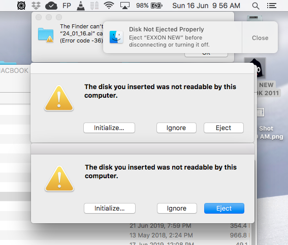

The drive showed up for a bit. Opening folders was slow and directories took awhile to appear.
And then all of a sudden it would eject itself.

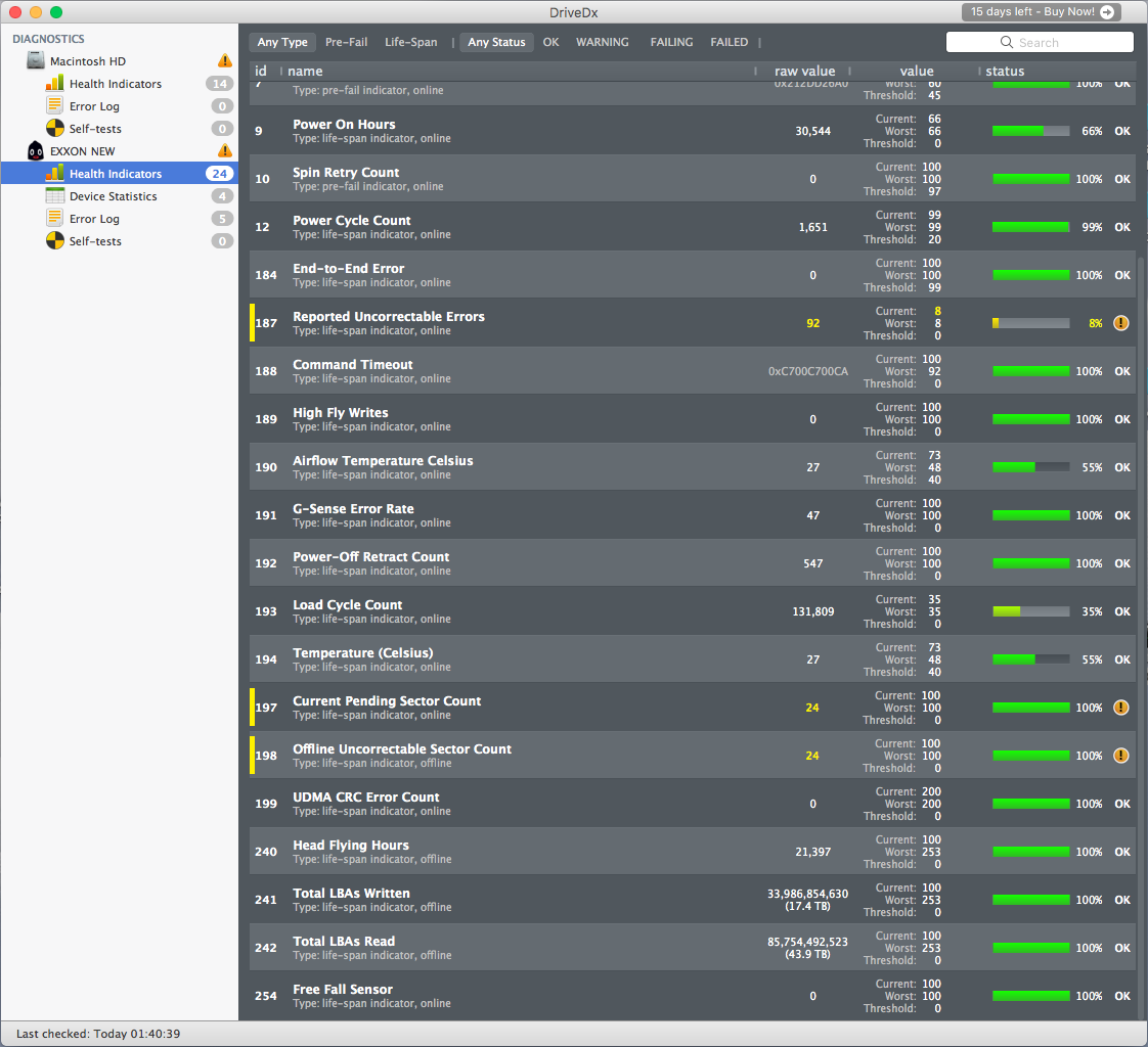

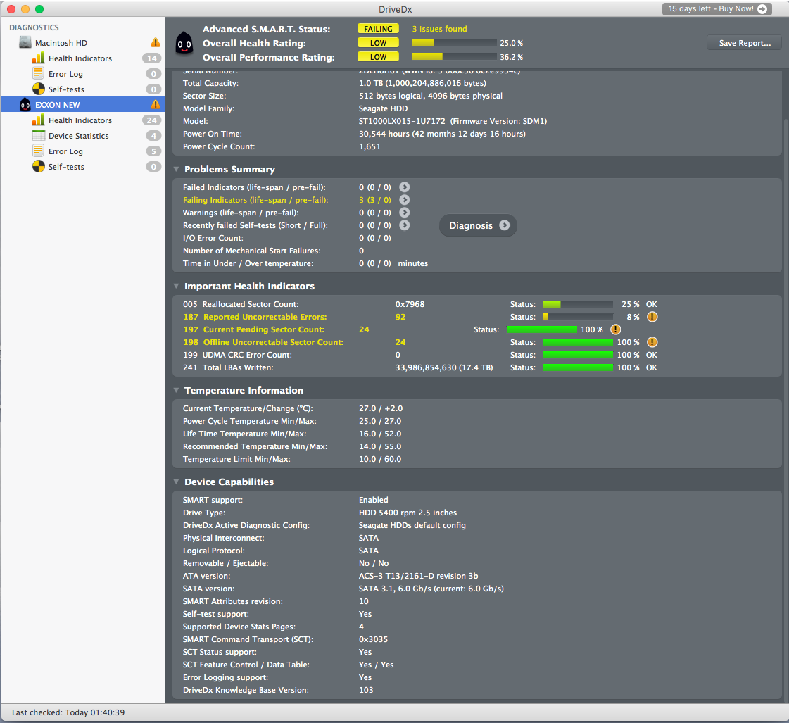

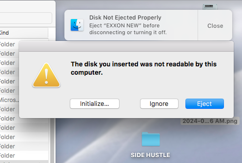

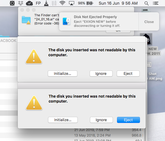

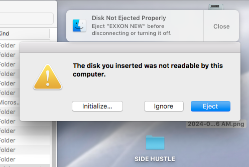

Turns out the problem is with the drive. I finally got a SATA/usb cable and hooked the drive up and had the same symptoms. It turns up for awhile it and then it will auto eject.
Also managed to diagnose with drive dx. Most of the info is over my head honestly, but am assuming the errors are not good news. I just want to save my data at this point but I can’t even copy files over before the disk ejects itself. 😞

Yeah, those errors are definitely bad news. I mean, for SMART to report your drive's status as "Failing" is pretty much all you need to know...
Dare I ask, do you have the data on the drive backed up?

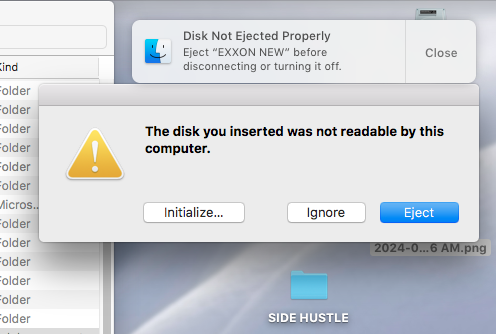

Have been trying to connect the drive but now it can’t even load it.. is it a total goner?

You're going to want to use ddrescue, and avoid mounting the disk. Apparently using linux provides most success.
Hey thanks, took a look at ddrescue. Unfortunately working in Linux is a bit above my head. 😓
