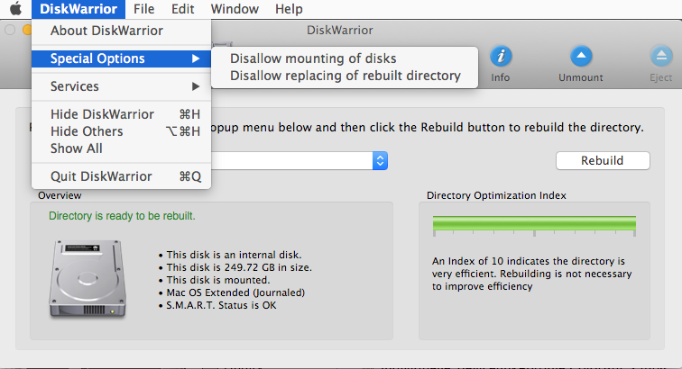

neat, didn't realize that diskwarrior could also do that. I don't know whether DiskWarrior will go back at the end and actively try to reread failing data.
Actually @ojfd could you provide instructions on how to use diskwarrior in this mode? I don't see any obvious option to both prevent mounting as well as tell it to attempt to read all the data.

When DiskWarrior encounters damaged drive, it first tries to recover directories, without touching anything on a disk. Then it gives the option to recover files. Those that can't be recovered will be mentioned in the log. It also slows down, when there is a problem reading from the drive. There's more info on their website.
As to the preventing mounting of the drive and making image of it - I touched it briefly here:
How exactly does it do this though? There's pretty much only one mode, the "rebuild" button. My understanding is that diskwarrior first and foremost is a tool to fix hfs issues, so would it start trying to do its rebuild and on read-issues switch to trying to _only_ discover valid files/directories? And as I recall diskwarrior does not actually give you a chance to copy over discovered files until the process is complete. Which means to actually copy over a file would require two reads (one during the discover phase for the catalog metadata, another during the actual copy to access the extends).
This seems really sketchy to me, and a blind block-level copy like ddrescue seems like the far better option. Once you've done your block level copy then you can mount it and try to have diskwarrior piece together anything that it can salvage.
DiskWarrior still cannot rebuild (and won't scan) an APFS volume. You would be wasting your time, if that's what you have.
@f54da , instead of me telling you how DW works, take a look at its manual. Starting from page 47.
And yes, maybe ddrescue is a better option, but that is Linux which is not everybody's cup of tea. I suggest disk imaging on a Mac using iBored that I mentioned in the other thread.
@DeltaMac - yes, if the OP's disk was APFS then he's doomed. On the other hand, I think, he mentioned that the disk in question was used for files only, so maybe it was HFS+..

@ojfd I'm well aware of how it works, and it does not negate anything I stated. Particularly the fact that diskwarrior operates in a filesystem aware fashion as opposed to direct block level copying that ddrescue does. As a result, it can end up issuing orders of magnitude more read commands than a direct block-level copy would do. Their recommendation to use diskWarrior when the HDD has hardware issues is rather careless and dangerous.
Which is why standard practice is to always attempt a block-level copy, then mount the result image and use filesystem aware tools.
That's a valid point.
Instead of going Linux, you might try DiskWarrior. Leave the defective drive inside the MBP on a SATA bus for faster recovery and boot off of external drive. That's what I did when I had dying Crucial SSD.
DiskWarrior has the option to prevent mounting the drives, btw.
