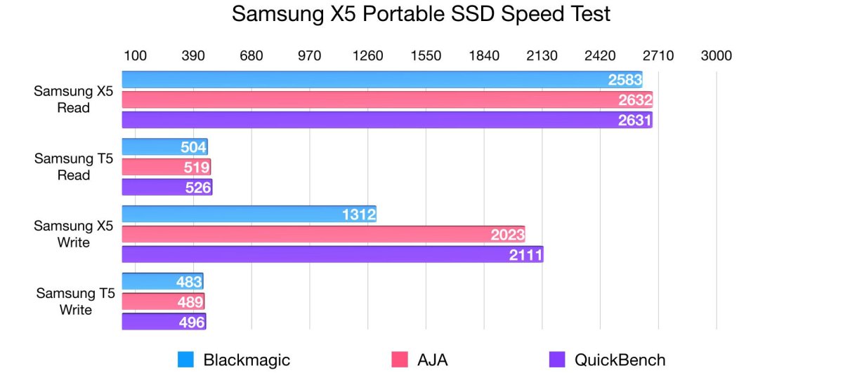

Samsung X5
https://www.samsung.com/semiconductor/minisite/ssd/product/portable/x5/
G-technology G-Drive mobile Pro SSD
https://www.g-technology.com/products/portable/g-drive-mobile-pro-ssd#0G10311
OWC Envoy Pro EX (VE)
https://eshop.macsales.com/shop/owc-envoy-pro-ex-ve/thunderbolt-3
All with NVMe SSD and bus powered.
I too considered Akitio Node Lite with Samsung or WD NVMe, but this set up requires external power brick, not portable, and fan noise.
G-Drive comes with 5 year warranty but other two come with 3 year warranty. All with NVMe up to 2800 MB/s speed. Only down side of these portable units are some thermal throttling with HUGH transfer. G-Drive dropped the price from $999 for 1 TB to $699 to match Samsung X5's $699 price.
Reactions: wardie and scstraus

On a 2017 5k iMac. Could you use NVMe to get the same speeds? And if not how big of a difference would it be? I am not willing to pay Apple's exorbitant prices on SSD but may want to upgrade to this in the future if it is in fact an upgrade over using a Fusion drive.
Samsung X5 - a bit pricey though
