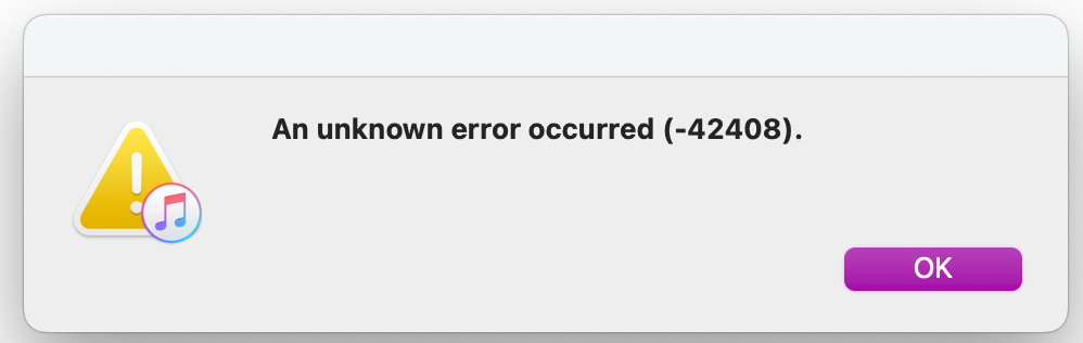

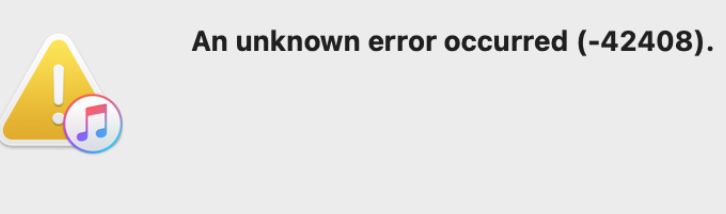

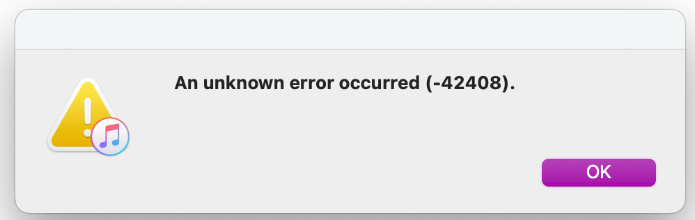

I get this alert when iTunes first launches:
But... it can be dismissed, and then things seem to work as they should.
Thanks!
Same followed by another.

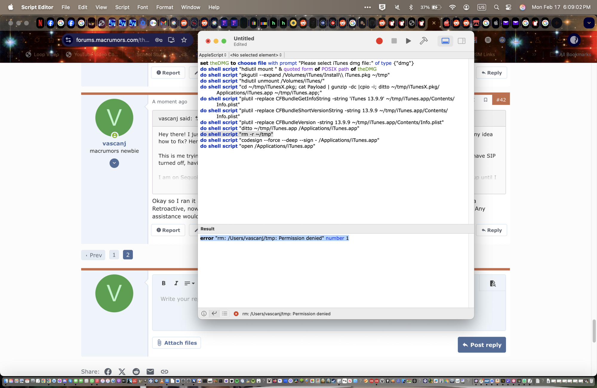

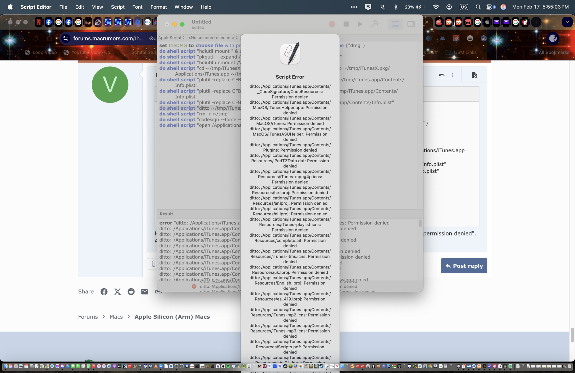

Hey there! I just tried using your script and I get a ton of errors, mostly a whole list of things with "permission denied". Any idea how to fix? Here's a screenshot.
This is me trying to install iTunes 12.8.3. Is there any sort of permissions in System Preferences that I need to enable? I have SIP turned off, having previously used iTunes through Retroactive (but that doesn't work on Sequoia anymore).
I am on Sequoia 15.3 (so the latest) and trying to install 12.8.3. Previously, I had 12.9.5.5 installed via Retroactive, and up until I updated to 15.3, it was working, but this morning when I tried to launch it it gave me a CODESIGNING 1 Taskgated Invalid Signature error upon the crash and now the icon just bounces once and doesn't open at all. Any help would be greatly appreciated! Mulțumesc mult Bogdan!
Reactions: bogdanw
Okay so I ran it again having deleted the version of iTunes that I had in my Applications folder that was installed via Retroactive, now it's just saying error: permission denied but just for the tmp folder it's making in my Users folder. Any assistance would be greatly appreciated, thank you!
Okay so I put the tmp folder in the trash and then I changed the permissions of the user folder to be read+write for everyone not just me, and it installed perfectly! Thank you for this script, you're a lifesaver!
SO TL;DR: Confirmed this script works on OSx Sequoia 15.3 installing iTunes 12.8.3. But you need to change the permissions of your user folder to be read+write for everyone during install, then you can change it back I'm assuming. Cheers!
I used the script for 12.8.3 with no issues and I didn't need to change any permissions nor disable SIP and I'm also running 15.3. It sounds like you're not an admin for your user account or your previous installation left some files behind that caused your problem.
For anyone else encountering the ditto error: Retroactive asks for your/admin password to install iTunes, the script does not. As a result, the script can not overwrite the iTunes app created by Retroactive.
But at that point in the script, the new iTunes version is already created in ~/tmp/, so all you have to do is move it into /Applications.
If the script fails before deleting the ~/tmp folder ("rm -r ~/tmp"), before running the script a second time, delete ~/tmp from Finder or Terminal.
