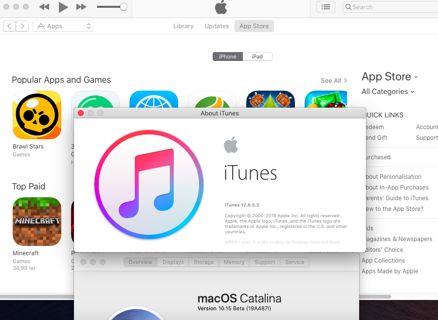

Yes, iTunes 12.6.5.3 is working on MacOS Catalina 10.15 Beta 19A471t
More details soon.

Instructions for getting iTunes 12.6.5.3 to work on MacOS Catalina 10.15
1. Disable System Integrity Protection (Reboot to Recovery, open Terminal, run csrutil disable, reboot)
2. Download iTunes 12.6.5.3 dmg from https://support.apple.com/HT208079 (direct link https://secure-appldnld.apple.com/i...-B085-11E8-B6AB-C1D03409AD2A/iTunes12.6.5.dmg )
3. Use this script to create a package that can be installed on macOS Catalina
Code:
display dialog "Please select iTunes 12.6 dmg file" buttons {"Ok"}
set theDMG to choose file with prompt "Please select iTunes 12.6 dmg file:" of type {"dmg"}
do shell script "hdiutil mount " & quoted form of POSIX path of theDMG
do shell script "pkgutil --expand /Volumes/iTunes/Install\\ iTunes.pkg ~/tmp"
do shell script "sed -i '' 's/18A1/14F2511/g' ~/tmp/Distribution"
do shell script "sed -i '' 's/gt/lt/g' ~/tmp/Distribution"
do shell script "pkgutil --flatten ~/tmp ~/Desktop/iTunes.pkg"
do shell script "hdiutil unmount /Volumes/iTunes/"
do shell script "rm -rf ~/tmp"
set question to display dialog "Install iTtunes?" buttons {"Yes", "No"} default button 1
set answer to button returned of question
if answer is equal to "Yes" then
    do shell script "open ~/Desktop/iTunes.pkg"
    return
end if
if answer is equal to "No" then
    display dialog "Modified iTunes.pkg saved on desktop" buttons {"Ok"}
    return
end if
When the message "This package is incompatible with this version of macOS." is displayed, click on "Install anyway"
4. Use this script to modify iTunes 12.6.5.3 to run on macOS 10.15
Code:
do shell script "sed -i '' 's/12.6.5/13.6.5/g' /Applications/iTunes.app/Contents/Info.plist" with administrator privileges
or run in Terminal
Code:
sudo sed -i '' 's/12.6.5/13.6.5/g' /Applications/iTunes.app/Contents/Info.plist
Notes:
- If iTunes hangs at the first start, force quit, disable Internet and start it again
- System Integrity Protection can be re-enabled: reboot into Recovery, open Terminal, run csrutil enable, reboot

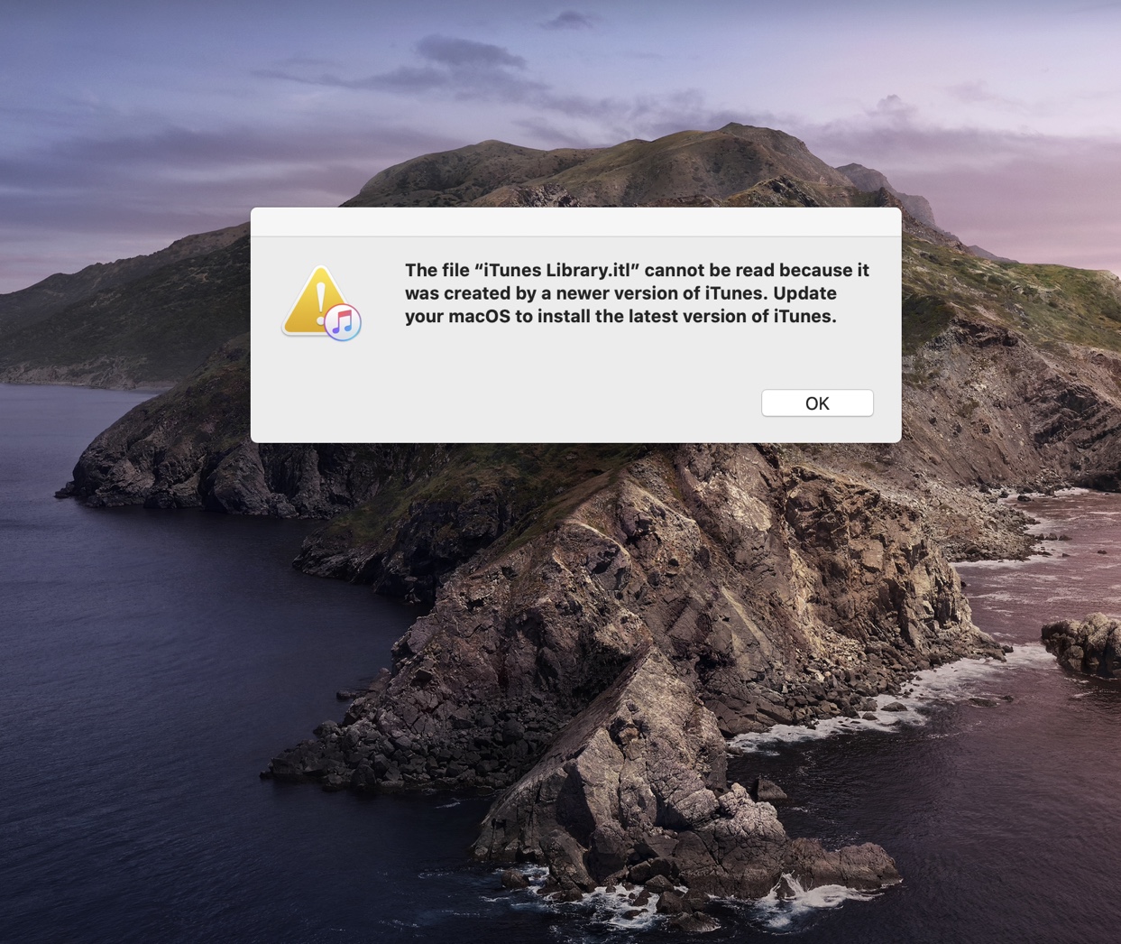

Worked like a charm! Can't thank you enough. Although for me it can't open my old library because this iTunes version is older than the last one on Mojave. I'll search around if there's a way to fix the library too.
For anyone wondering what the script is for, open up 'script editor' (AppleScript) and run it from there.

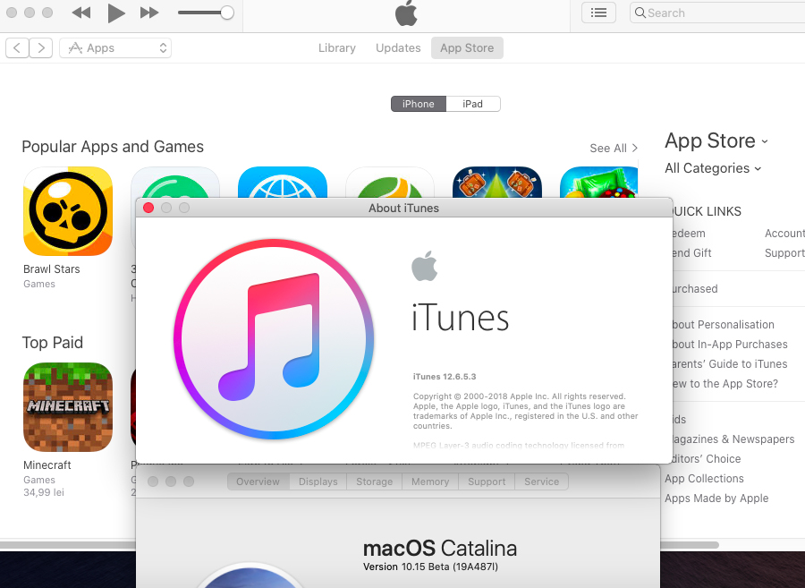

I can now confirm that you bogdanw are a wizard. Very many thanks.
iTunes 12.6.5.3 works like a charm on Catalina.
I’ve tested on a clean install of Catalina on an external usb 3.0 HD running on an Macbook Air from 2014.
After disabling System Integrity Protection I deleted the Books app because I wanted to have iTunes handling my books.
I then ran the script and after iTunes was installed I ran the terminal code.
iTunes started without a problem, didn’t have to force quit or anything.
I have tested drag and drop of files and it work perfectly (I didn’t try syncing because I always transfer manually).
Streaming music to my HomePod and Movies to my AppleTV also works perfectly.

Anything I can do about this message?
Not really the .itl is encrypted or at least not a text-based filetype.
If you had "Share iTunes Library XML with other applications" (At Advanced) turned on in iTunes then you will have a "iTunes Music Library.xml" file in "/Music/iTunes" which is basically a copy of the library but in xml format for other apps to use.
You can import that one to iTunes and things will be like you had it (ratings/metadata/playlists etc..)
File → Library → Import Playlist → Open that XML
If you didn't then try running iTunes on Mojave or whichever macOS version you had prior or on another machine with your older .itl in /Music/iTunes then tick that XML option on should generate it immediately. As long as your music files are in the right place it will work (it won't care if they are available on the other computer.)
