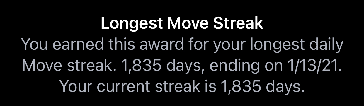

Crossed this one off the list. About 1/2 way through this months challenge. So far so good. Keep it moving folks👍🏻

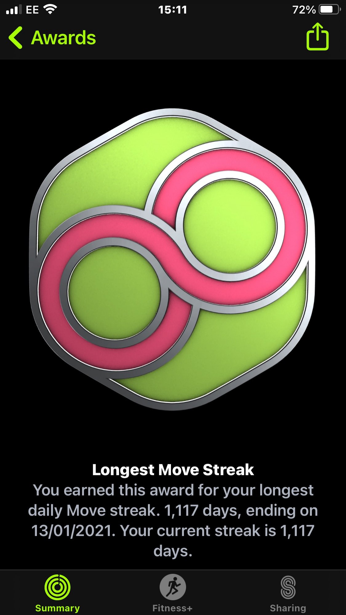

I feel it should be silver if it’s total, gold if it’s consecutive. But either way it’s a nice goal to achieve. Having only got an AW recently I’m years away from this.
