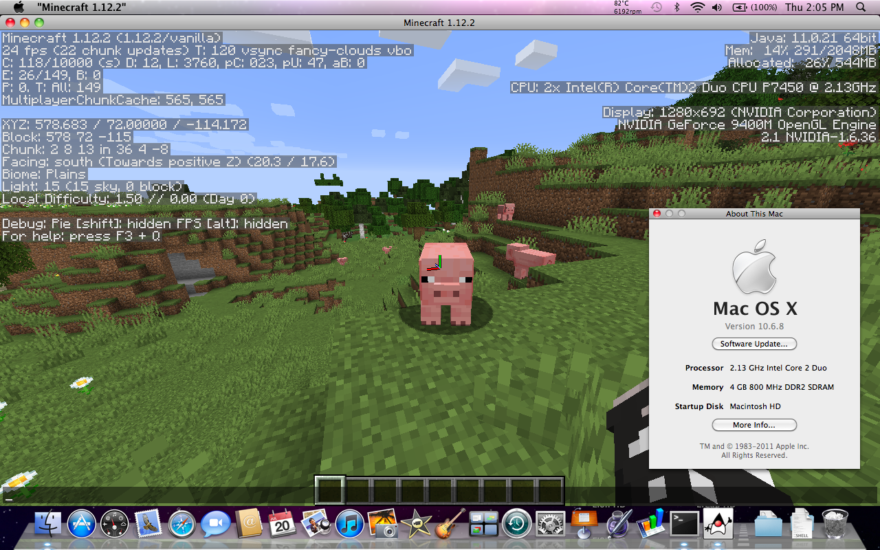

You should be able to run the ATLauncher .jar on 10.6 to play 1.12.2 in online mode. What issues are you running into?
oh the jar launcher? wlep, i was using the app itself instead, now i just tried tha .jar file but it says that it cannot be launched for some reason, in case i'm pulling this hit right here:

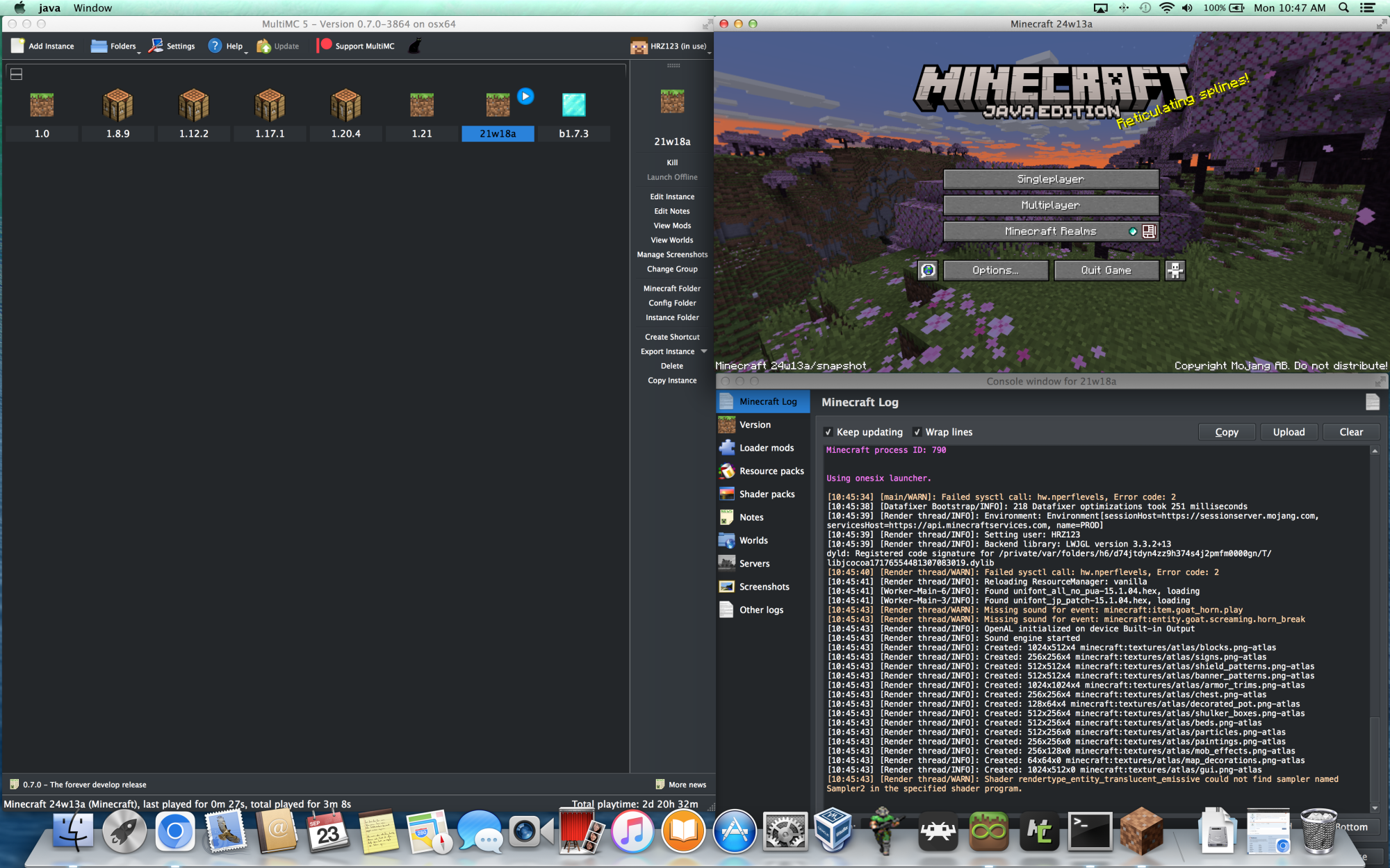

MultiMC works, tested (OS X 10.9.5) on a MacBookPro11,3 with 16 GB RAM.
Tends to get anywhere from 80 to 100 without OptiFine (on default settings, except VSync is off)
with OptiFine it gets around 200 fps consistantly (on default settings, except VSync is off)
:D
:D

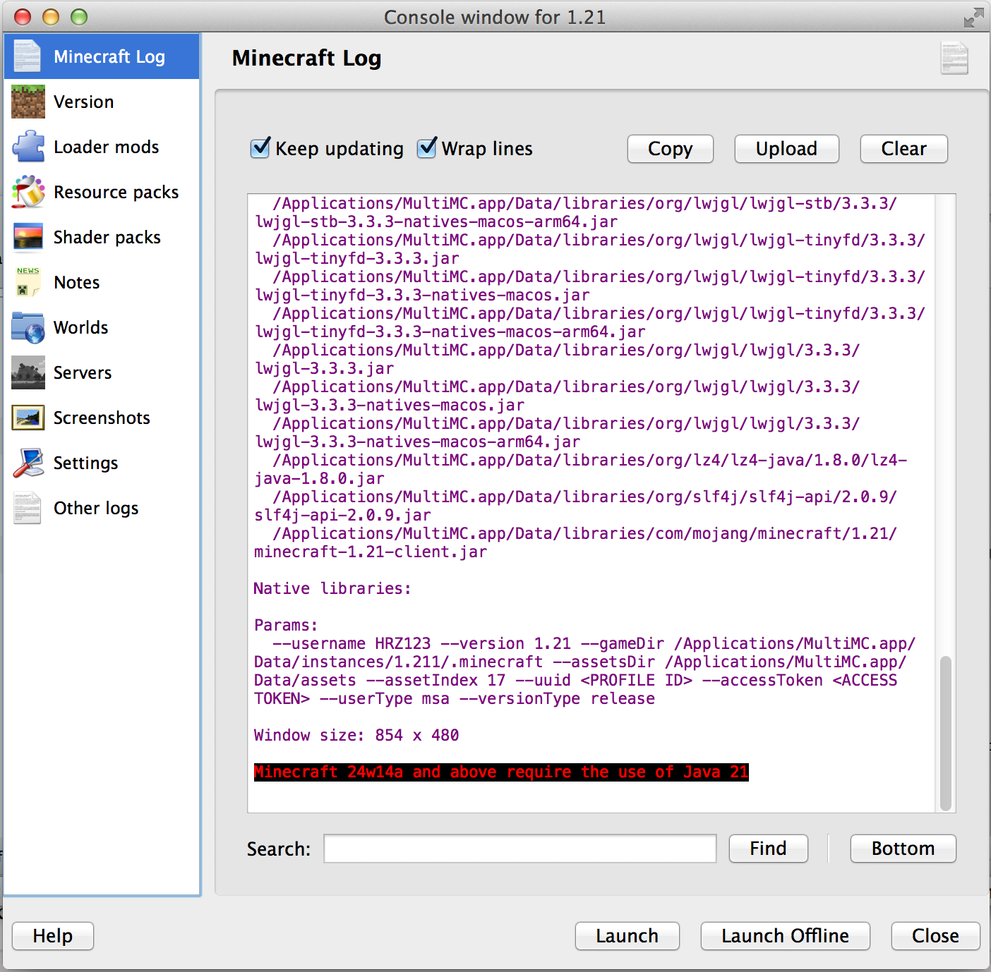

I'm currently working on new releases, which should be released relatively soon. They're much newer, faster, and work on 10.8 (21/17) and 10.6 (11/1.8).
