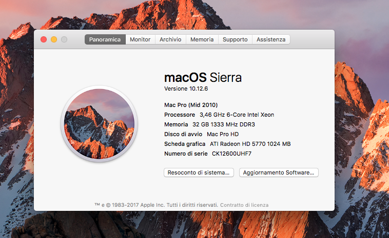

Hello everyone! Just bought an used cMP 5.1 mid 2010. This is the configuration:
I changed the Ram (8 gb udimm to skhynix 32 gb rdimm) and the CPU (xeon w3690). I also bought a Kingston Hyperx Predator 240 gb PCIe SSD that I installed in the Mac with this adaptor: https://www.ebay.com/itm/PCIe-M-2-N...e=STRK:MEBIDX:IT&_trksid=p2057872.m2749.l2649
I'm able to boot from the disk and it gets recognized by the computer but the speedtest shows unexpected results:

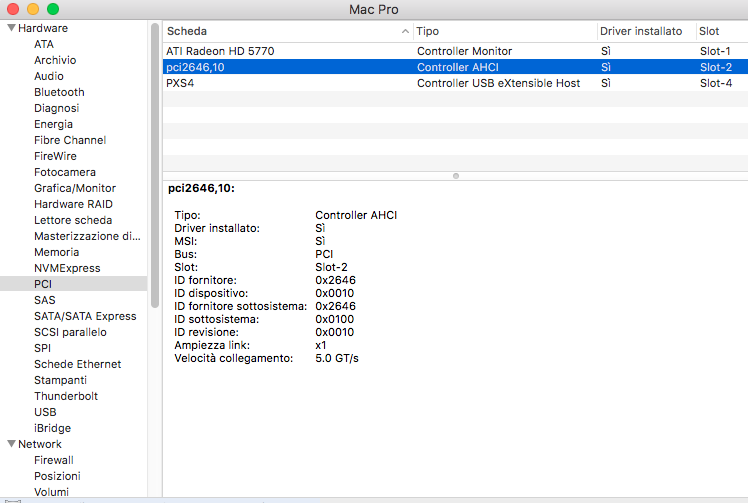

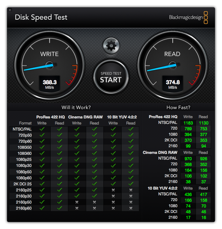

This is the r/w speed using PCIe slot 2. Using slots 3 or 4 results in even worse r/w speeds in the like of 180/190 MB/s. The toshiba hdd in the same mac scores 115 MB/s. What could be wrong? The only thing I've installed are OS updates and blackmagic disk speed test. Could it be the adapter card? Or the SSD is Faulty? System report says tha the SSD has a 1x link... is this normal?

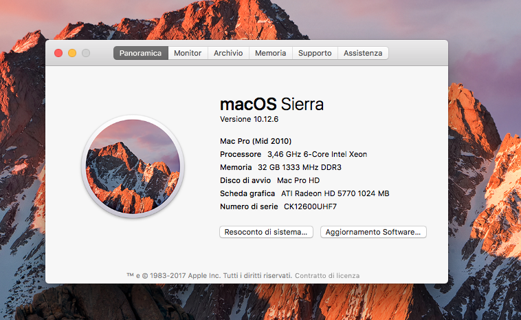

I changed the Ram (8 gb udimm to skhynix 32 gb rdimm) and the CPU (xeon w3690). I also bought a Kingston Hyperx Predator 240 gb PCIe SSD that I installed in the Mac with this adaptor: https://www.ebay.com/itm/PCIe-M-2-NGFF-SSD-Adapter-Karte-for-Apple-Mac-Pro-2006-2012-Samsung-SM951-PCI/162641884709?ssPageName=STRK:MEBIDX:IT&_trksid=p2057872.m2749.l2649

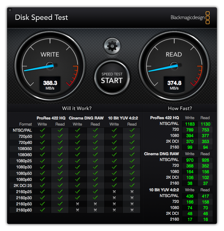

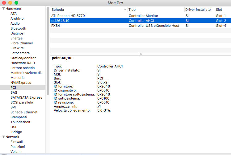

It's indeed the PCIe 2.0 x1 limited the speed at that level.
If the speed further cut into half if you put that in slot 3/4, may be it's negotiate at 2.5GT/s x1, but not 5.0GT/s.
It's really hard to tell which part is wrong without proper test. However, I personally will guess it's the adaptor.
Since you tried slot 3/4 already. Therefore, seems reseat the card won't help. But did you try to reseat the SSD? May be poor contact between the SSD and the adaptor? The screw too tight? too loose?
TBH, for HyperX Predator, it's much better to buy the option that come with the PCIe card (adaptor).
Thanks, I'll try to reseat it and see if it does change something. Unfortunately I bought the ssd alone without the adapter and now i don't think I can find the adapter only :( Can you suggest a good m2 to pcie adapter?
