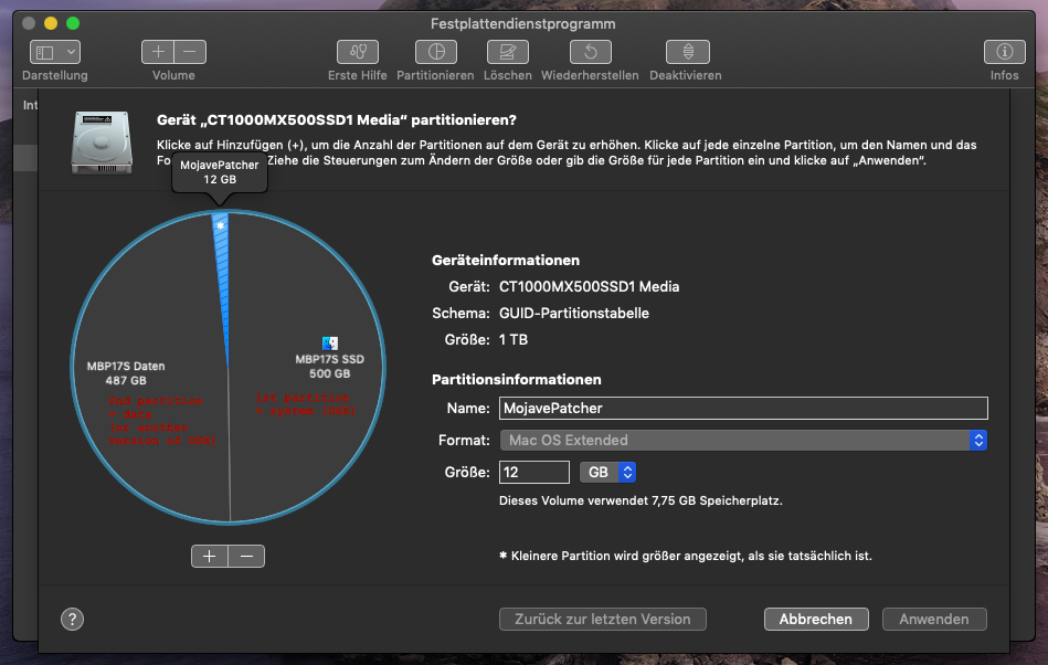

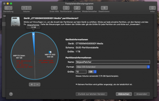

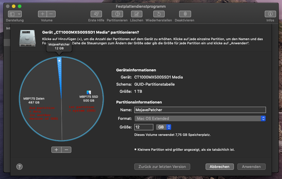

@TricksyFox I hope this may help - it's the way I did things with my stuff (early and late 2008 MB(P))
@eyoungren has told all about partions...
It's really no rocket science to become familiar with DiskUtility-App, where You can separate Your SSD into smaller pieces (=partitions), that can serve different purposes.
My first step would be to reduce the size of the system's partition (the partion, macOS runs off) to a reasonable size, that matches the size of a pair of external-(USB)-backup-drives. Since a 1TB SSD replaces a smaller drive, the size of that drive would be the size of the (first) system partition. With either CarbonCopyCloner or SuperDuper! it is possible to schedule automatic cloning of that (first) system partition to any of those dedicated external drives e.g. triggered by just plugging in the external USB-drive.
After You have separated the 1TB drive into two partitions (one for the running system, the second for the rest), You are free to separate that second partition into other smaller partitions:
- e.g. one for a bootable copy of your current system (= first partion), which You can use to try out any PatcherUpgrades etc.
- e.g. one for big chunks of data, that don't nessesarily need to be shoveled around with any upgrade/backup-process of the system-partition.
- and e.g. for one/some for different versions of OSX - maybe Leopard/SnowLeopard to run some software-gems, that require Rosetta (in my case to run a certain fax-software with the old Apple-USB-modem or iMovie'06 and special filters)
[By holding ALT-key on booting, You can choose, which system-partition to boot from.]
- and finally a tiny 12GB partition at the very end, where You may install @dosdude1 's patched macOS-installer of Your choice (Sierra,HighSierra,Mojave //end of 32-bit & HFS+ -support // Catalina). You can boot from this tiny installer-partition to install/update any of the chosen patches. If You have a clone-copy of your current system-partion on any other partion of the 1TB-drive, you can securely try out the result of a patcher-update prior to directing it to your original system.
Before trying all that stuff above please make sure to have a function-proof backup of your system, which is IMHO only a bootable clone-copy to an external drive.
Here's how I partitioned my 1TB SSD. 2nd partition could also be separated to get extra-space for a Leopard or Snow-Leopard installation (40-60GB should be sufficient).
It's important to put temporary/experimental partitions beyond any important steady partion, so that they can be deleted and reintegrated into the proceeding partition.
