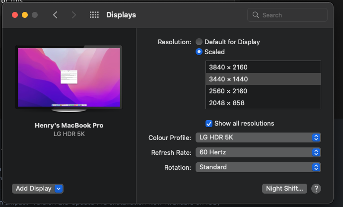

My resolution got all messed up all of a sudden on 12.1
Is it still working ok for you? can you share a screenshot of this screen? use to see 4 options for the monitor under "scaled" now its a bunch of crappy resolutions

I have M1 pro 14 inch and nothing is working for me, I even wiped and downgraded to 12.0.1 and 12.1. SwitchResX doesn't even work for custom resolution, I get "invalid"
If you use Monterey 12.0 or 12.1 you don't need SwitchResX. These versions support 3840x2160 resolution.
Make sure the firmware of your LG monitor is updated and use the Thunderbolt 3 cable which was delivered with the monitor.
