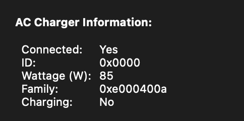

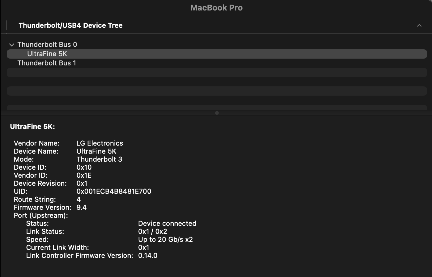

My 5k started acting up yesterday (blurry screen and random black disconnects) til it finally died this morning. Been troubleshooting all afternoon. I'm using a higher end 15 inch MacBook Pro (2018). The UF charges the MacBook, but that's it.
What I've tried so far:
- Reset SMC and PRAM
- Tried 3 different TB cables (40gps, 100W). Yes, including the original one that came with the box
- Factory reset
- Tried different ports
- LG Screen Manager (this app does absolutely nothing for me). On Monterey it says "This monitor is not supported" and there's no firmware to download anywhere to update it manually.
- Rebooted with monitor plugged in / out
- Turned computer fully off with monitor plugged in / out
- Clamshell/closed laptop lid
Sometimes if I plug the TB in and out there's noticeable cursor lag on the MacBook for like a minute, but the UF remains black. It is connected via system report however, and it only shows 20gps.
Dear kind strangers - is there anything else I have left to try before I bid farewell to my monitor?
Thanks,
BSFE
Completely disconnect both computer and LG from power source for a minute. Probably not going to work, though.

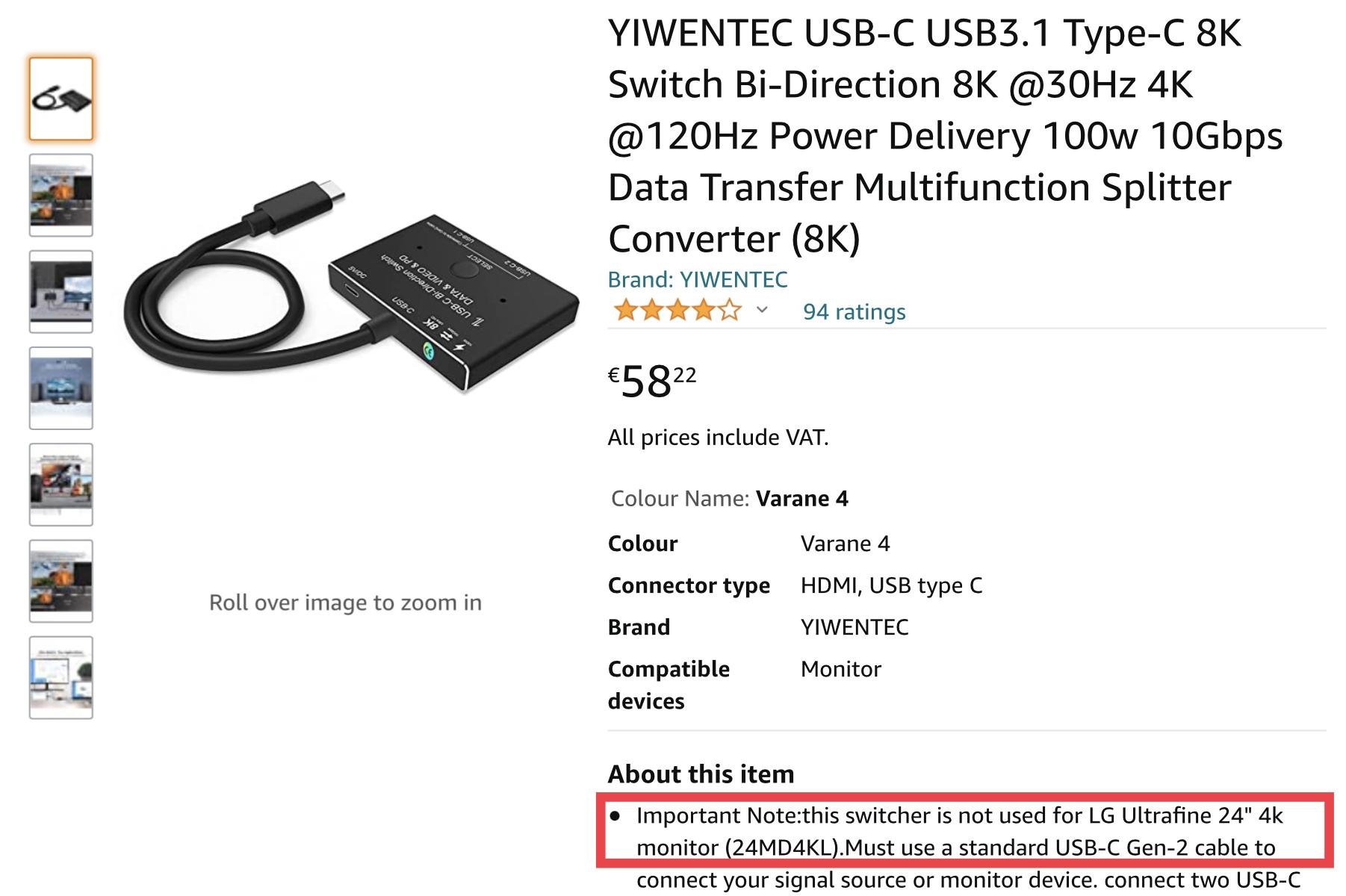

Anyone use this with a Ultrafine 5K and two macs?
Seems to be the only exiting USB-c KVM switch, but the note for the Ultrafine 4K is confusing.
This thing won't handle dual-link-SST-via-Thunderbolt displays like the LG UltraFine 5K at full resolution. The best you'll be able to get via single-link DisplayPort 1.2 SST (USB-C!) is "4K" at 60 Hz (or 5K at 39 Hz using custom timings)... if you have the newer model (27MD5KL).

The switch still couldn't handle a dual-link SST over Thunderbolt 3 setup then though.
I mean 4 lines of 20 Gbps signals. Thunderbolt has two bi-directional (full duplex) lanes of 20 Gbps = 40 Gbps each direction = 80 Gbps total.
The switch is meant for 10 Gbps signals, 4 lines = 40 Gbps total.
