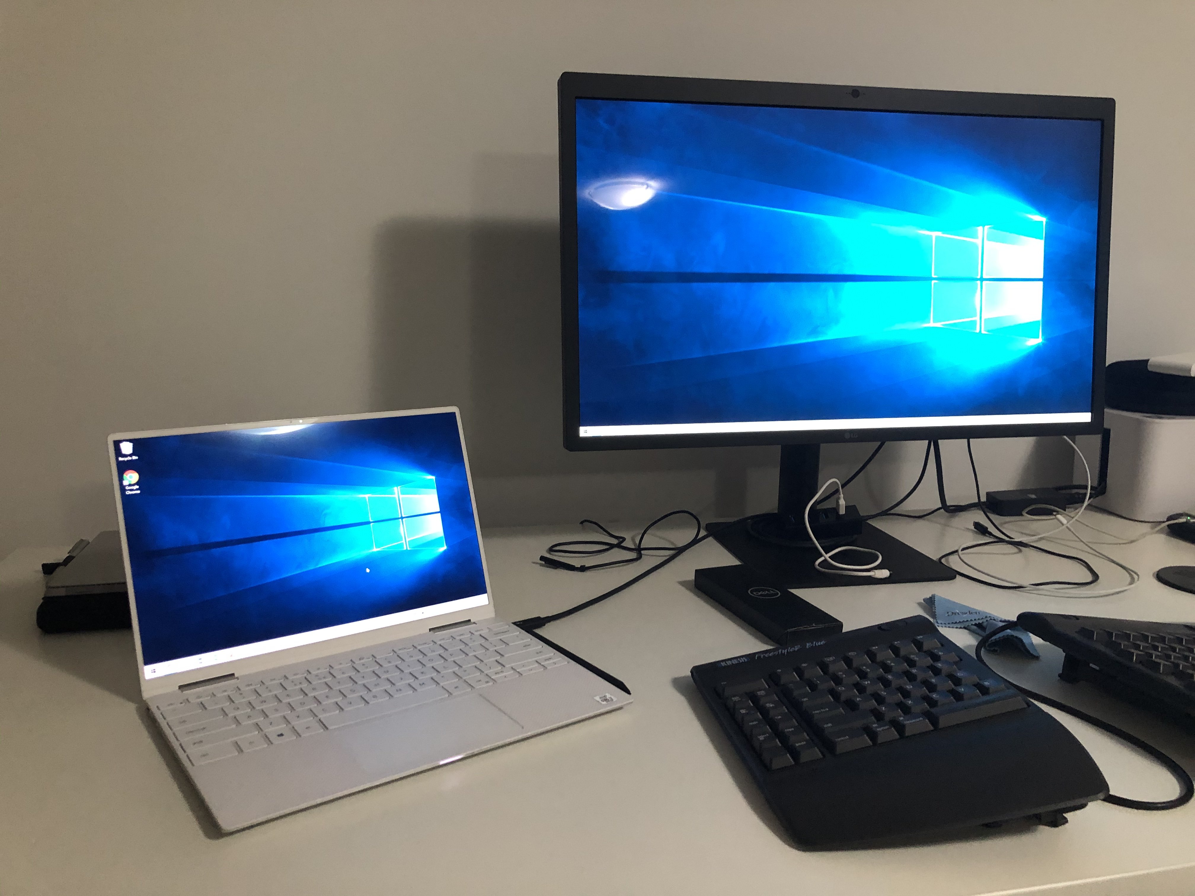

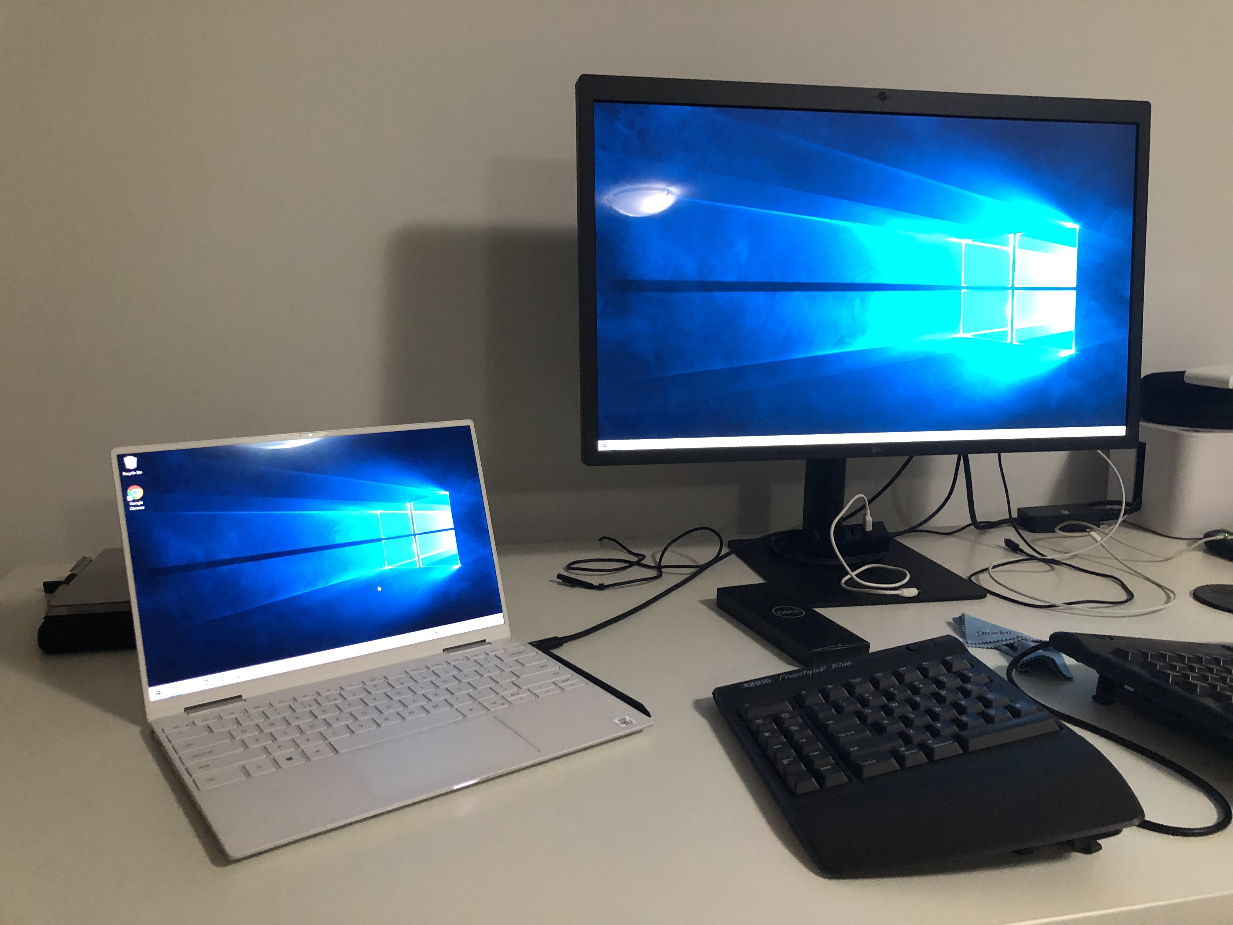

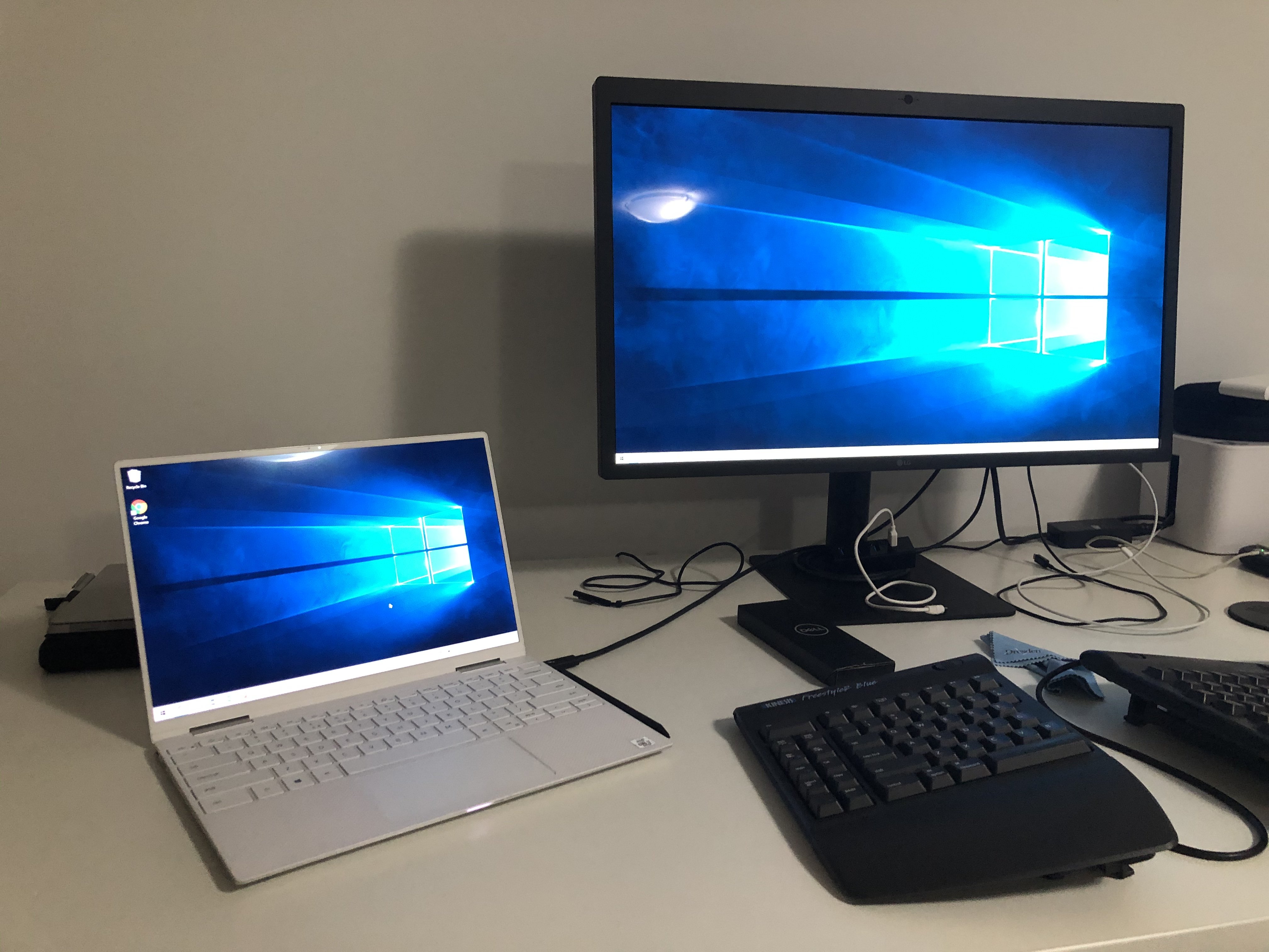

So I bit the bullet and got a Dell XPS 13 7390 2-in-1 for the wife which has 4 lanes of PCI-e on each Thunderbolt 3 port.
Arrived last night and it works perfectly with the same older 27MD5KA that you have at full 5K so I’m super happy.
Brightness adjustment and webcam aren’t working but the speakers do. Have yet try third party utilities to adjust brightness.
Webcam should work out of box, at least it did for me on my desktop.
The brightness control is the only one need another program to adjust.
