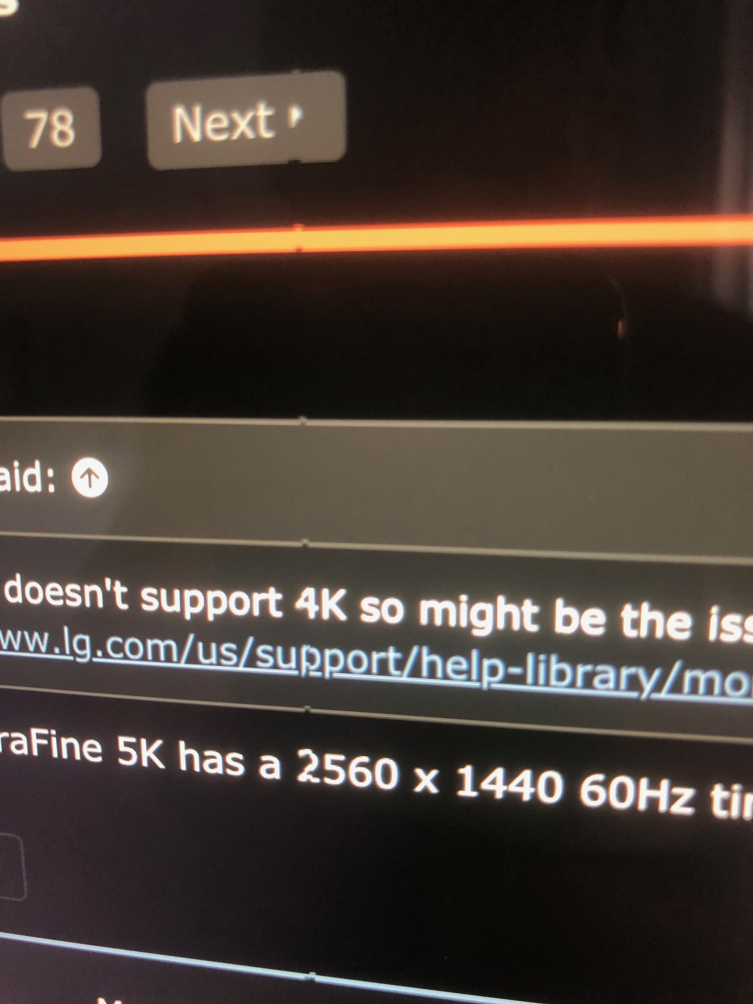

I just tried - the monitor stays black - although my 2012 macbook pro knows I'm connected. LG manager says software is all up to date as well. Just seems my monitor doesn't power on when I connect my thunderbolt cable to my laptop. I'm open to ideas. Would love to get this to work in the interim :) Its a mid 2012 macbook pro.
The macbook is essentially on when I connect to the monitor. I just plug my thunderbolt cable and it should technically turn the monitor on. What happens is, my macbook pro recognizes the monitor, but it doesn't display anything. Stays black. Whereas when I plug the 2019 in, it recognizes it, and the monitor displays.
Try using a different cable, such as the Apple Thunderbolt Cable (which can send either a Thunderbolt or USB-C signal).
Which UltraFine 5K do you have? The 2019 model (27MD5KL) or the older model (27 MD5KA)? I have the newer model, and have noticed that if I plug it directly into my work notebook (a 2018 HP Elitebook 840), it doesn’t work with the LG Thunderbolt cable, but it does work with the Apple Thunderbolt Cable, but only at 4K, implying it is sending a USB-C signal. I haven’t tried it with the LG USB-C cable.
Interestingly, I also have an HP Thunderbolt Dock. If I plug my HP notebook into that dock, and then use either the LG or Apple Thunderbolt cable, it works, and I get full 5K if I plug it into the TB port on the dock (4K if I use the USB-C-only port). Perhaps the Dock is able to send the combined 2 DisplayPort signal even though the TB port on the notebook itself isn’t able to.
