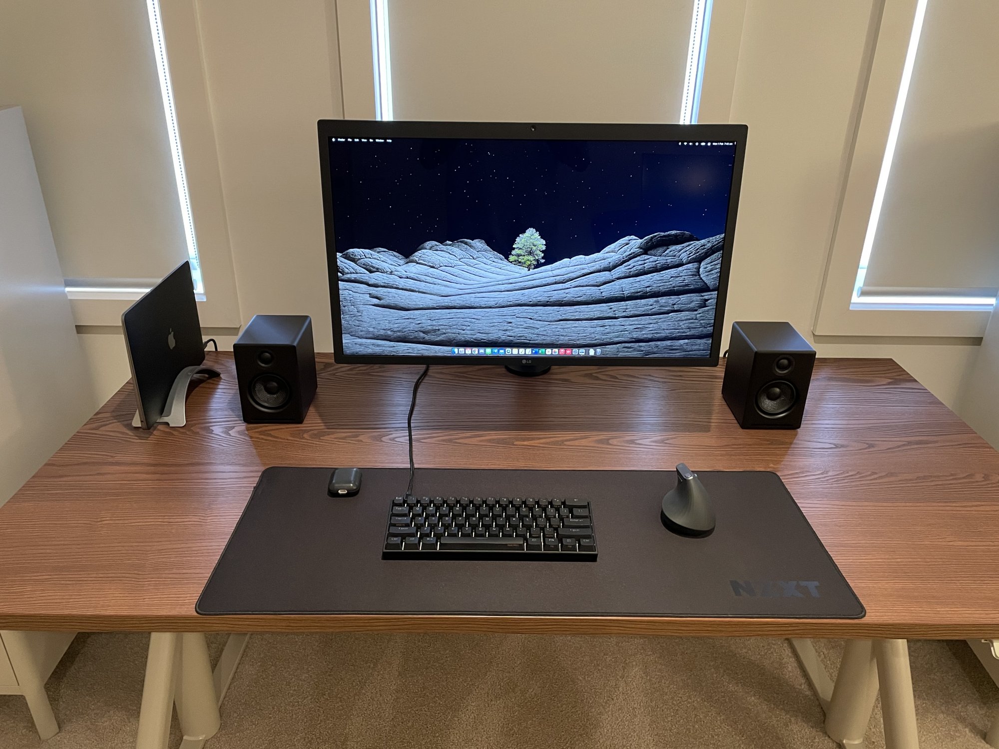

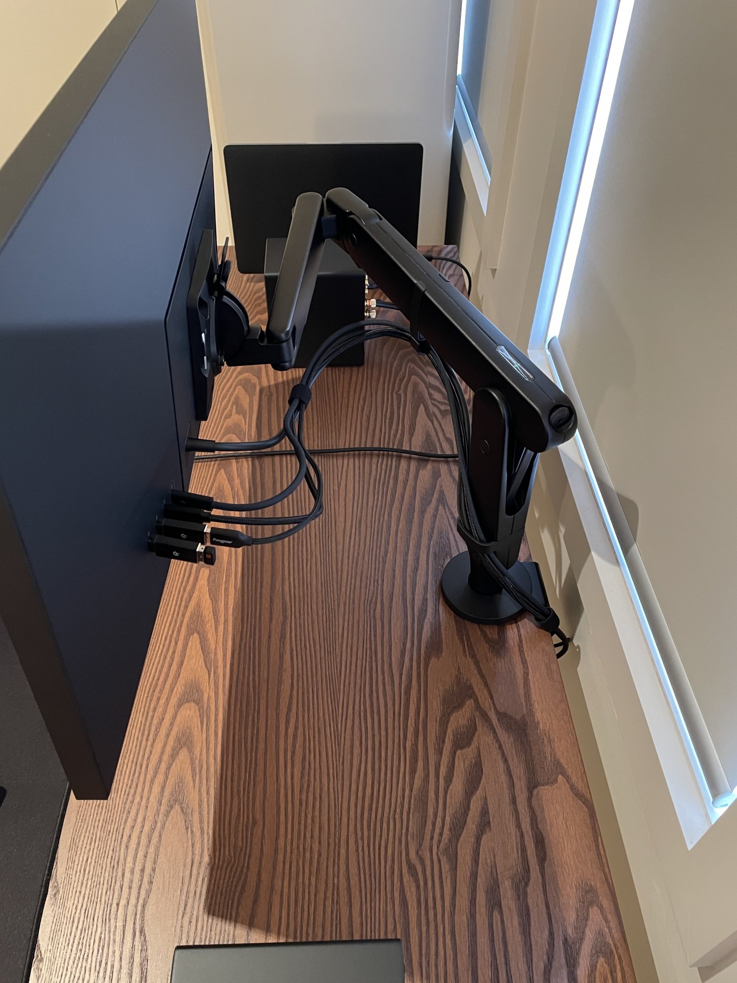

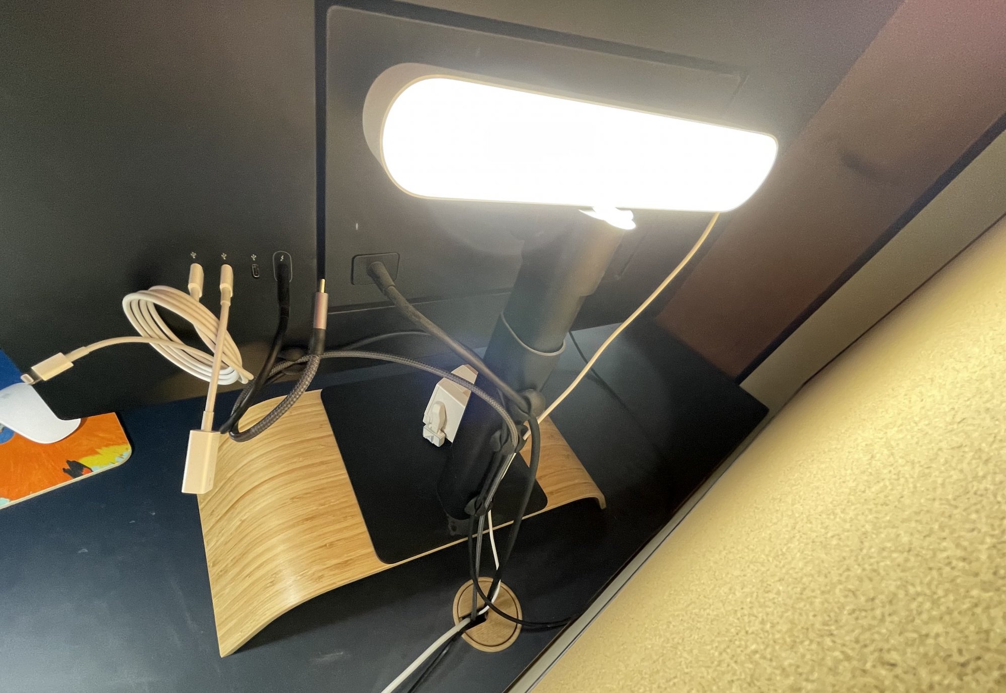

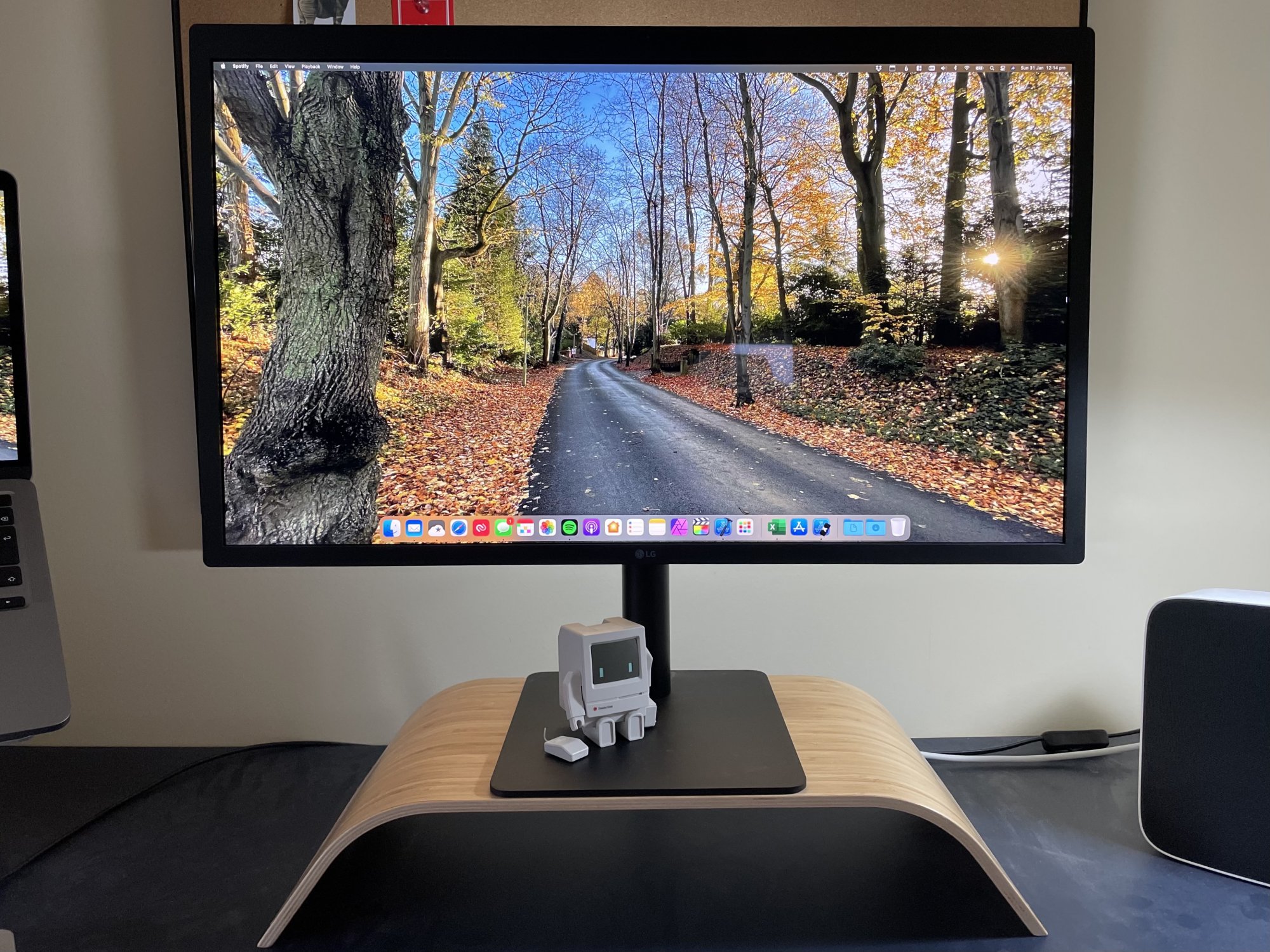

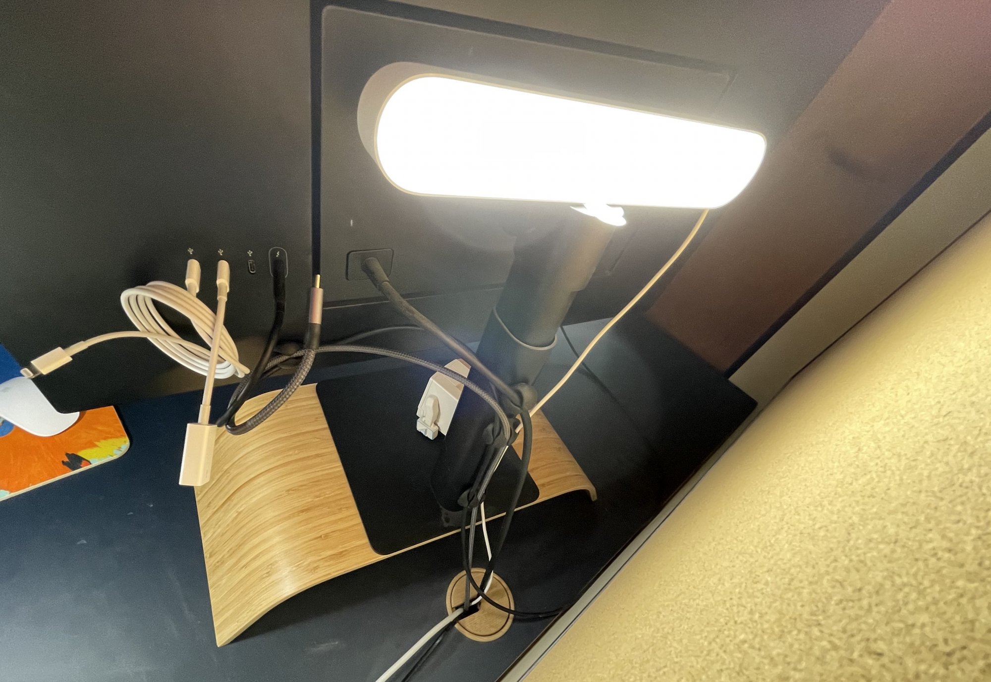

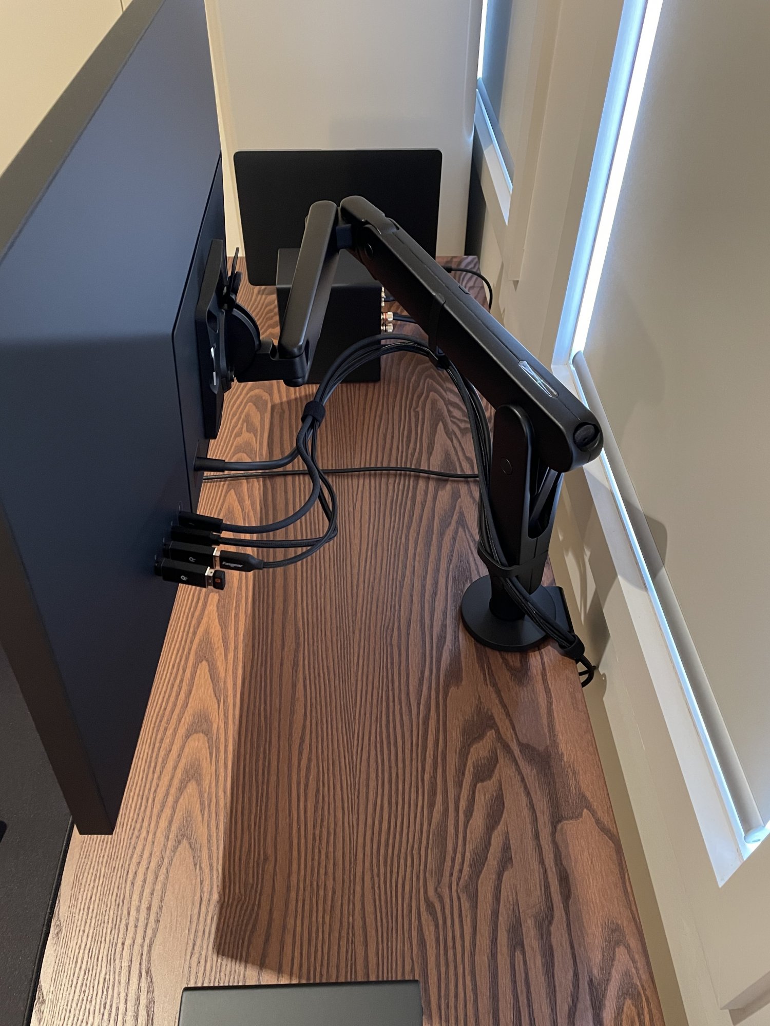

Spent a bit of time yesterday trying to neaten my setup with some £5 adhesive cable clips from Amazon. Used to be able to see the power cord, Philips Hue bar cord and two TB3 cables (one for MBP, one for PS4) hanging a bit below the screen. No such issue now. I do welcome better ideas if anyone has any!
Use cable management as an excuse to justify the purchase of a nice vesa arm, naturally.
