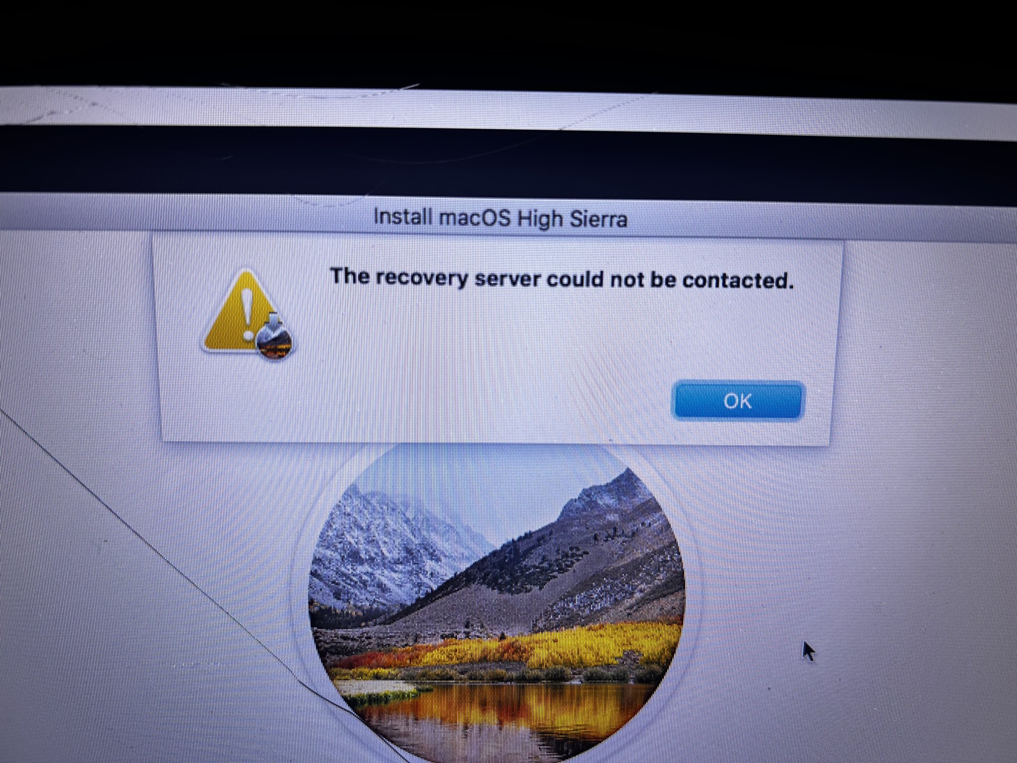

Damn. Server cannot be contacted?
Just found this on a forum…
“I had the same issue after I wiped the drive on my MacBook Pro. When you wiped the drive you selected the wrong format. All you need to do is simply go to disk utilities and erase the drive again, but this time select APFS (Encrypted) rather than just APFS. You may now click Reinstall macOS High Sierra. Side note, make sure you have internet connection in your status bar.”
Legit?
Just tried this erase encrypted and not worked. Still same pop up whej I press continue.
I have checked the date in terminal and it is correct for todays date. 26th May 2024. Is this correct. ??

Is the issue these servers are not supported any more?
I just want to add high Sierra. How hard can this be.

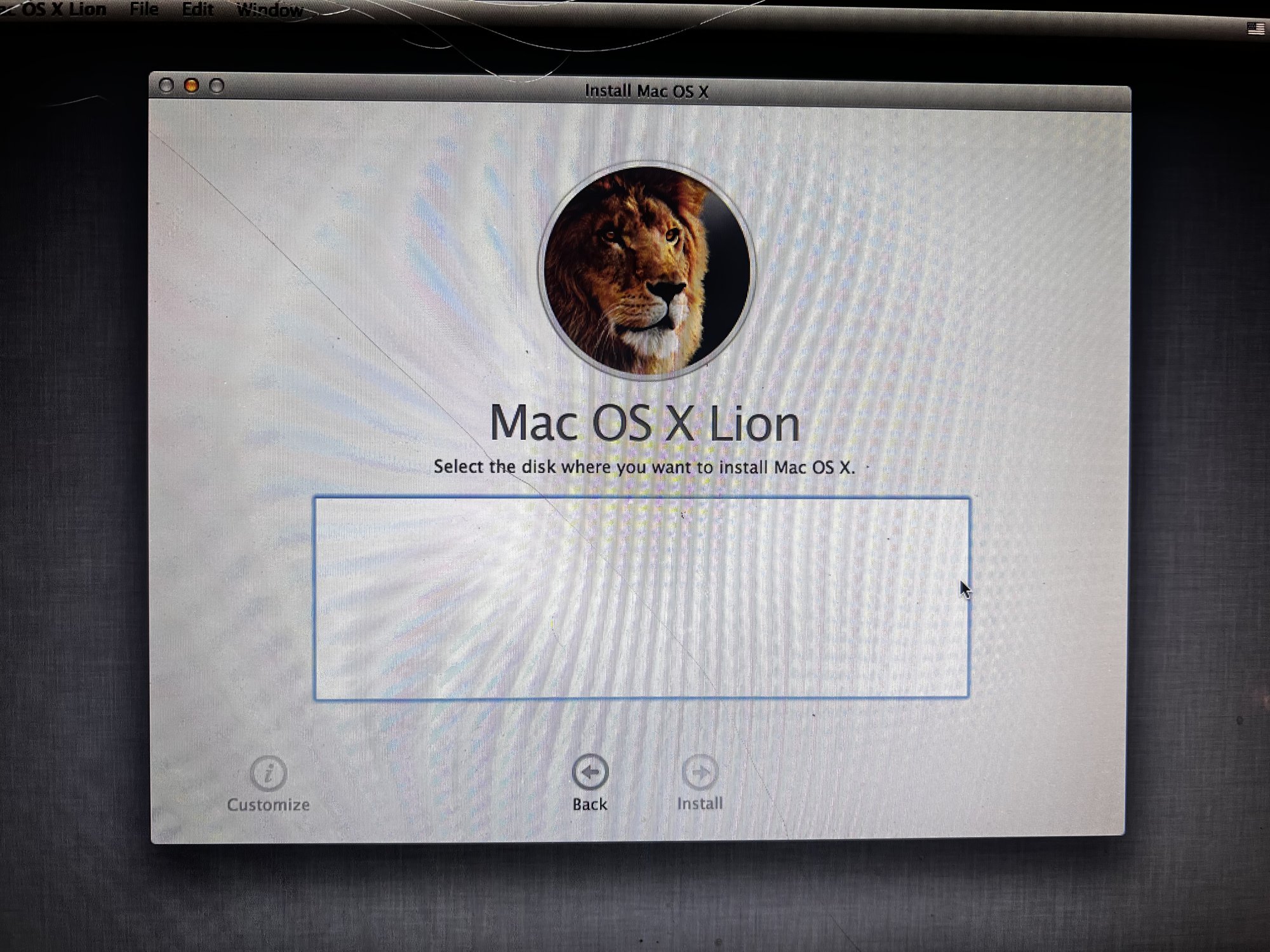

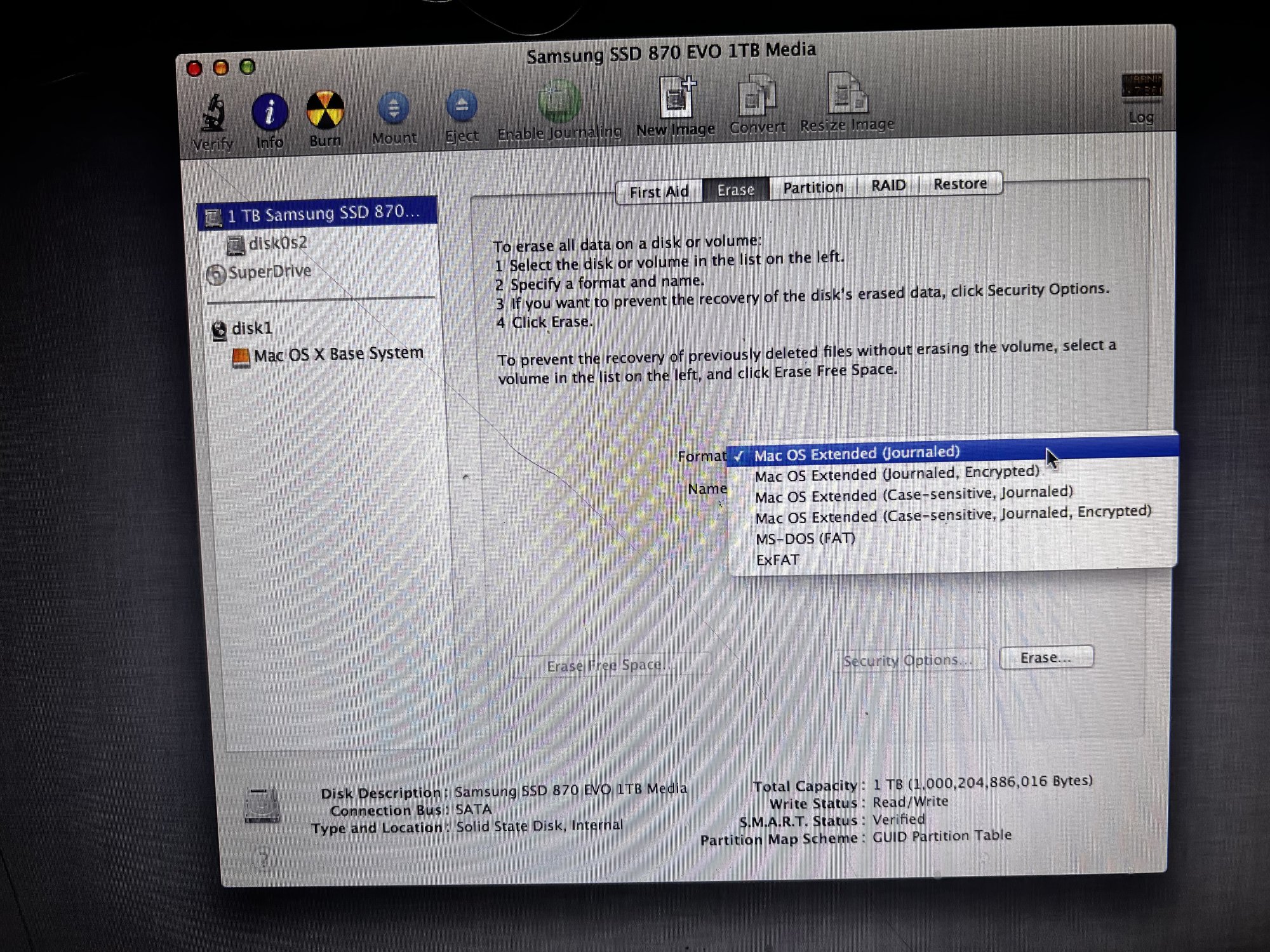

Look. I tired to install Lion.
And it gets as far as here. I press install and that’s it. Nothing happens.
There’s no functionality after this. ??

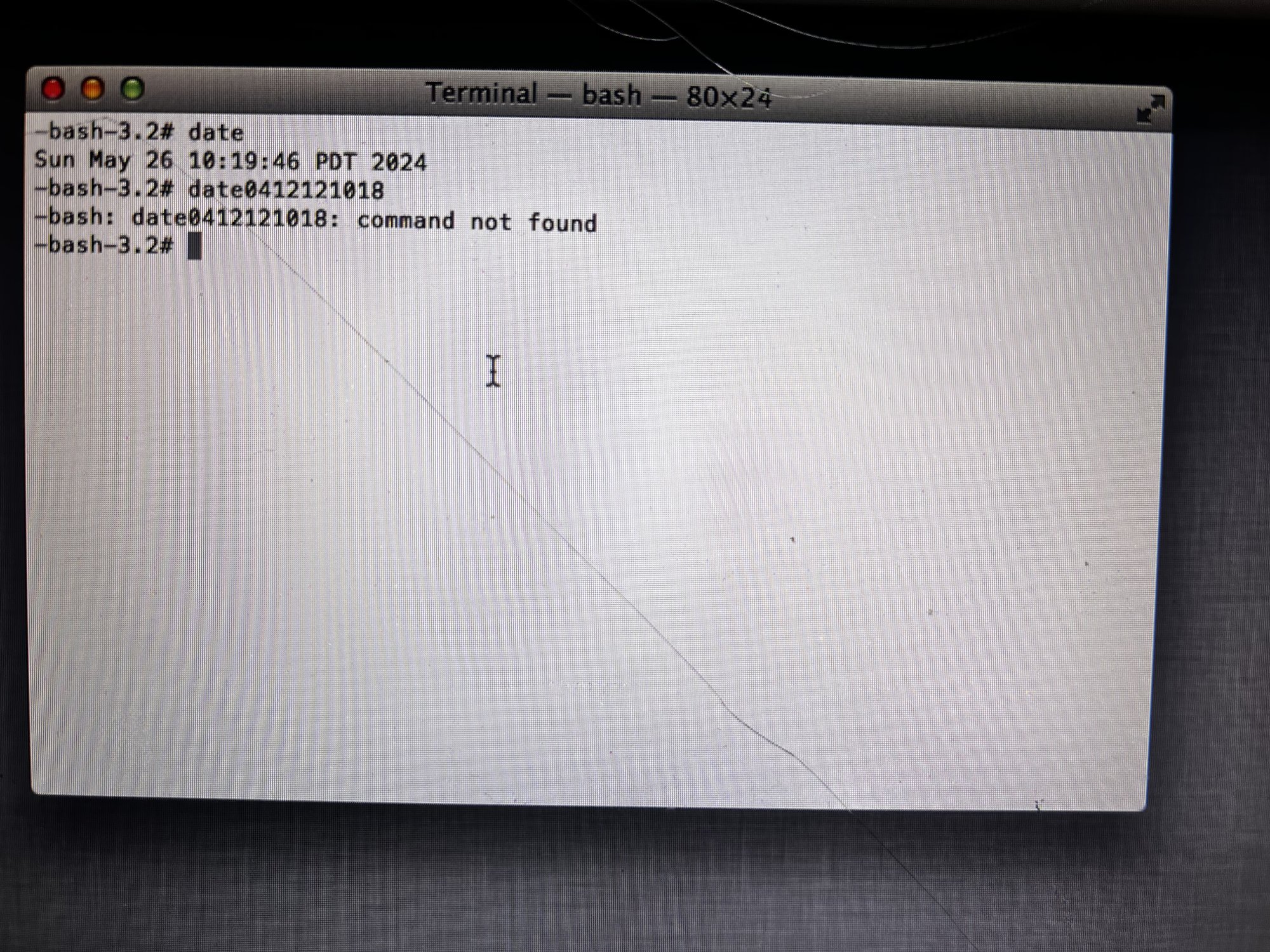

Make sure you're connected to WiFi for this. Try changing the system date to 2018 for High Sierra in the terminal:
date {month}{day}{hour}{minute}{year}
You'll replace each of the brackets above with the a two-digit number that represents the month, day, hour, minute, and year in that order. Don't include spaces.
For example:
date 0412121018

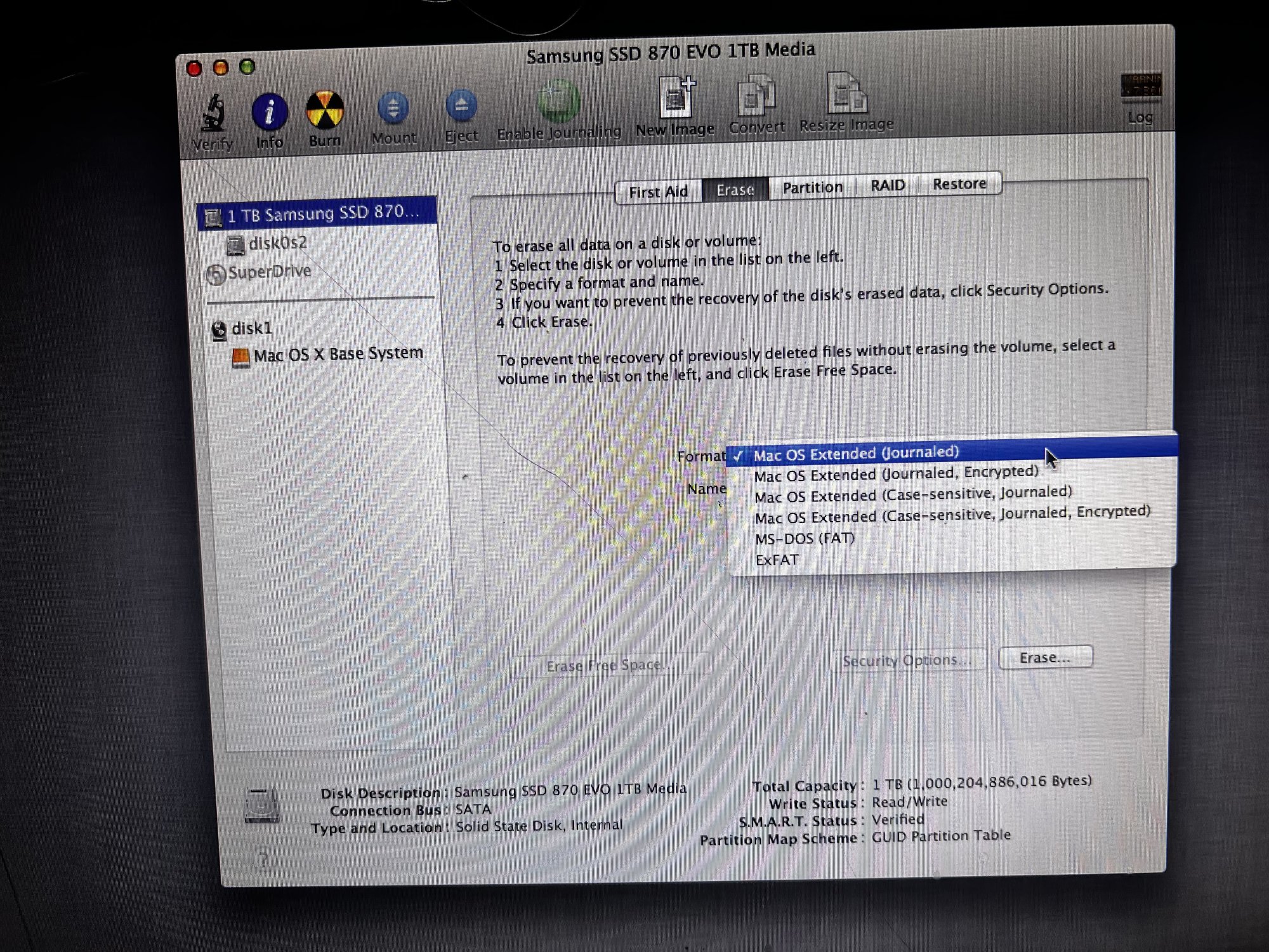

If you are going to install Lion you need to format the SSD as HFS+ Journaled. Nothing before Sierra knows anything about APFS.

I tried to change the date but not sure how.
Ok so I erased the first option.

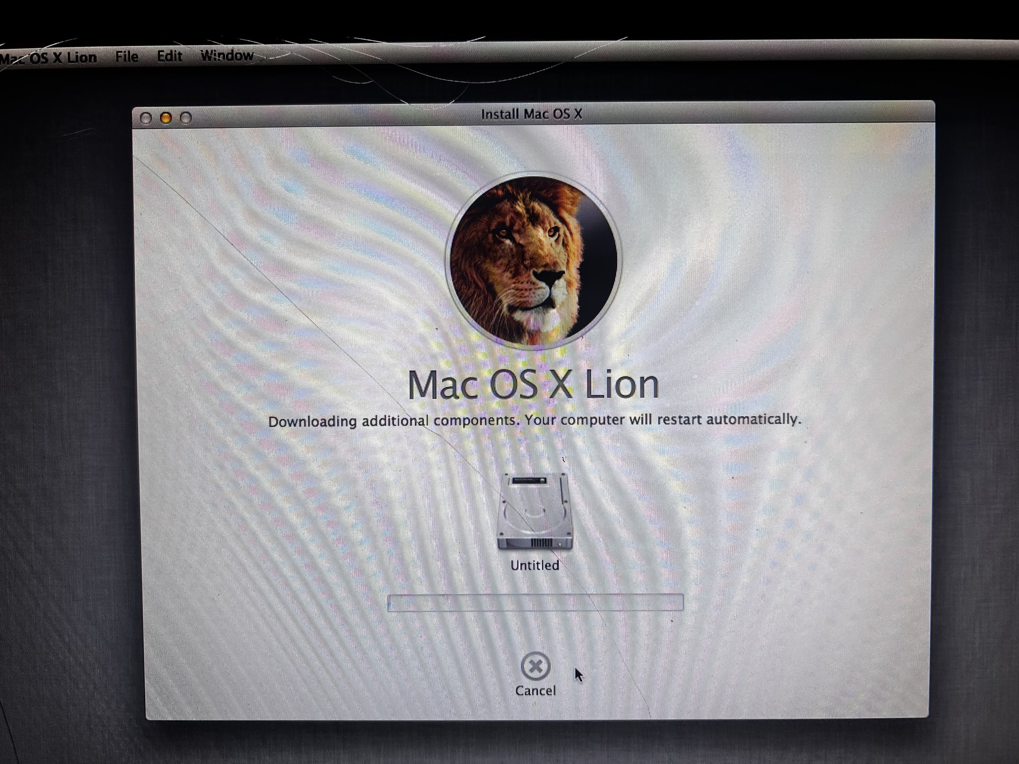

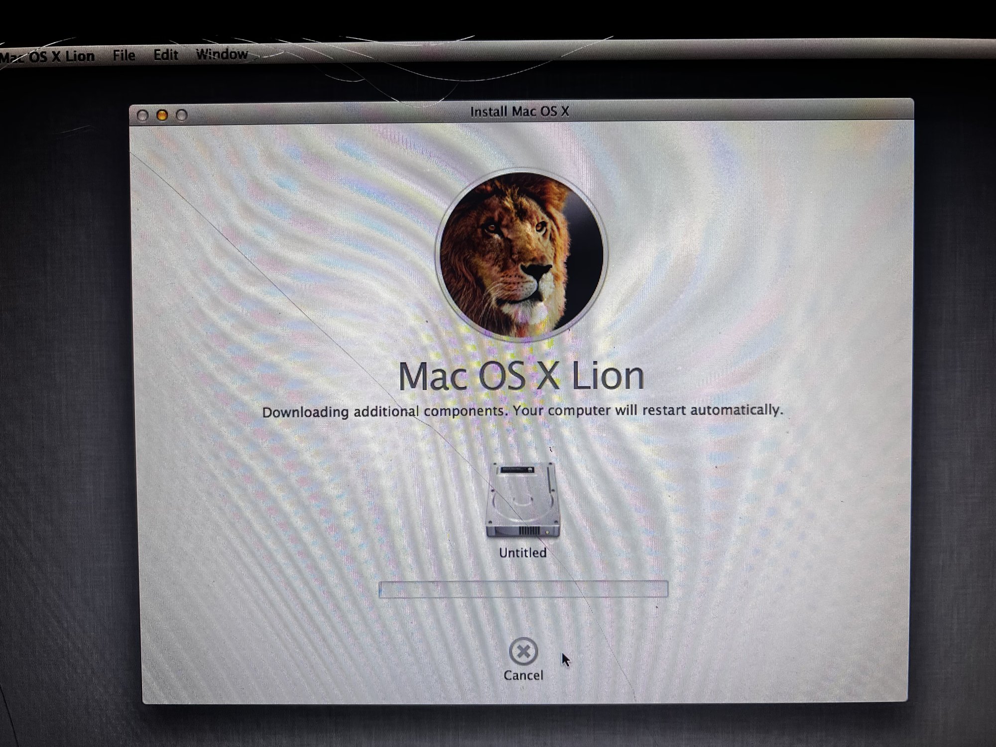

May be working now. Installing lion. I wanted high Sierra.
So if lion installs now. Can I upgrade to high Sierra or Mojave from ???
