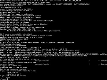

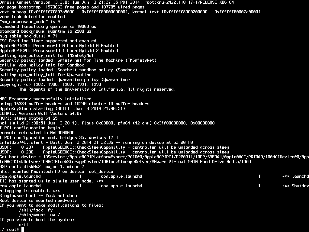

It would appear the confusion is on your side. Single User Mode (Cmd+S) is not the same as Safe Boot (Shift). Single User Mode relies on EFI and does not load any drivers because the hard drives are mounted in read only mode at the end, so graphics card support is restricted to what the EFI can interact with. You have to manually remount the hard drives (after running the fsck process, of course, for safety's sake) to write to it.
You get a black screen with rolling text as the EFI probes the hardware. Verbose mode is similar except you get the full boot process in text mode so that if it stops somewhere you can pinpoint the exactly where the boot process stops or what the kernel panic cause is, if that is the outcome.

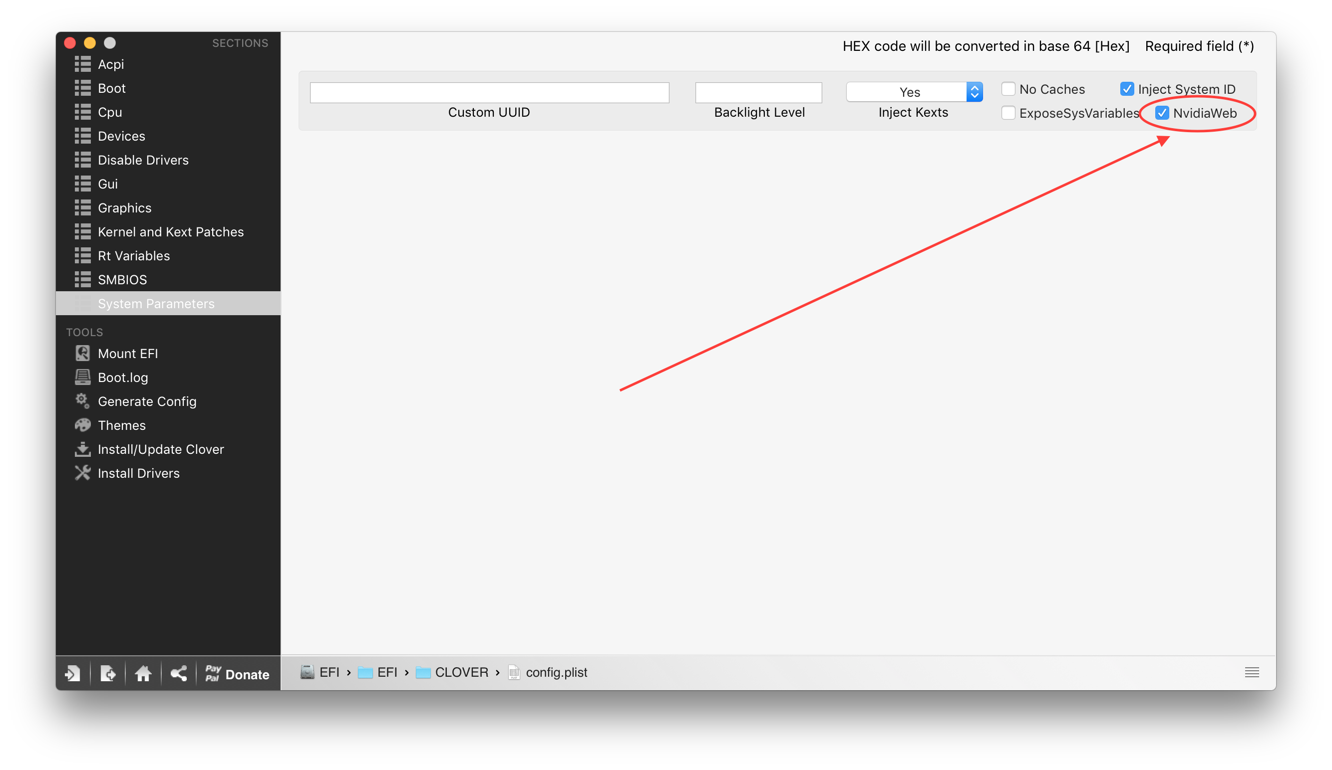

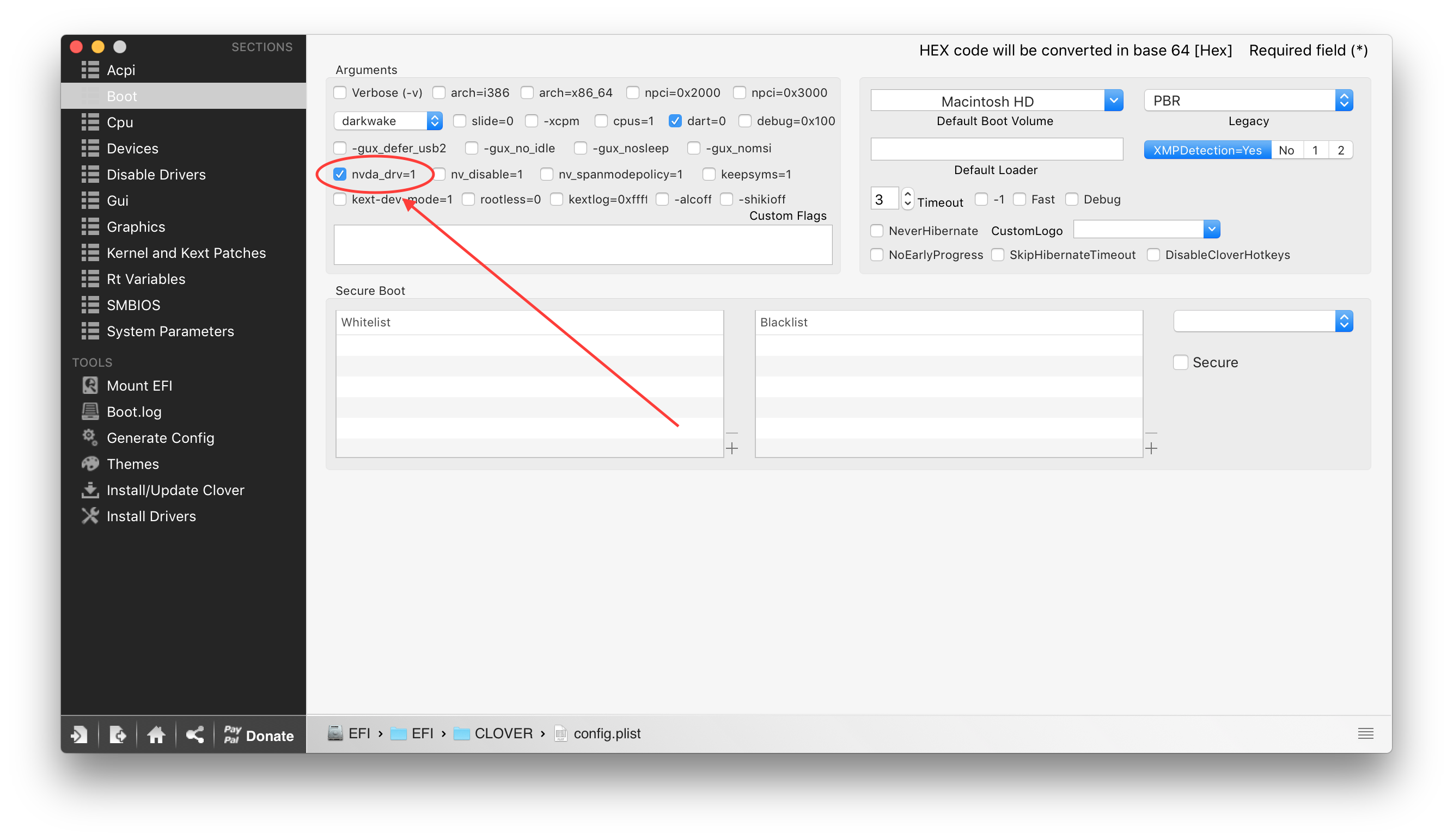

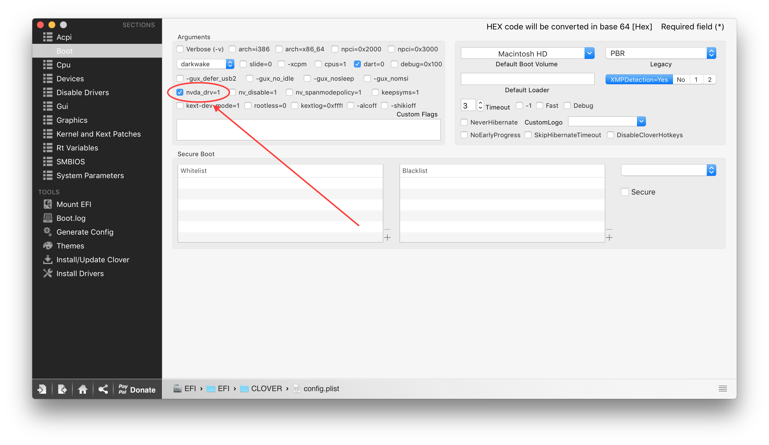

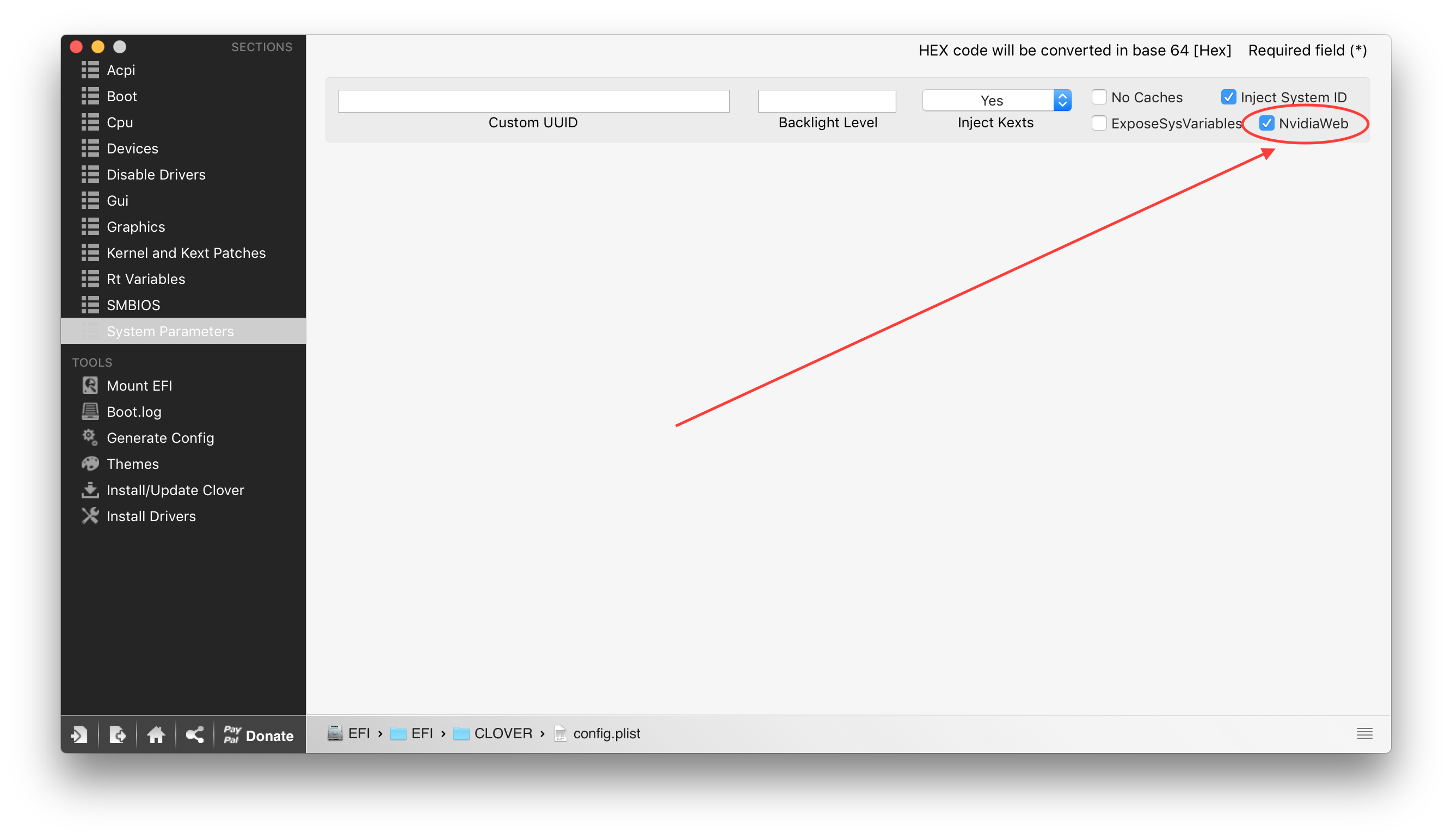

I would try by doing the following:
  1. Clone your System drive to another drive. (Disable iCloud prior to cloning, just in case.)
  2. Download and install Clover on the cloned drive.
  3. Download Clover Configurator to configure the config.plist that is on the EFI partition of your cloned drive. (You need to mount the EFI partition either in Terminal or using Clover Configurator.)
  4. Once you have your config.plist open in Clover Configurator, enable the two settings I have shown in the images below. You MAY need to set SMBIOS but I don't know for sure, but it's not essential to get booted.
  5. Select the cloned drive as your startup drive in System Preferences.
  6. Cross fingers and hope for the best.

Thanks for the detail procedure. That's good enough for me to follow.
Few more questions:
1) I don't have a Nvidia card, but can only test it with a 7950 (PC VBIOS). That particular procedure seems Nvidia focus. Do I need to change anything? Or it's just a general way to provide bootscreen?
2) If test failed. Looks like if I disable that 2 settings, cover will effectively doing nothing, and i can just leave it there and continue use my backup drive. Right?

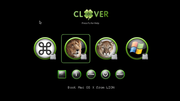

I don't know how this procedure would work with AMD/ATI. My guess is that, Clover should be able to initialize the video card. Secondly, since we don't have to do anything special to activate the AMD/ATI drivers, it should just work. Again, this is all speculation on my part...
Yes, if you don't change any settings, I think that Clover won't do anything and will just act as a boot loader that you can use to select whatever operating systems you have on your system. Example:
Source: Random Clover boot screenshot I got from Google (The appearance of this is completely customizable and will most likely look different for you)

May I know where is the reliable source to download cover? Try few different key words in Google, but couldn't get a good result .
A quick test shows no bootscreen. I did…
1) clone primary SSD to backup HDD (tested bootable)
2) install cover (all default setting, GPU is HD7950)
3) select HDD to boot, restart
4) hear the chime, but black screen only. HOWEVER, all USB 3.0 drives work (card reader / HDD enclosure LED shows that all SD cards / HDDs are mounted). That's just few seconds after the chime, so, 100% not load to OS desktop yet. Something properly initialise the USB 3.0 card (KT4004).
5) no loading sound from HDD, the computer seems waiting for something (may be cover is actually there but I just can't see), so, I press Enter (assume it's pointing to the default HDD).
6) continue to boot, and then confirmed that's boot from the backup HDD.
So, the good news is.
A) it won't kill anything
B) USB 3.0 may be bootable!!!
But I need more time to figure out if I can make cover properly initialise the GPU.
