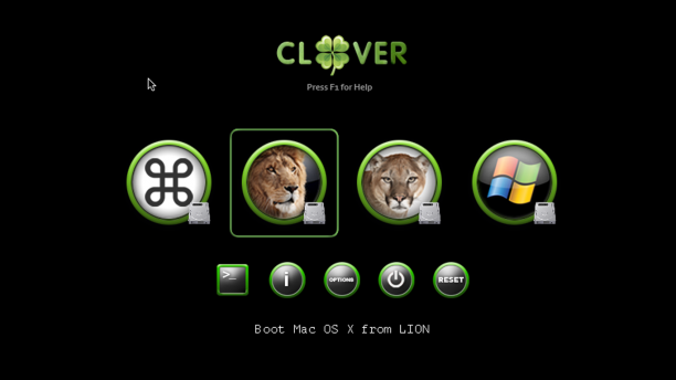

Source: Random Clover boot screenshot I got from Google (The appearance of this is completely customizable and will most likely look different for you)
looks good

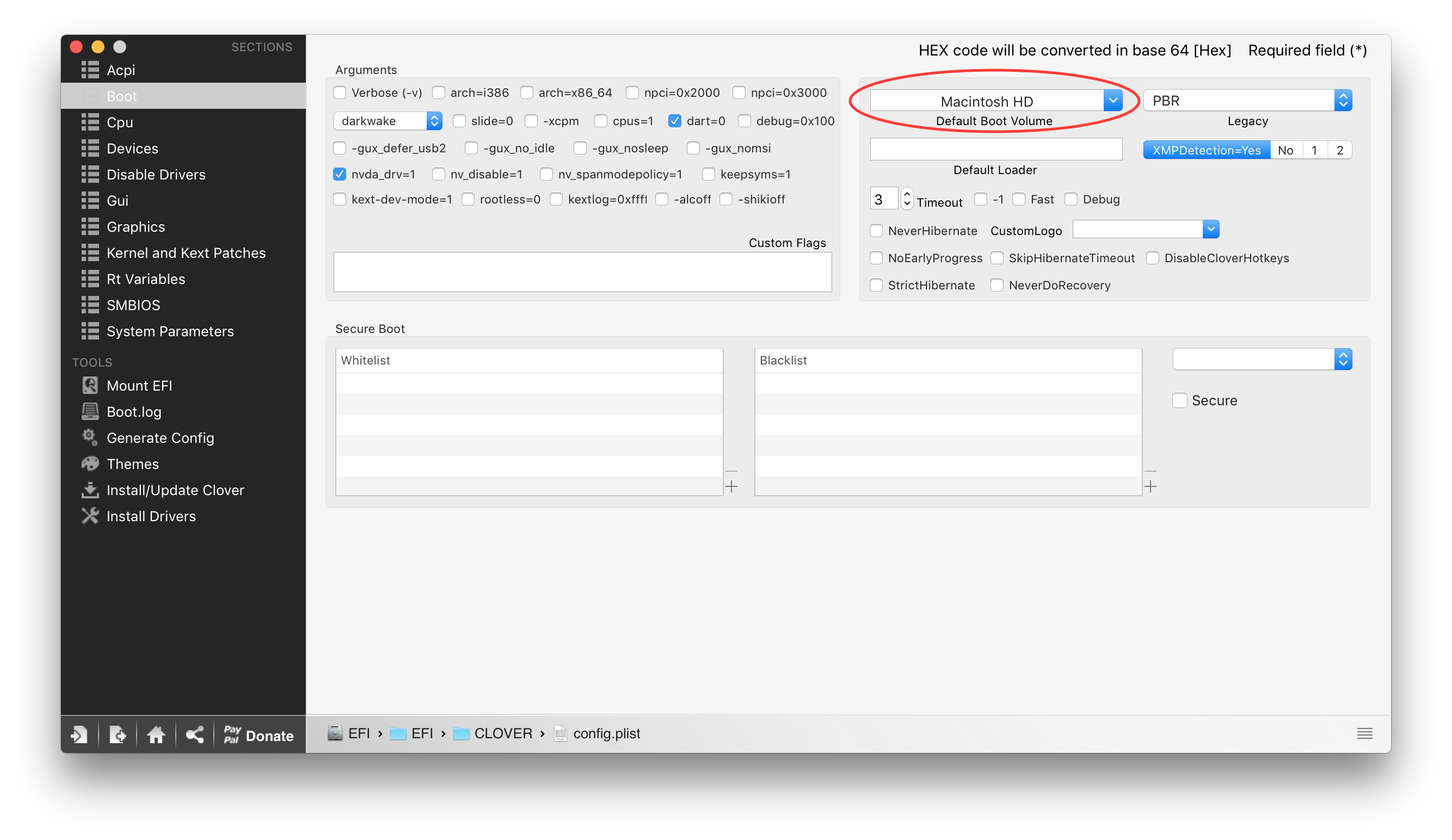

Maybe you can try setting the default boot volume with Clover Configurator and then press the Return key when you believe the Clover boot loader has loaded to see if booting macOS will get you video.
No 100%, but this is what I did. That 2 ticks are default config, no other ticks. And the 1st item "UEFI booting only" remain uncheck, so, I think it means legacy also supported.

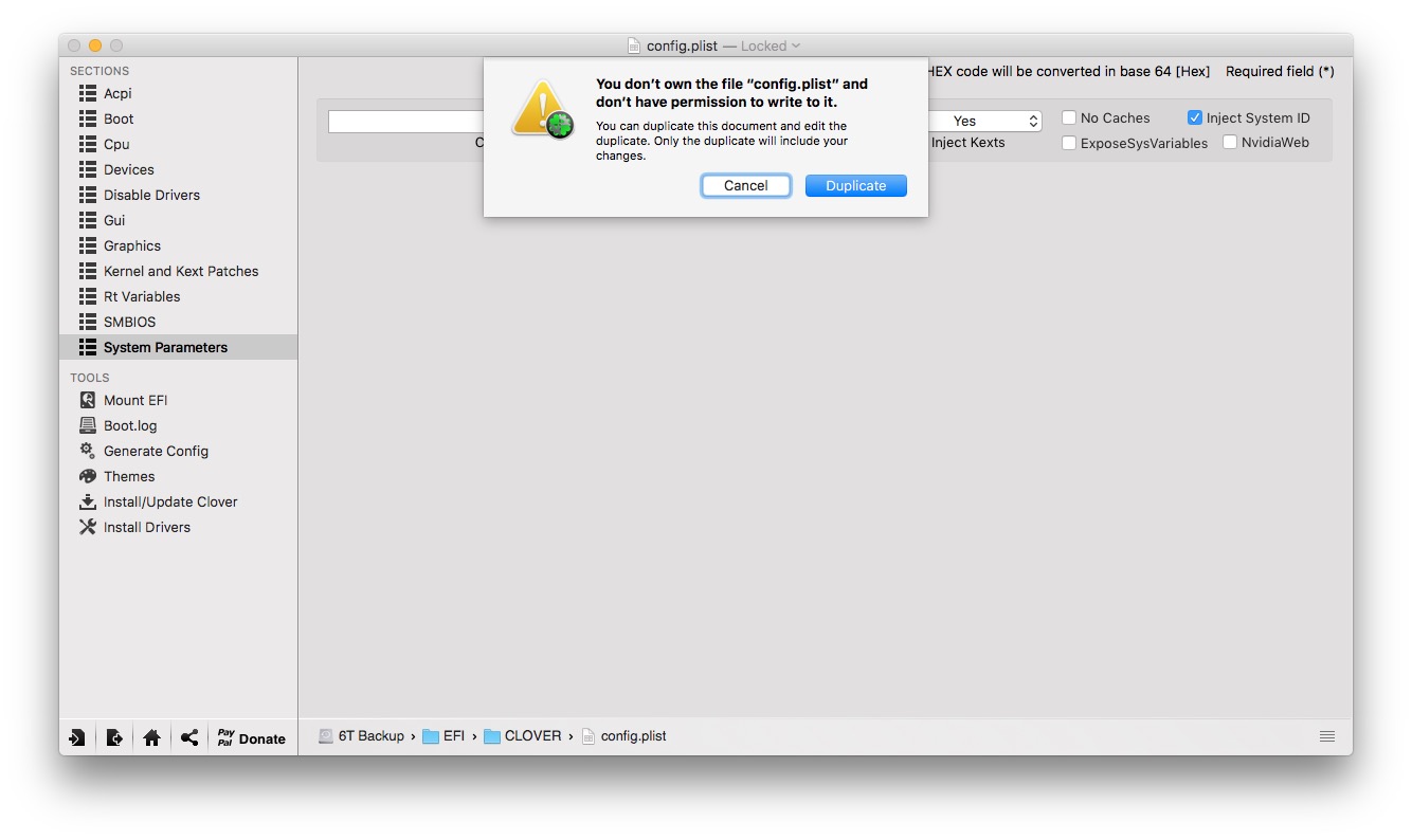

When I try to use cover configurator, I get this warning. Should I duplicate the plist file, mod it, and than fix the permission by myself? (This warning appear regardless if I mount the EFI partition or not)

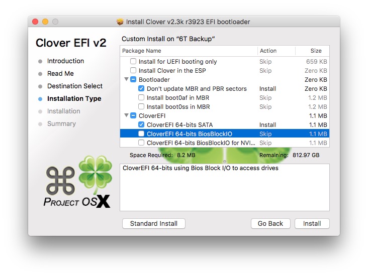

Thanks for your suggestion, can you tell me more details on how to do it? Cover is more complicated than I expected.
I think "Install Clover in the ESP" may need to be set.
For the config.plist, I've never encountered that, i would duplicate because I don't know the correct permissions to set it to.
A simple UEFI install of Clover with no additional configuration should work. AMD cards don't need any special configuration, just leave Inject / Ati to False, no additional boot flags.

Finally have more time to test the "cover theory".
I managed to boot to cover (automatically). However, can't get the boot screen (without Mac EFI).
Also, when I boot to cover, I go to Options -> graphic injector, swtich on InjectATI, load video BIOS, etc. And then use "return" go back to the main menu.
However, once I restart the computer, those options back to the OFF position.
Anyone know what's wrong?
Also, select Bootcamp partition from cover will cause the the computer hang straight away. Shows black screen with a little white square in the centre (the square is same size as the Apple boot logo).
Choosing Windows as boot drive from system preference, or option boot to Windows, can boot to Windows (totally bypass cover).

Are you sure you installed Clover in Legacy Mode?
In Legacy Mode, you Mac should boot via the Bios Compatibility Layer or CSM. The CSM should load the vbios from you PC card, and you should get video on the Clover Boot screen.
I have absolutely no idea about this. Will need more time to study about that. Anyway, million thanks for your input. That's a very clear direction for me to go. Will report further once I can confirm that my installation is in Legacy mode.
Is the Disk you are installing Clover to a Hybrid GPT disk, i.e. did you install Windows via BootCamp on it?
I think, but can't confirm, that to install Clover in Legacy Mode you need to install boot0af or boot0ss, but I'm unclear as to installing to the ESP.
For me, on my Hackintoch, I have a Bios Motherboard, I use a MBR formatted USB stick with one HFS+ partition. I must choose Install boot0af to MBR and CloverEFI 64-bits BiosBlockIO.
The BiosBlockIO is only necessary for some Motherboards, likely not for the Mac Pro. I have chameleon installed my HD for booting 10.6.8 and 10.9.x. I had trouble with installing Clover to my HD, I never figured out the right combo.
I have a pure GPT disk, as I need more than 4 partitions.

Cover is installed on a HDD that with single HFS+ partition (not counting the EFI partition), MacOS 10.12.4 clone from my primary boot drive every morning (by CCC). No recovery partition on that particular HDD.
Never install Windows on this HDD. I tested it with the Windows SSD (SATA, connected in upper optical bay) connected or disconnected, same result.
The HDD should be pure GPT.
It the very first time I know something call boot0af and boot0ss. So, may be that's the problem.
boot0af:
Code:
Used for BIOS booting on BIOS motherboards.
boot0af (boot0 Active First) bootloader tries to boot the active partition defined in MBR. If there is no active partition, it will try to boot the first EFI/FAT32/HFS partition (defined in the MBR and then the GPT) with a valid PBR signature.
This choice will set the selected HFS/FAT32 partition status byte to active in the MBR.
boot0ss:
Code:
boot0ss (boot0 Signature Scanning) bootloader tries to boot the first EFI/FAT32/HFS partition (defined in the MBR and then the GPT) with a valid PBR signature. If no partition is found it will try to boot the active partition defined in MBR.
This bootloader is a good choice when you have Windows installed on the same disk because Windows wants to have its partition active.
This choice will NOT set the partition status byte to active in the MBR.
I would think you need the boot0af, but it's unclear to me if you pure GPT/GUID disk has any sort of Master Boot Record to write it too.
