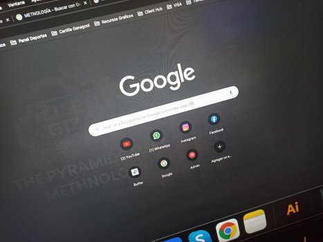

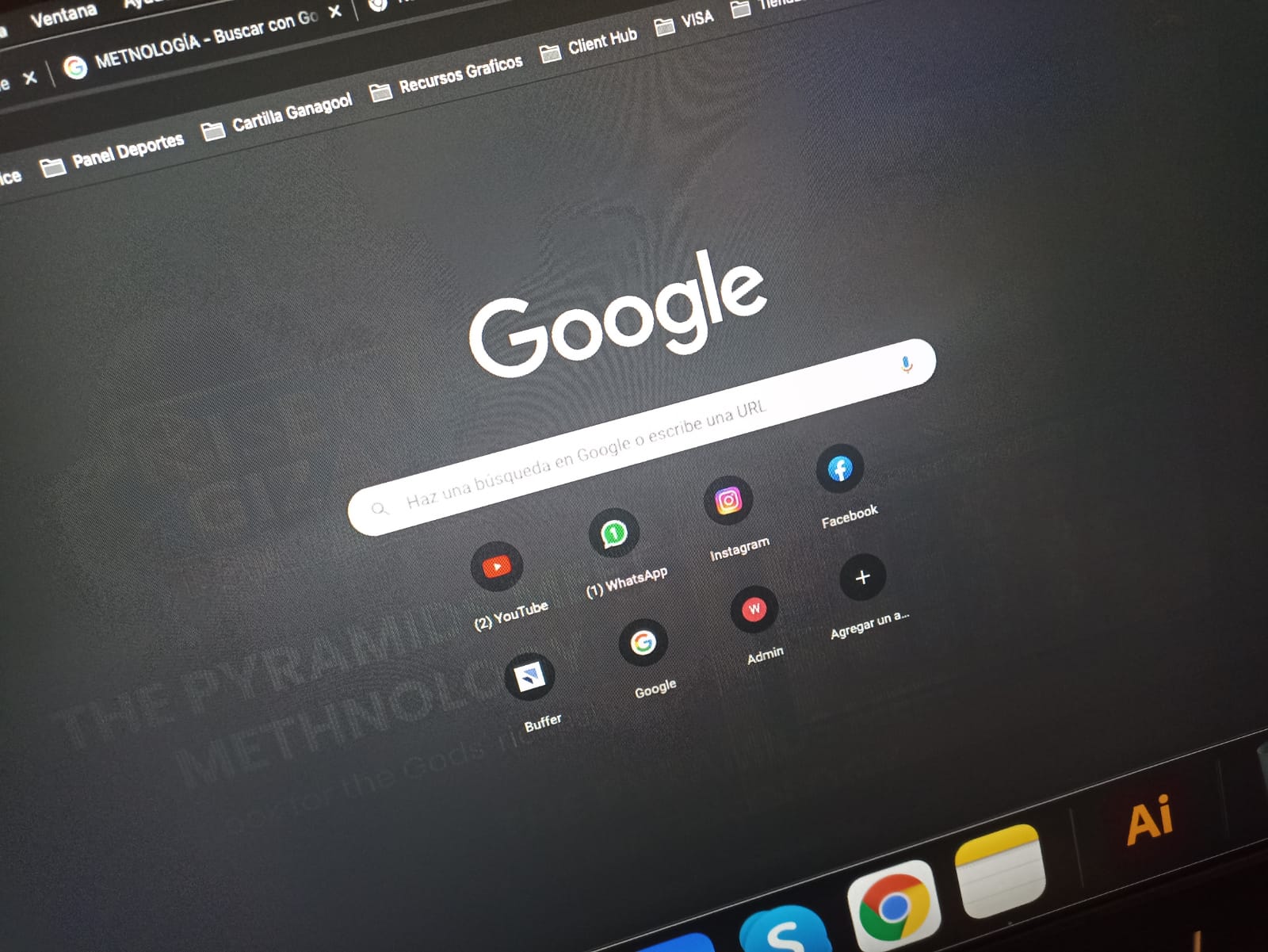

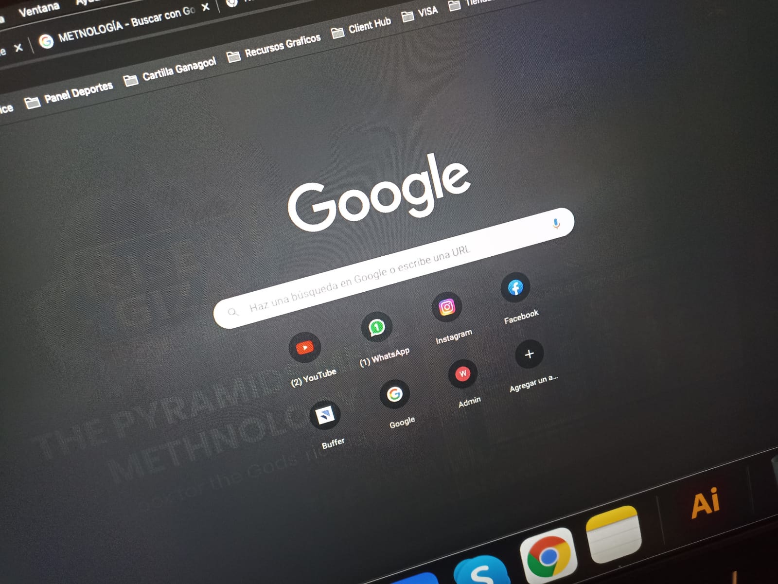

Hi all
I just upgraded to MacOs Big Sur 11.5.2 and the ghost issue persists!
I thought it was just my pc until I saw this forum
my mac is
Mac mini (M1 2020)
Apple M1 chip
8GB RAM
My monitor is a GIGABYTE M27F
I have tried with all kinds of cables and ghost problem appears even when turning off the pc
I leave images
