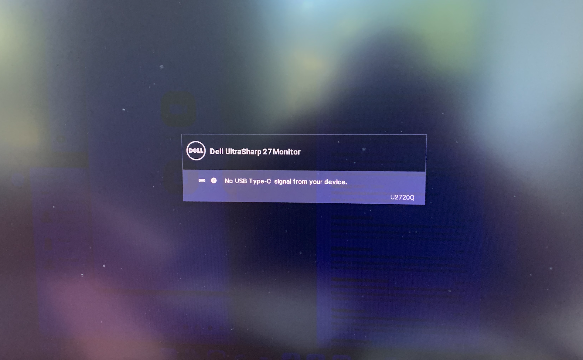

iioewr505
macrumors newbie
May 4, 2021
2
1
I run into the same issue. Beside, I can still see the ghost image after I unplugged the cable from my dell U2720q monitor!

ThisWeatherford
macrumors newbie
May 5, 2021
1
1
Wow my M1 Mac mini with Dell 2720Q is leaving ghosting that retains on the monitor even after I turn off the Mac.
I’ve tried using hdmi and thunderbolt.
This seems like a max hardware issue as my other sources don’t cause this.

iioewr505
macrumors newbie
May 4, 2021
2
1
After I upgrade to 11.3, the flickering issue disappeared. However, when I restart my M1 MAC today, it reappeared. I have to switch to a 1080P monitor for now. So disappointed.
