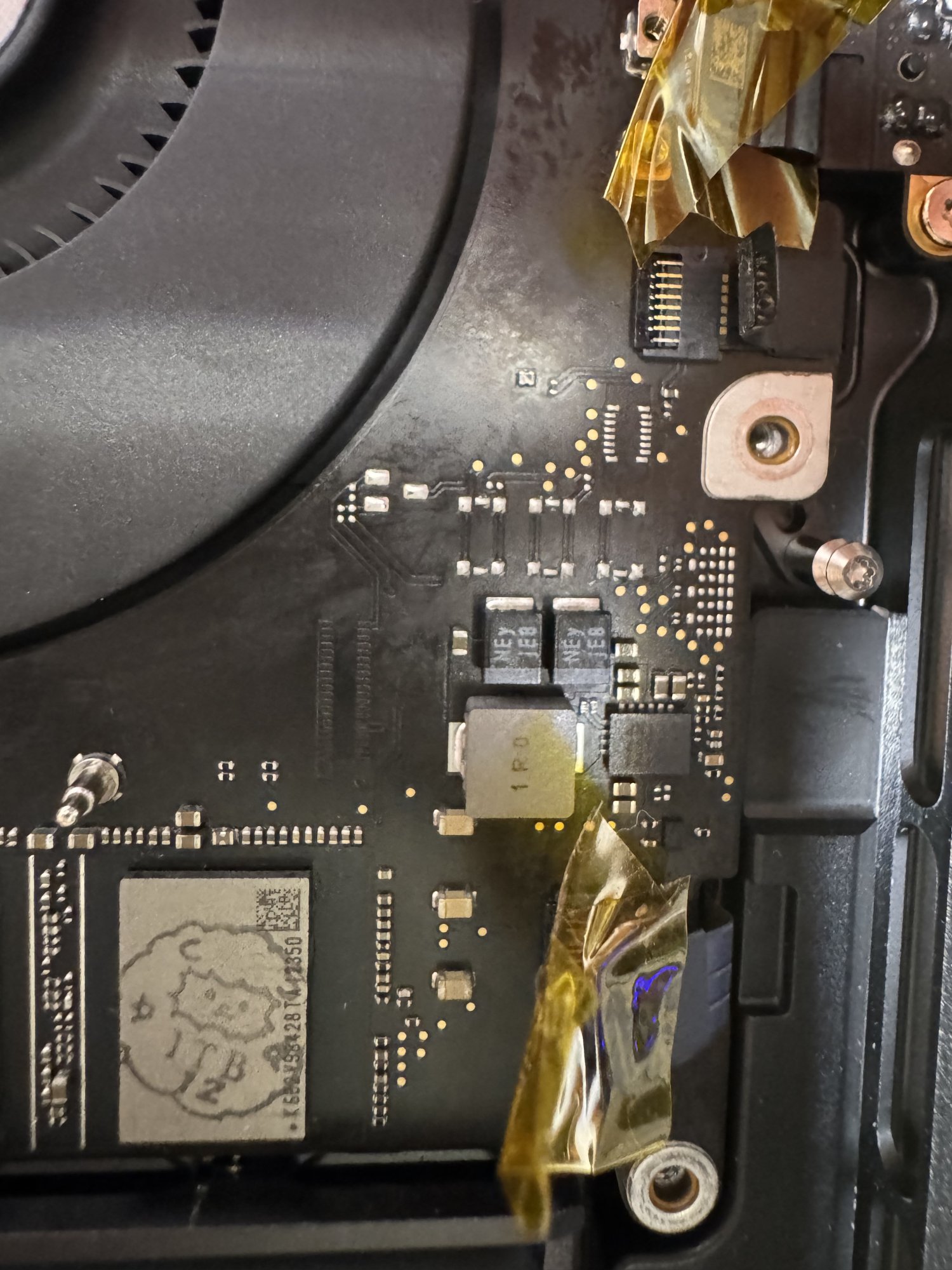

With BGA wouldn't the solder balls just align the chip by itself?Hi,
I was wondering if anyone had any tips on how to align NAND chips to their correct position? I’m attempting to upgrade MacBook Pro m4 pro, the NAND is BGA315. I’ve have good amount of experience with micro soldering etc but I’m stumped with aligning these 315 chips. Especially since there aren’t any components around the chip to help align it. I’ve tried marking/lightly scratching on the motherboard but I feel confident in the alignment still.
Any help/tips would be appreciated.
Yes, but you have to place the chip "close". During manufacturing, they use a pick-and-place machine to place the chip very close to final position and the the surface tension in the solder will self-align.With BGA wouldn't the solder balls just align the chip by itself?
I just align them by hand as best as I can, hope it's good enough and heat it to solder into position. I've only ever had this not work once, with it off by one row. You can easily check for shorts across nearby capacitors, and if there's a short, the NAND is probably not aligned properly.Hi,

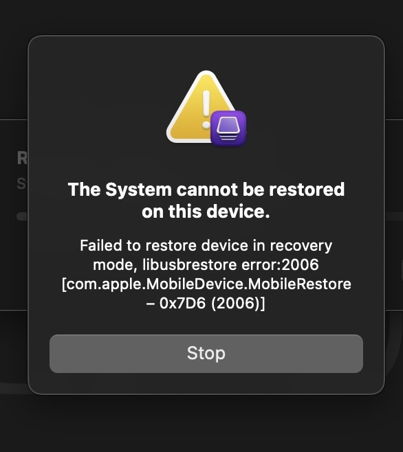

Thank you so much, I managed to get them all aligned but now I’ve run into a new issue. I managed to get the laptop to boot into DFU once using the keyboard method and when trying to restore, I got an error 2006 on Apple Configurator. Any ideas how to proceed?I just align them by hand as best as I can, hope it's good enough and heat it to solder into position. I've only ever had this not work once, with it off by one row. You can easily check for shorts across nearby capacitors, and if there's a short, the NAND is probably not aligned properly.
