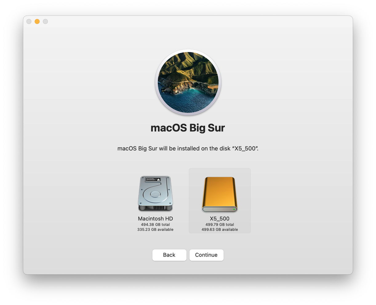

Y E S !!! It IS possible! I've just accomplished it! Update to Big Sur 11.1 on your internal SSD first.
I have a WD My Passport 500Gb SSD plugged into the innermost (closest to the HDMI port) USB-A port (not sure it matters which USB-A port you use, but I'm using my exact results for reference), via the USB-A adapter that came with the USB-C cable for the drive. USB-C doesn't work, whereas USB-A does! Weird!
I formatted the drive as Untitled, APFS (plain; no encryption/case sensitivity), and GUID partition map. I booted up the M1 Mac Mini as normal (not in Recovery mode), and copy/pasted the Installer to the desktop (attempting to drag the installer to the desktop just creates an alias). I ran the installer. When it's done, the reboot process takes a little bit (be patient or just ignore it for awhile), but when it's done, you will get the language request. Time to set 'er up!
I am typing this response from my external drive install and... surprisingly, I'm not noticing any difference. Boot up takes a little longer... maybe a couple seconds? But the rest of the system seems just as fast as before.
So, know that, if you don't want to spend over $150+ on a Thunderbolt 3 drive, you don't HAVE to. Head to Best Buy and get yourself a nice WD My Passport 500GB USB-C drive for about $80 and use the USB-A adapter for it. Install will take a bit longer, but... IT WORKS!!! :cool:🤩🥳😅

Her is how I ended up getting it to work:
I Setup new M1 Mac Mini using internal drive. Used migration assistant to clone external intel drive from my 2018 Mac mini to the internal M1 drive. I then booted into M1 internal drive.
Since the M1 Mac can not use a boot drive that was created from an intel Mac, I had to erase the external drive using disc utility and reformatted to APFS and GUID. You have to do this from your M1 Mac. This is a critical step, intel boot drive won’t work on M1 Mac.
Restarted M1 Mac using the new system restore start up options (hold down power button on the Mac mini until options menu loads) from there I had to change security settings to “low security”on the internal M1 drive. (If you don’t do this, migration assistant won’t work) Then instal fresh copy of Big Sur onto external drive using recovery menu within the startup options screen. (You must instal Big Sur from this menu, you can’t instal it through the App Store).
After an hour or so, the M1 Mac booted from the external drive and I was presented with language selection screen. (Be patient, system will restart several times) From there I continued setup and used migration assistance to clone internal M1 drive to the “new” external drive.
Missing any of the steps above will break the chain that allowed this to work.
