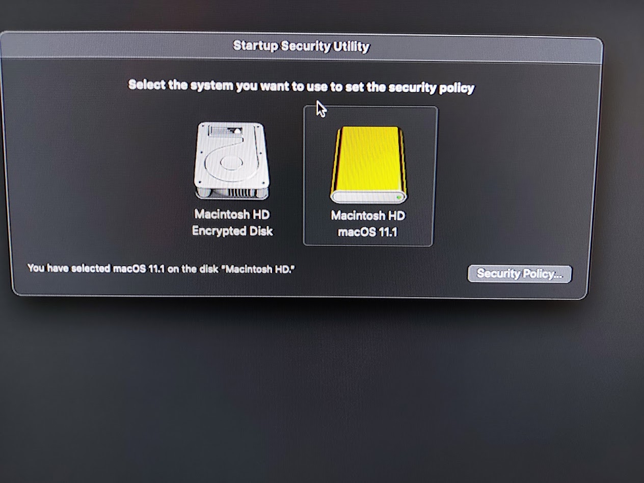

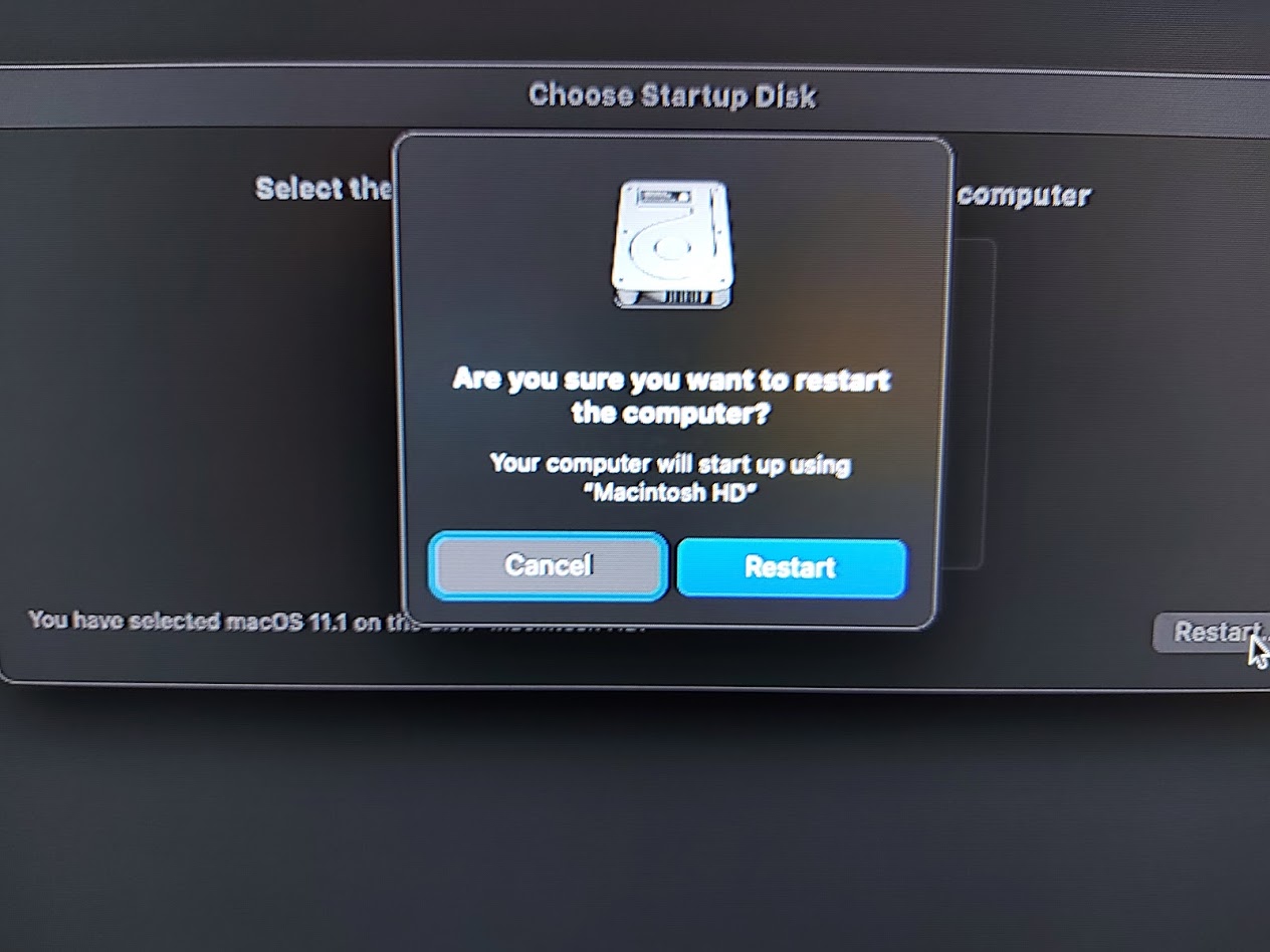

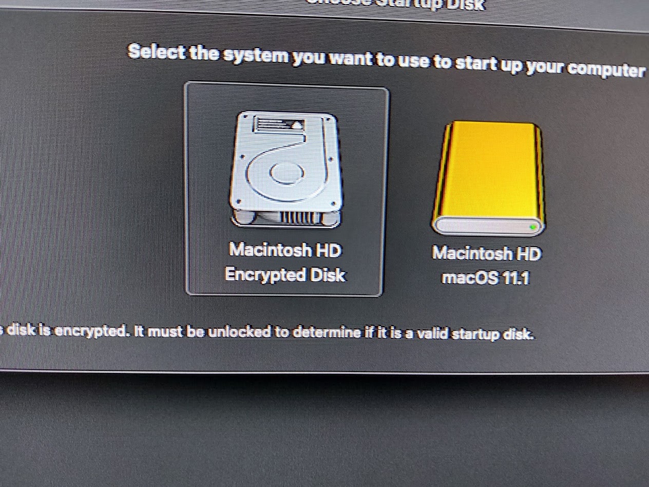

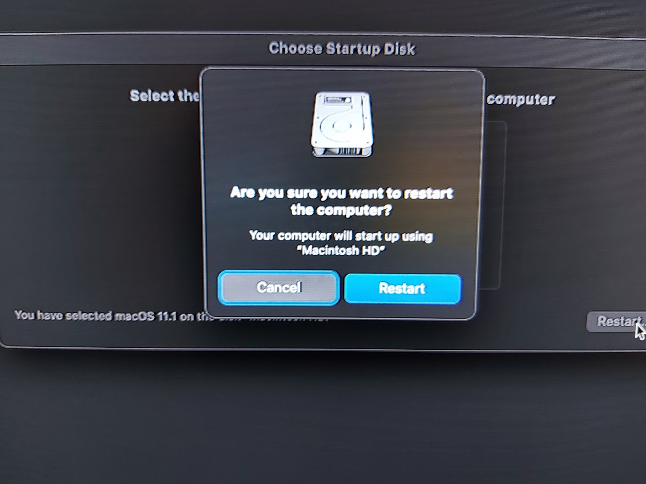

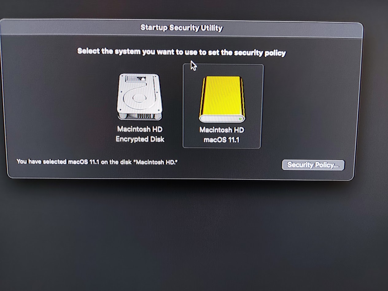

I did it. I went to recovery mode (hold power for about 10-15 seconds when booting). I went to Utilities > Startup Security Utility and changed to Reduced Security. I then went to Reinstall MacOS and selected my external SSD with an empty APFS volume (you can also erase the whole drive as APFS). About 1 hour later it was ready to setup after installing. I can switch without issue between the internal SSD and external SSD in System Preferences > Startup Disk.

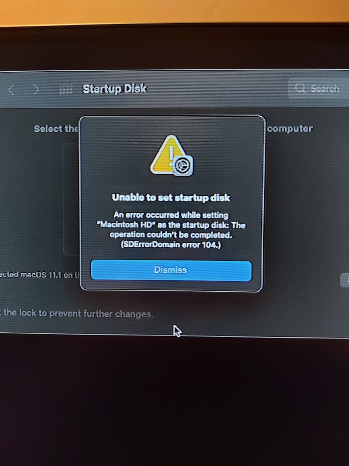

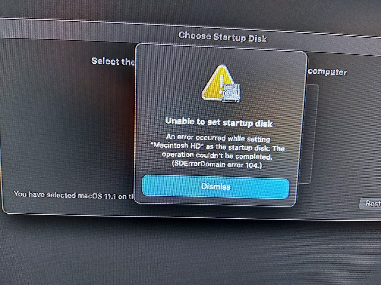

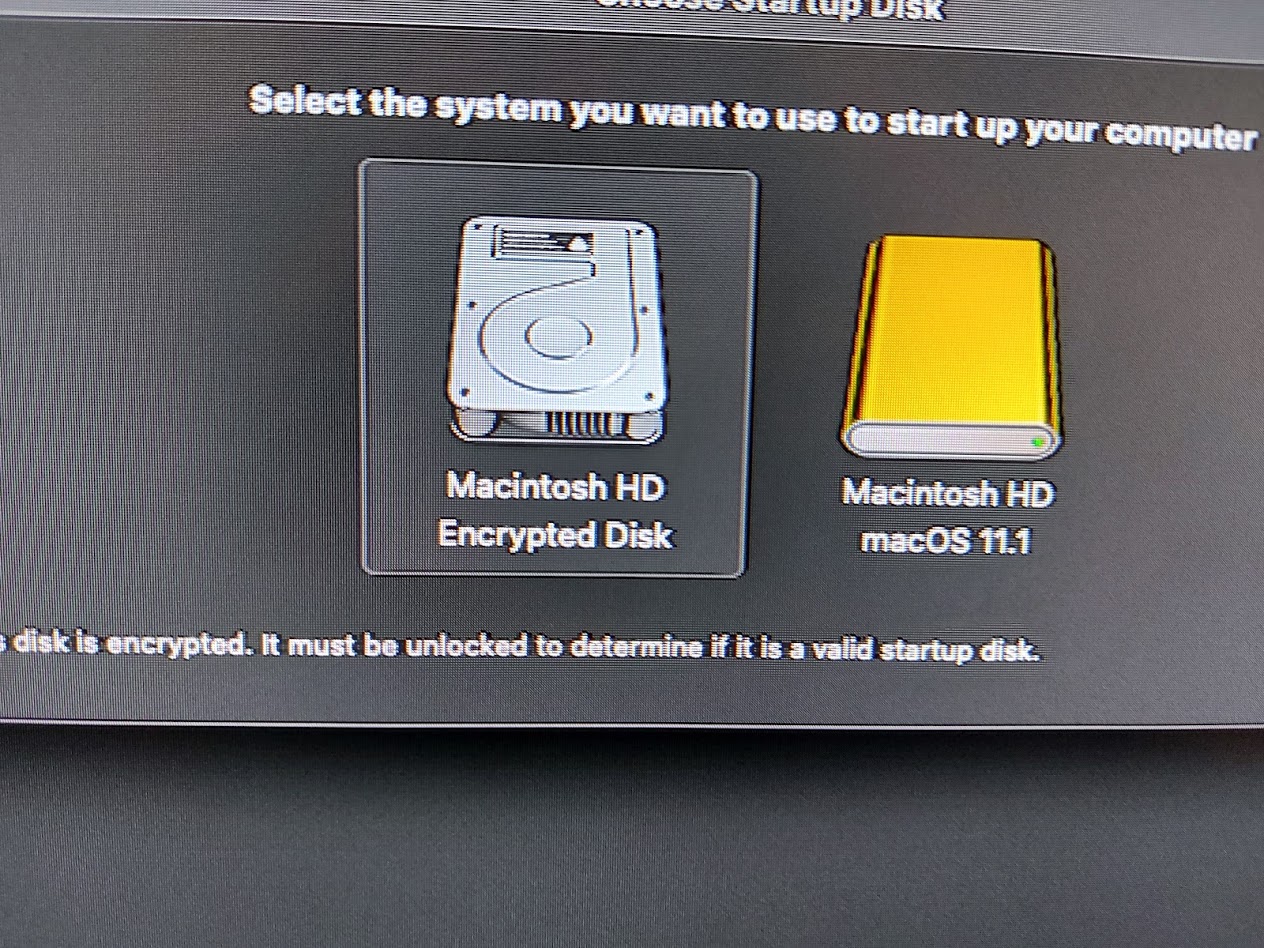

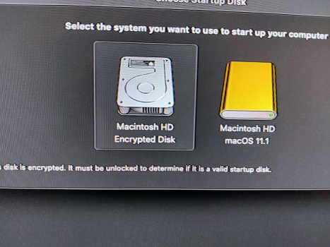

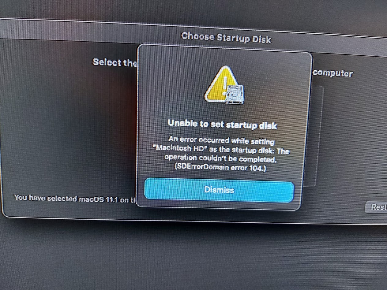

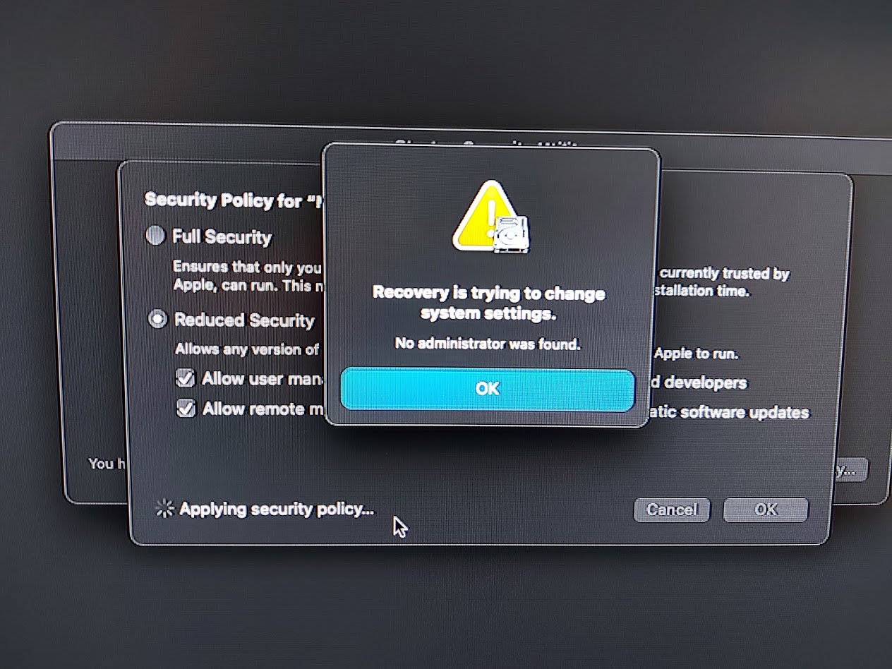

My 256GB with 16gb Ram won't let me downgrade the security. I can't choose the SSD in OSX either as it tells me there is no administrator on the disk.

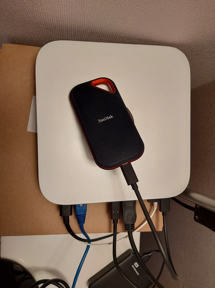

I deleted everything on the SSD, formatted APFS, and deleted all the volumes as well. I installed OSX from the Mac Mini Recovery and installed using USB C 3.1 and USB A cables.
It won't work. I have a Sandisk Extreme 1TB.
That’s what seems to happen when you don’t have a thunderbolt external. I think it is a bug. I’ve tried just about everything I can think of to install on a USB SSD and it doesn’t ever work.

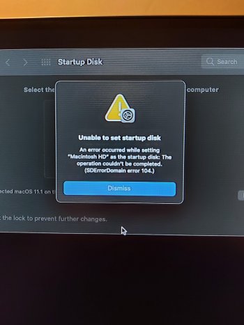

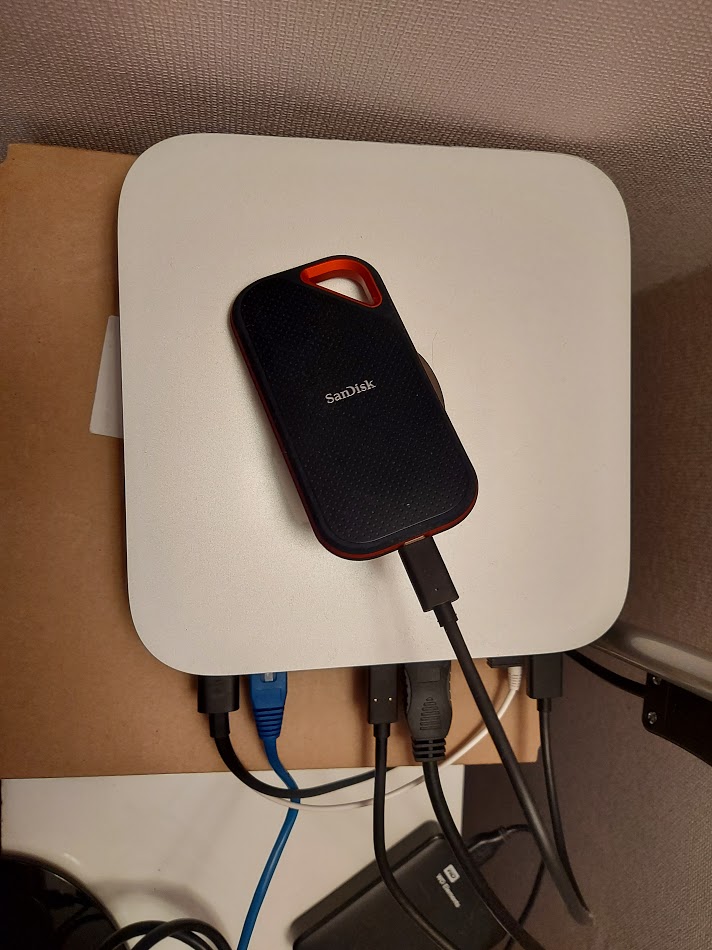

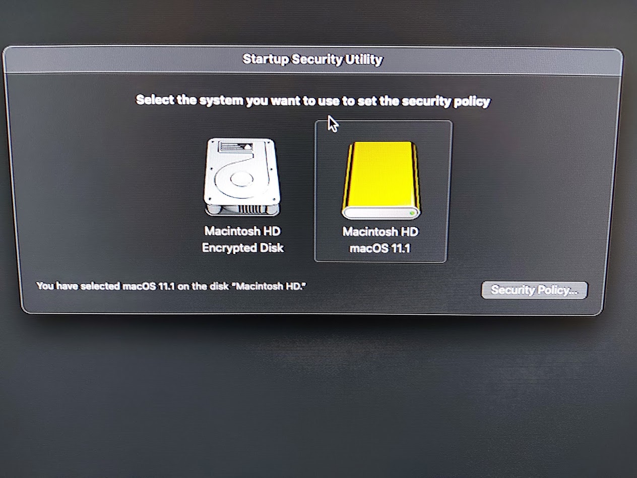

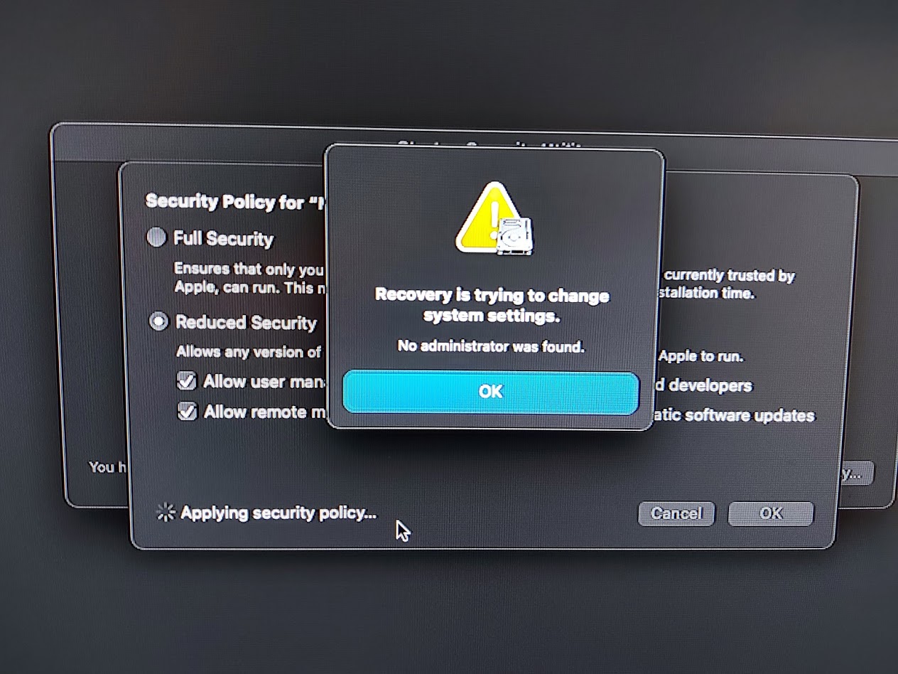

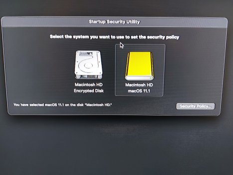

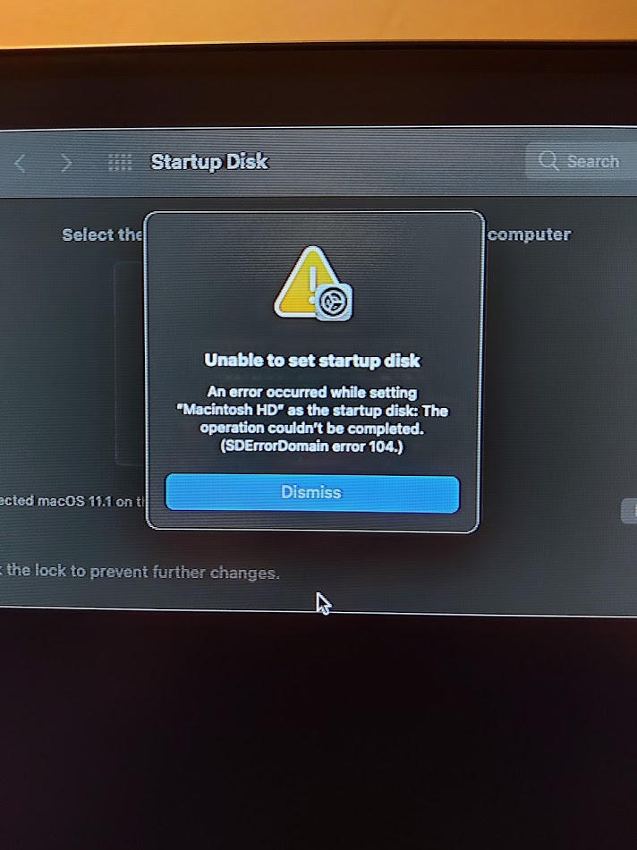

Erase the drive and try again. Use the Big Sur.app GUI installer inside macOS on the Mini. Your drive should work just fine. If not try direct USB-C to USB-C
