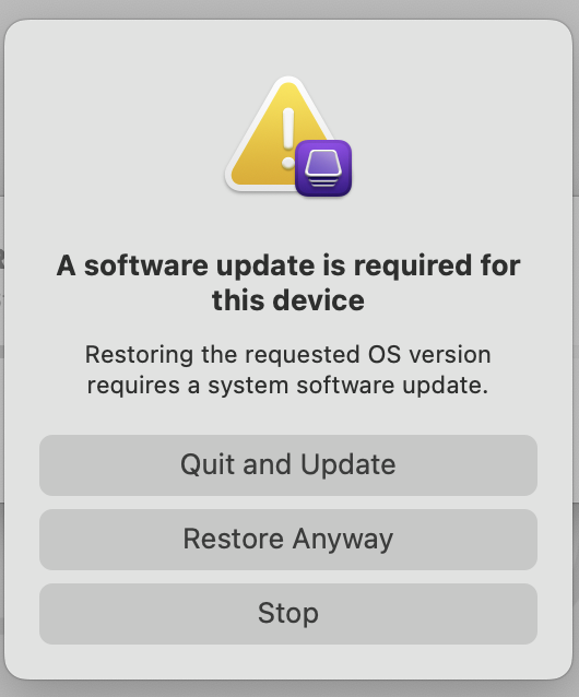

Tried the "revive" route, since I need the files. (Yet another life lesson in backing up regularly) Got into DFU but around step 3 got presented with "A software update is required for this device." Not immediately clear which one the modal is talking about (DFU host vs bricked). Options are "Quit and Update", "Restore Anyway", "Stop". Selected "Restore Anyway" since I didn't want to risk bricking host (M1 13.5.2) as the brick (M2 13.5.2 -> 13.6) updating is what precipitated this snafu. DFU revive completed on host. Problem machine rebooted, requested authentication (user login password), got authenticated, rebooted, presented with disk select (and options) boot menu, selected HD (only the one "Macintosh HD"), rebooted, and back to black screen. No exclamation point, no nothing.

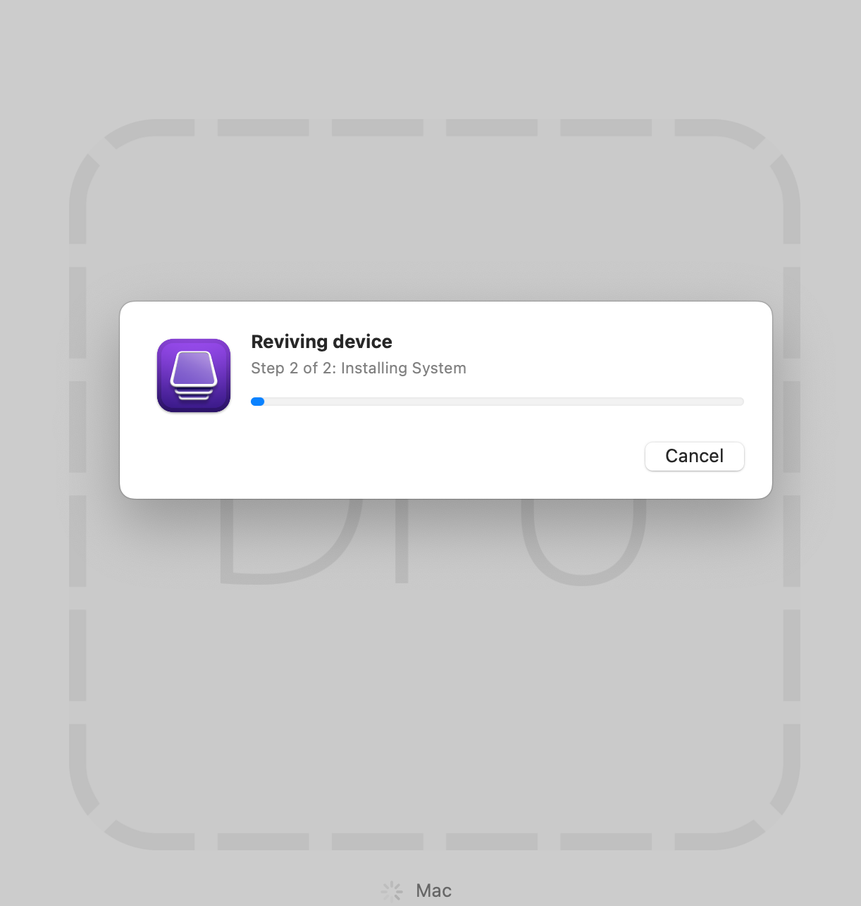

Trying the ipws drag and drop revive route now. Bricked machine looks to be restoring. Mac boot with logo loader doing something. We shall see.

I used an old mba 2015, a usbA-usbC cable and the apple configurator. I had the update required popup so i updated and started again.
You don’t have to select the main disk. I did the same! You have to go into options and install sonoma (the only chance i had… i think it tried to install both sonoma and ventura, wiping the fw)

Had this same issue, and reviving then updating to Sonoma fixed it (without data loss). For the revival process rumor is that success is better if done from a t2 machine over usb-c, and machine with apple configurator should be running os13 or os14.
I ran into the same "software update is required" error message above in the thread, and hit "restore anyway" and it seemed to work to boot into recovery. From there I'd recommend backing up things as needed via terminal, then proceeding to upgrade to Sonoma. (Unfortunately I don't think there's a way to stay on Ventura without wiping data).

After two weeks with a bricked computer, I finally figured out to get it up and running without losing (almost) any data. In case anyone else finds it useful, here's what I did:
1. Using a USB 4.0 cable, I attached my 16" M1 Max MacBook Pro (bricked) to a functional M2 MacBook Air 13" running macOS 14.0 Sonoma (this did not work until I upgraded to Sonoma). For some reason the cable needs to be plugged into the leftmost port on the left side of both machines.
2. Opened Apple Configurator on MBA. Booted bricked machine into DFU mode by holding power, right shift, left option, and left control combo for 10 seconds (took several tries to get the timing perfect).
3. On the MBA, right-clicked my machine and chose Advanced > Revive.
4. Waited for the Revive process to finish, bricked machine booted up, showed my username. Asked me to type in my password. I did that, it blacked out and rebooted.
5. After the reboot, it asked me to log in again. Did that, it gave me two options: On the left, the name of my drive, on the right "Options". Clicked "Options".
6. Got the option to install Sonoma. Tried, but not enough disk space available.
7. Quit Sonoma Installer and opened Terminal. Navigated to my Downloads folder and deleted it, which gave me enough space to install Sonoma.
8. Quit Terminal and opened Sonoma installer, ran that, finally got in.
Prior to this, I tried reviving the machine several times to no avail. Clicking "Options" (as in step 5 above) only caused the machine to reboot, show the Apple logo, and black out. I tried reviving using ipsw files for 13.4, 13.5, 13.6, and 14.0 via Apple Configurator, but nothing worked until I upgraded the M2 MacBook Air to Sonoma.
