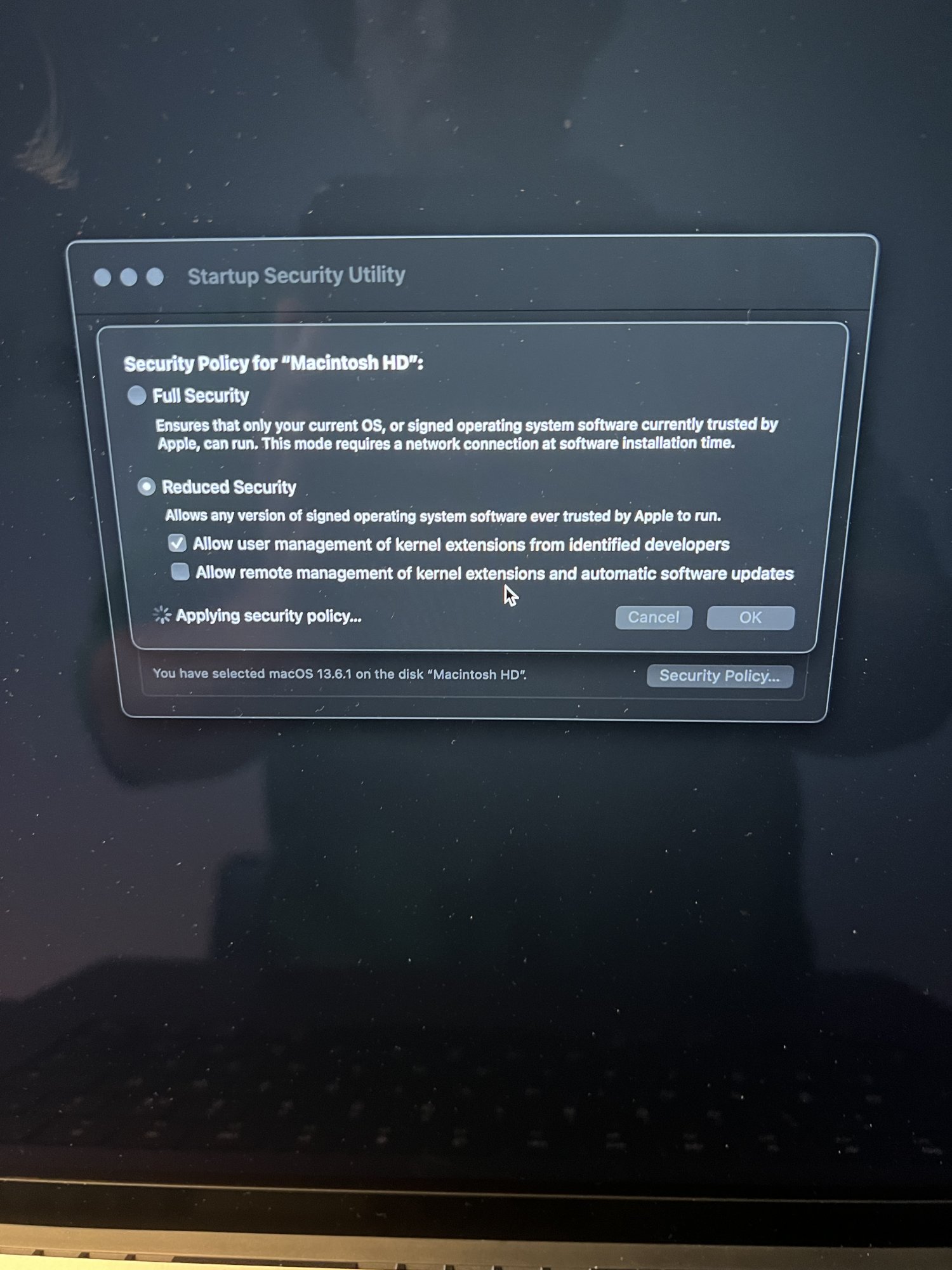

For me happened again from 13.6 - 13.6.1 .... DFU to get into Recovery (using 13.6 IPSW which is only available) and from here now I am trying to do Ventura fresh install from Recovery Options ... Or they didn't fixed that problem in 13.6.1 or Logicboard is bad or some software is breaking the update (need to try clean install of 13.6 and update to 13.6.1 ...)
Has some of you this securety disabled and set like I do ? I made clean install of 13.6 without installing anything and update to 13.6.1 went through normally on same macbook ! It is defenitely something like this or some SW is bricking when update !
