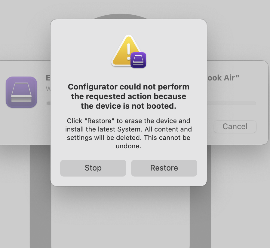

@mcscot @mrj412 - I have the same issue on an Apple silicon MBA.
I've tried following the process at https://support.apple.com/guide/app...ore-a-mac-with-apple-silicon-apdd5f3c75ad/mac but I must be doing something wrong.
I'm using an Intel based 2020 MacBook Pro to run Apple Configurator 2 and this is connected to the Apple Silicon MacBook Air.
I followed the key combination on the Apple silicon Mac but I'm not sure it is getting into the right mode. The Apple COnifgurator 2 app seems to see the device but whenever I try to do any actions on it it gives the below error
any ideas what I'm doing wrong?
thanks
rich

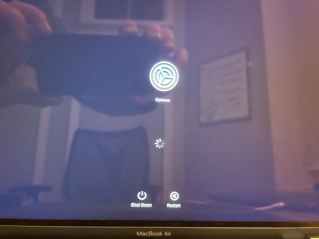

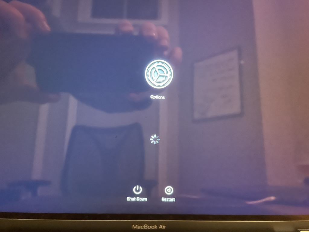

Nope, still cannot get this thing into DFU.
Firstly - there will always be something on the screen on the Apple Silicon Macs when I do the keystroke combination - it bascially powers on the Mac however many times I try and ways that I do it. I'm following your instructions exactly and apples instructions.

A message comes up that says "Continue holding for start-up options". A lock image shows up in configurator rather than the DFU image. With the lock image up, nothing I've tried works. How do I get the DFU image instead of the lock image?

Glad you see it. But I don't see it. HOW DO I GET MY M1 MACBOOK AIR INTO DFU MODE? Please? Help me...
Doesn’t matter. Even if you see the insurrections - which are basically the same as the apple instructions - I have not been able to get the M1 system into DFU mode. I’ve tried for hours.... don’t understand how others have done it

Wow somehow my Mac air M1 does not go into DFU mode with the above exact same process. It just powers up into options screen. Tried now probably a million times!
Strange. On the Mini disconnecting the power and leaving for a little bit (doc says at least 10 seconds) seemed to do the trick for me (my first attempts clearly were too quick).
