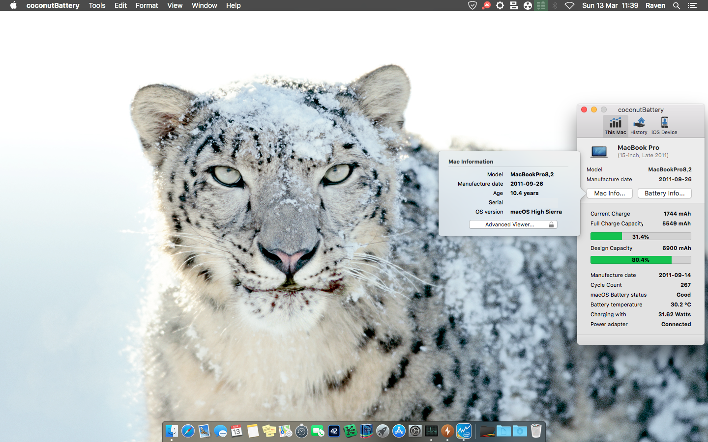

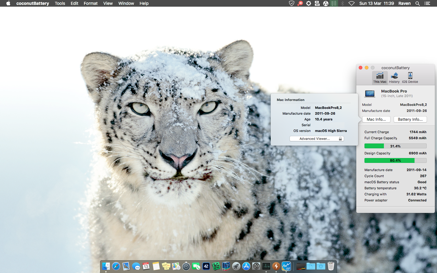

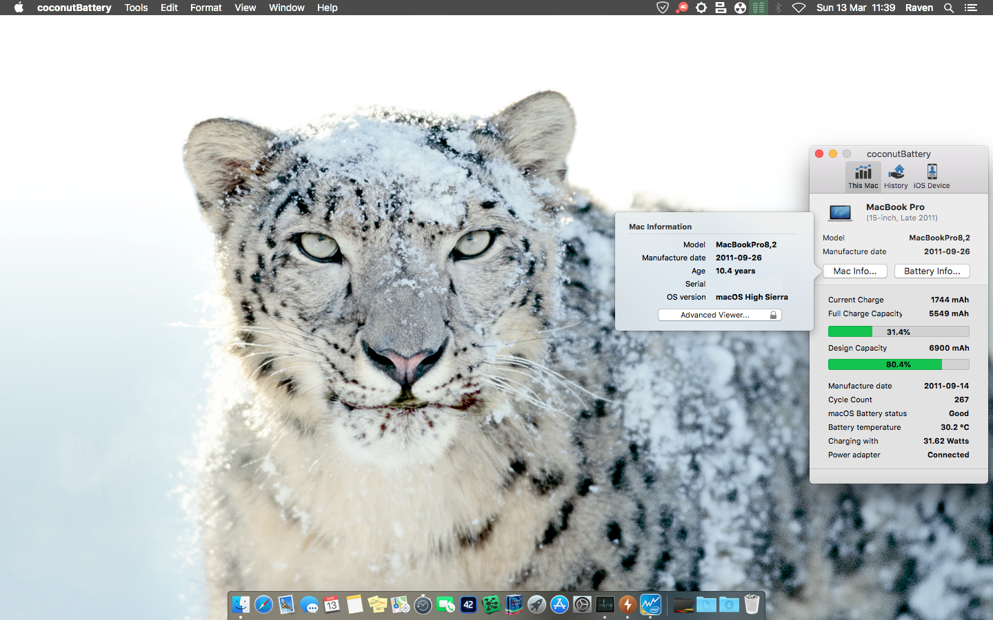

Way entertaining thread guys 👍 Anyone worried about the temps of Apple's Silicon has to be new to the Mac 😛
100% stock including the battery, runs well and truly owes me nothing. These pre Retina 15" MBP's run hotter than hades 🔥🔥🔥 to the point you learn not touch the chassis in certain places...

Yup. My old 2011 didn't die of heat death despite its best attempts, it was the pre-ordained GPU failure due to manufacturing defect. The CPU and the rest of the machine is still working today. I just decided I like the 13" form factor better and discrete GPU reliability/heat less, so upgraded. Twice now. Machine still works.
The new M1? No need to alter fan curves as it is mostly silent... there's plenty of thermal headroom but apple have decided that the 100C reading, as measured by the hot spot on the M1 Pro (vs. whatever the measurement is on the intel chips - likely different) is fine.
As they've designed, built and presumably tested the things and I have AppleCare.... I trust their judgement.
