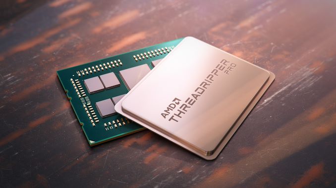

Because that's how the industry works. Apple is doing it, AMD and Intel have been doing it for decades.
It takes time to develop and build around the A14 Firestorm and Icestorm cores. It takes a couple years to enhance the A15 Avalanche and Blizzard cores.
Workstation chips always come last, desktop and mobile first. It's only today, March 8 that AMD is launching Zen 3 based workstation chips. The architecture was launched in November 2020, same time as M1.

Zen 4 is an architecture. As I mentioned, it'll take about 2 years before it flows up to the workstation and server products. AMD just announced Zen 3 workstation processors, today.
Alder Lake is not for server or workstation. Sapphire Rapids is the correct code name. It won't arrive until later this year and is based on Intel 7.
The HEDT market is DEAD, their Zen 3 Server products (Milan) are in service for almost a year now, and Zen4 Server chips(Genoa) will ship THIS YEAR. The competition is real.
