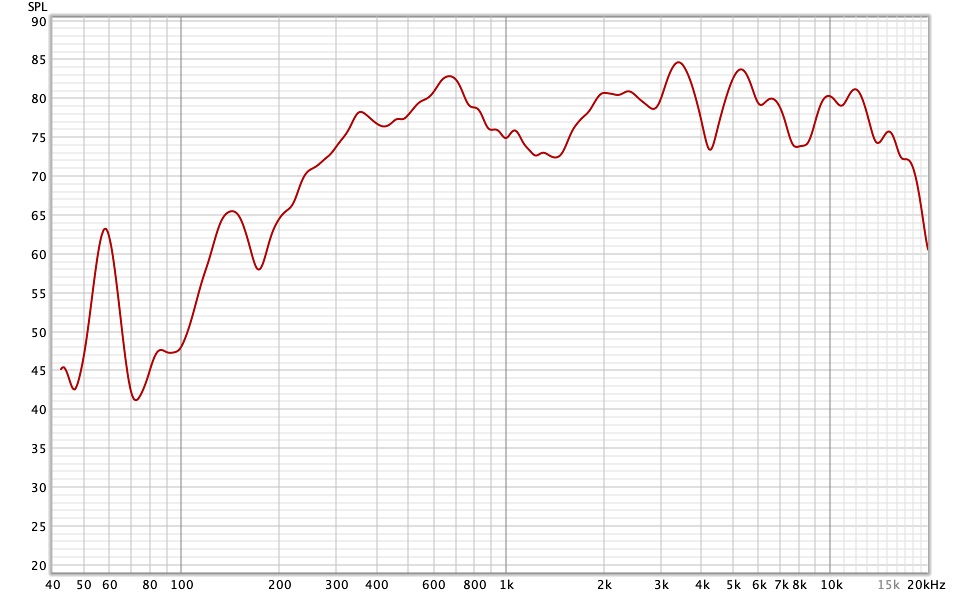

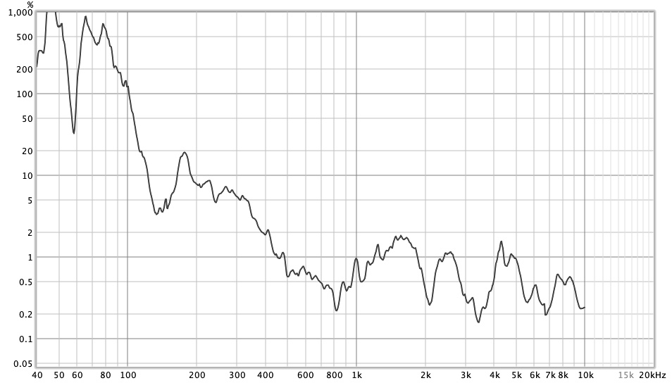

While the MacBook Air M2 speakers sound good for such a thin device, I noticed what I thought was a fair bit of colouration caused by uneven frequency response in the low-mid midrange.
Actual measurements suggest that this audible colouration stems mainly from a dip in amplitude response from about 800 to 1.9 kHz. A fair bit of harmonic distortion in the region of 150-350 Hz may also be a contributing factor. See the informal REW measurements below.
Measurements were taken for L+R speakers with a UMIK-1 with 90deg calibration file applied. The mic was located at the approximate ear position for an operator seated at a desk.
I have no measurements from any other MacBook variant for comparison.

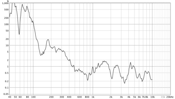

Are you an audio engineer? Your tests sound very objective (instead of subjective with ears). Would love to have data like these with other MacBook Speakers as well.
Also, is it possible the "harmonic distortion" and "colouration" be negated/fixed/go away/improve with software update from Apple by adjusting the speakers EQ or whatever sound engineer do with the way it makes sound. Or is it a physical kind of thing that requires redesigning the chassis/speakers?

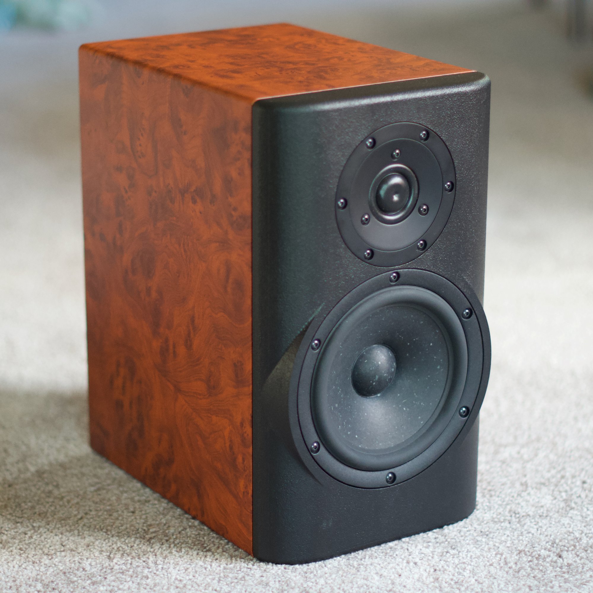

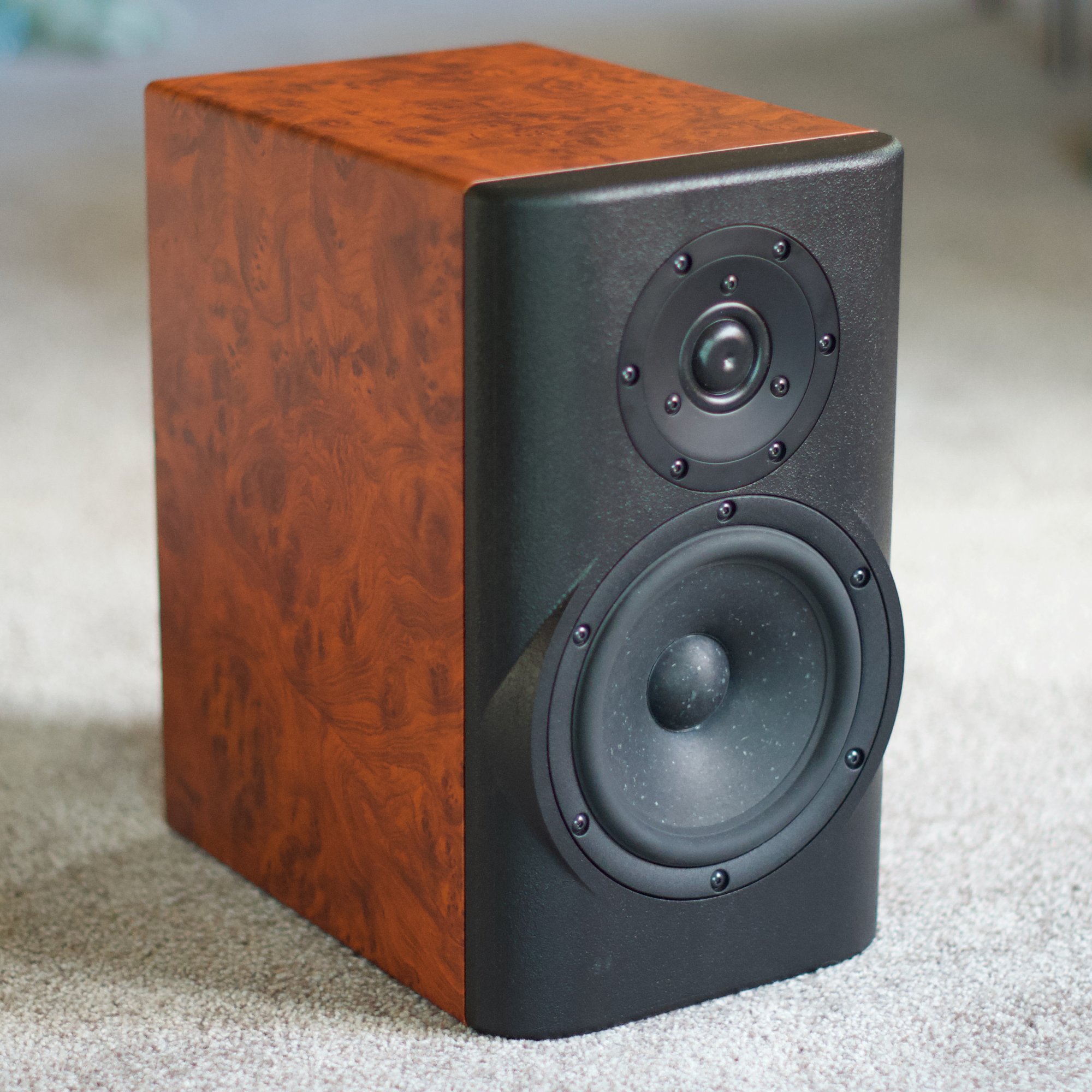

I'm a mechanical engineer. I suppose shock, vibration and acoustics would be some areas of practical knowledge. I have done some sonar transducer design and do some HiFi loudspeaker design/build projects (example below).
The harmonic distortion here would be caused mainly by mechanical non-linearities and and wouldn't be fixed with equalization. Regardless, equalization can largely abate audible colouration.
Bear in mind the measurements were informal - the arrangement, alignment, physical objects, display angle, distances, etc. between the laptop and the listener will all affect the measured response. Output of the MacBook Air M2 speakers below about 100Hz is so low that distortion measurements in this range are meaningless. Both L & R channels were simultaneously driven so comb filter effects will be present in the amplitude response.
Physical limitations greatly restrict the performance envelope. I would say there are obviously some clever engineers at Apple doing a good job at making these MacBooks sound as good as they do within these limitations and at reasonable cost.
