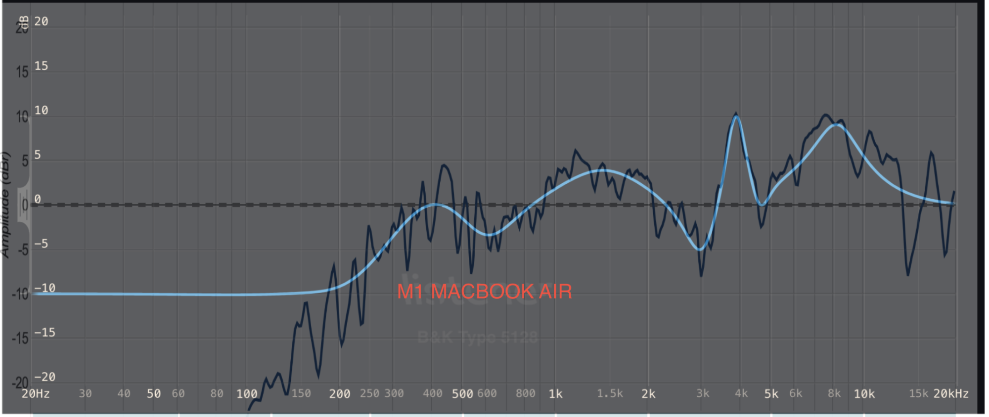

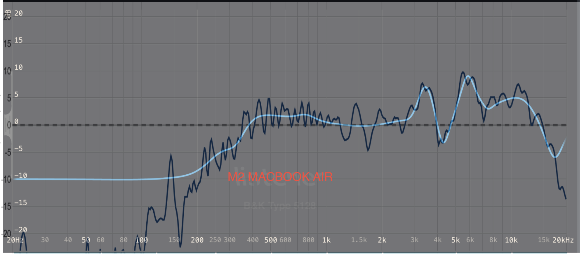

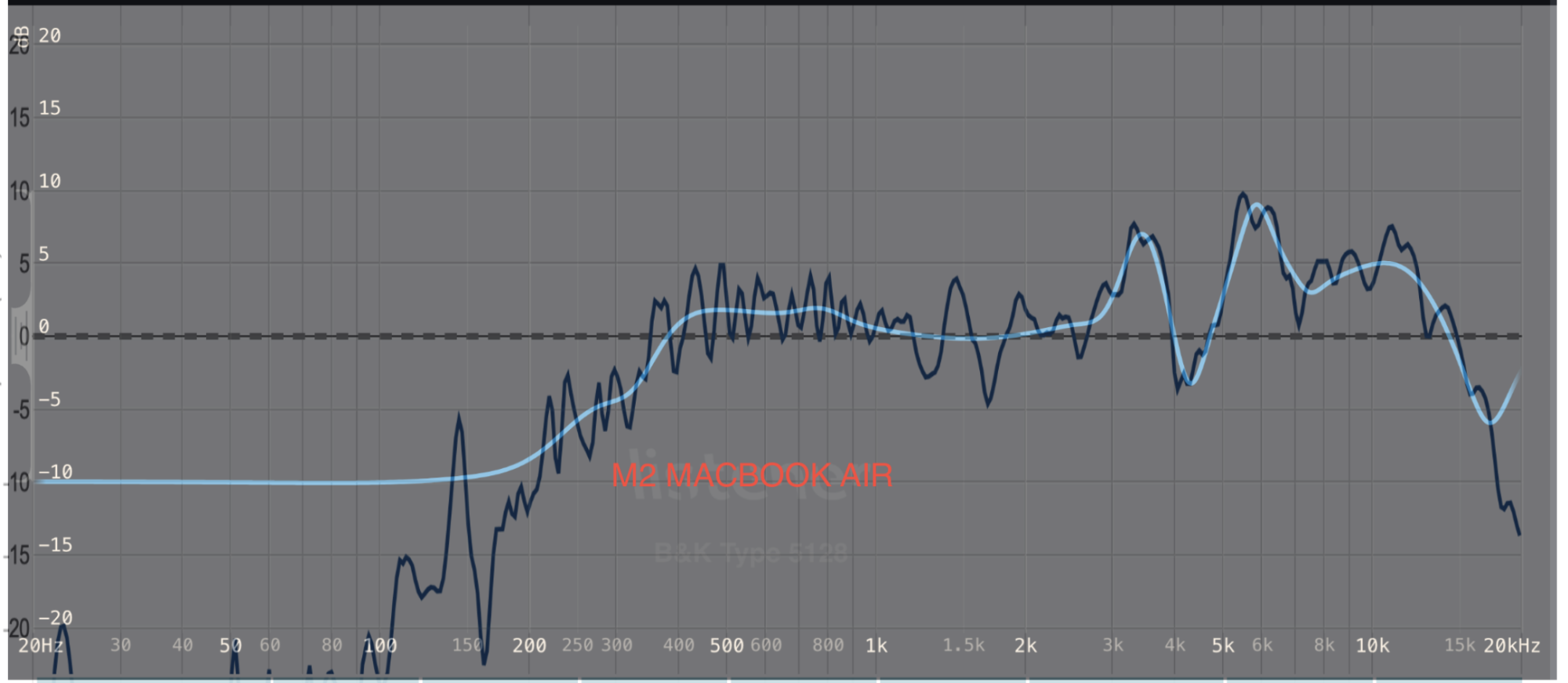

I made a parametric eq profiles for both the M1 and M2 Macbook 13 inch airs to Rtings's measurements:
You can use "Sound Source" or "EqMac" to use these profiles.
NOTE:
-You may experience rattling on the M2 macbook at max volume using this eq profile
-You can decrease the gain on the bass shelf for both profiles if you want more volume
View attachment 2326521 View attachment 2326522
NOTE:
Wow thank you for your results in this old thread. Do you have the results for the 15" Air as well?
From your results it looks like the M1 and M2 Airs speakers are good and different in their own ways. Hence why they sound different and is hard to decide which is clearly "better".

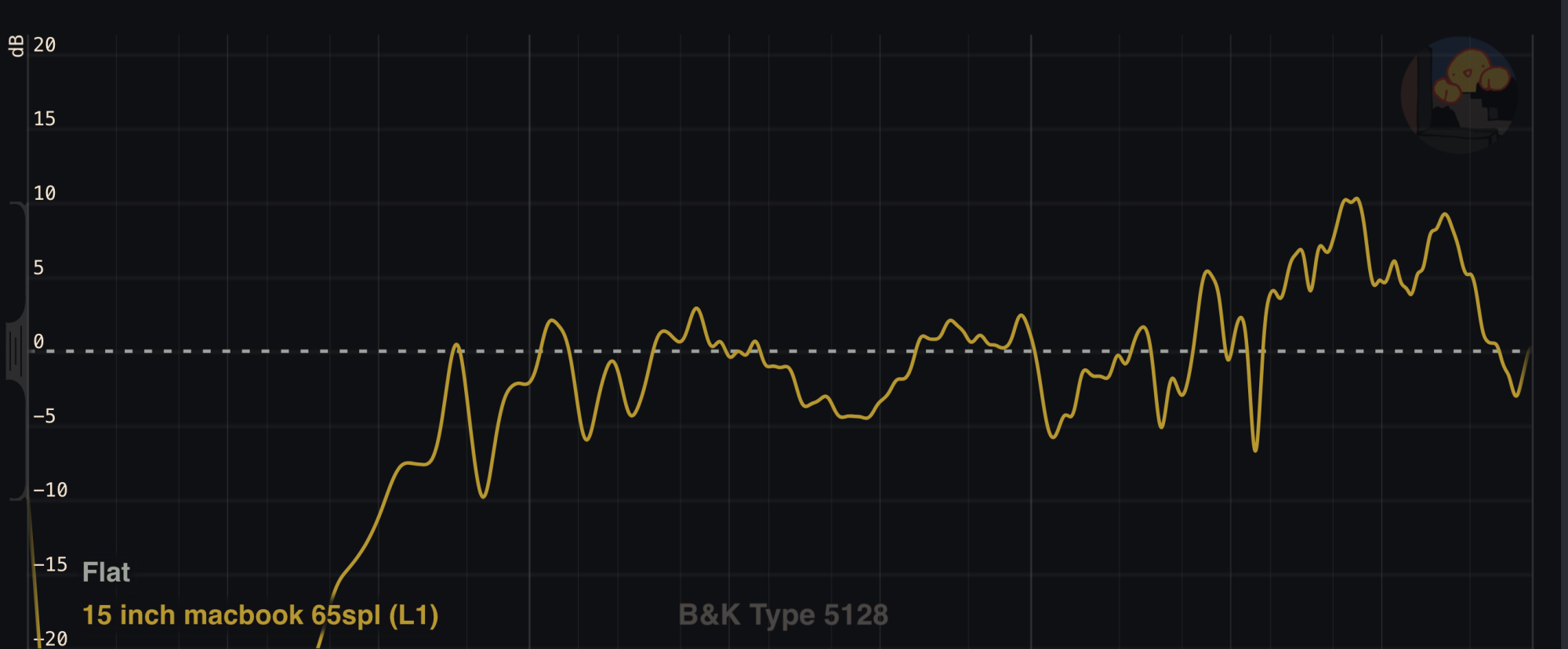

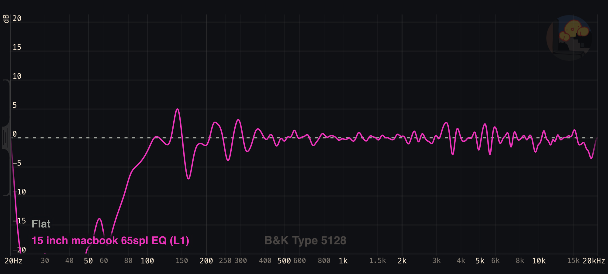

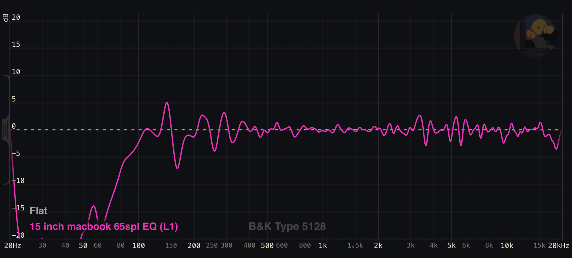

Objectively the 13' M2 macbook Air should sound better as it is slightly flatter (shown in the graphs). But hearing them side to side, I will say that the m2 sounds alot better. The M1 just sounds too hollow and it has this weird 3D effect that i find quite distracting. I think the M1 uses some sort of spatial surround sound trick to make it sound "wider" and the M2 to a lesser degree. Also i made a M2 15' Macbook air eq profile for you!! I wasn't expecting the frequency response to be that good for a laptop! This is based on Rtings.com measurements.
Before eq:
After eq:
After applying the profile you should notice:
- more bass
- fuller vocals
- less sharpness
The eq profile can be downloaded below
  • 15 inch macbook 65spl Filters.txt
Before eq:
After eq:
- more bass
- fuller vocals
- less sharpness
Ah so the M2 speakers are more capable in doing a flatter frequency response. That is nice to hear.
Thank you for the eq! Is this eq safe to put volume higher than 75% (or max) without damaging the speakers?
Surprised to see the 15" doing this good! Do you think the 15" air has the most capable thin and light laptop speakers on the market? I am planning to swap my M1 to M4 15" when it comes out.
I wonder why apple does not "eq" their speakers to produce the best sound (and flattest) possible before shipping them.
Yes it is 100% safe, apple has built in clipping protection. The size of the physical speakers are small and are akin to the drivers found inside of a headphone, meaning that it is less prone to damage from clipping. Other than that, you may experience slight crackling or popping at higher volumes. Also i have an updated eq file of the m1 and m2 13' inch Macbook airs that sound better and allow for higher volumes.
I Assume apple doesn't apply an eq profile for all of their laptops is due to speaker design limitations, reduced volume and possibly because they want to differentiate the sound quality between their Air and Pro Laptops.
The 15' macbook Air with the eq profile could absolutely beat the 14' and 16' pro laptops in sound quality with maybe less impactful bass due to limitations.
  • M1 Macbook Air 65db SPL [Rtings].txt
  • M2 Macbook Air 65db SPL [Rtings].txt
