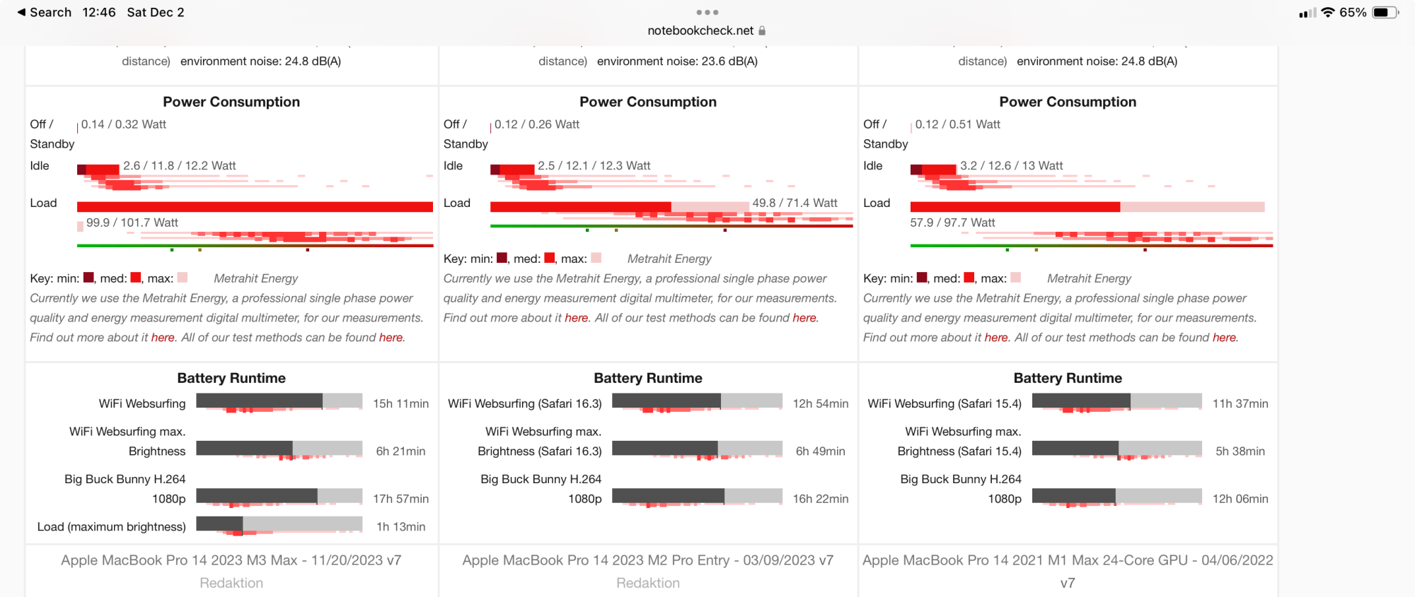

In Notebookcheck.net tests, the 14” M3 Max (40 core GPU config) has longer run times on playing a h.264 video and on their web surfing test than both the 14” M1 Max (no surprise) and 14” M2 Pro entry level (surprised me). I don’t think that they did these tests using low power mode. So, M3 Max chip does pretty well in terms of battery run time.
