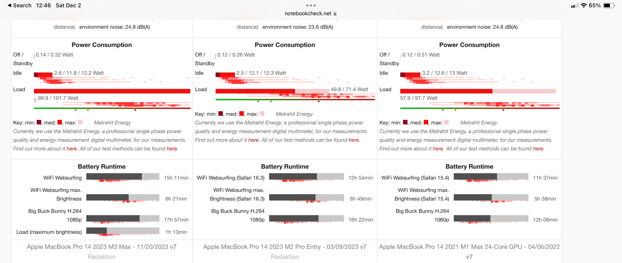

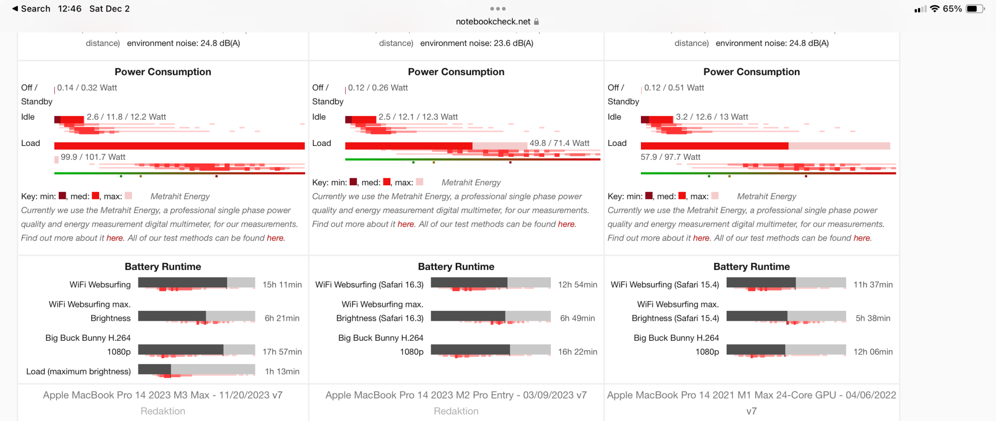

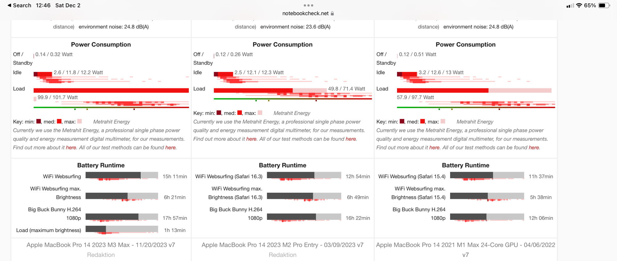

In Notebookcheck.net tests, the 14” M3 Max (40 core GPU config) has longer run times on playing a h.264 video and on their web surfing test than both the 14” M1 Max (no surprise) and 14” M2 Pro entry level (surprised me). I don’t think that they did these tests using low power mode. So, M3 Max chip does pretty well in terms of battery run time.
These are actual facts... users here just want to whine.
