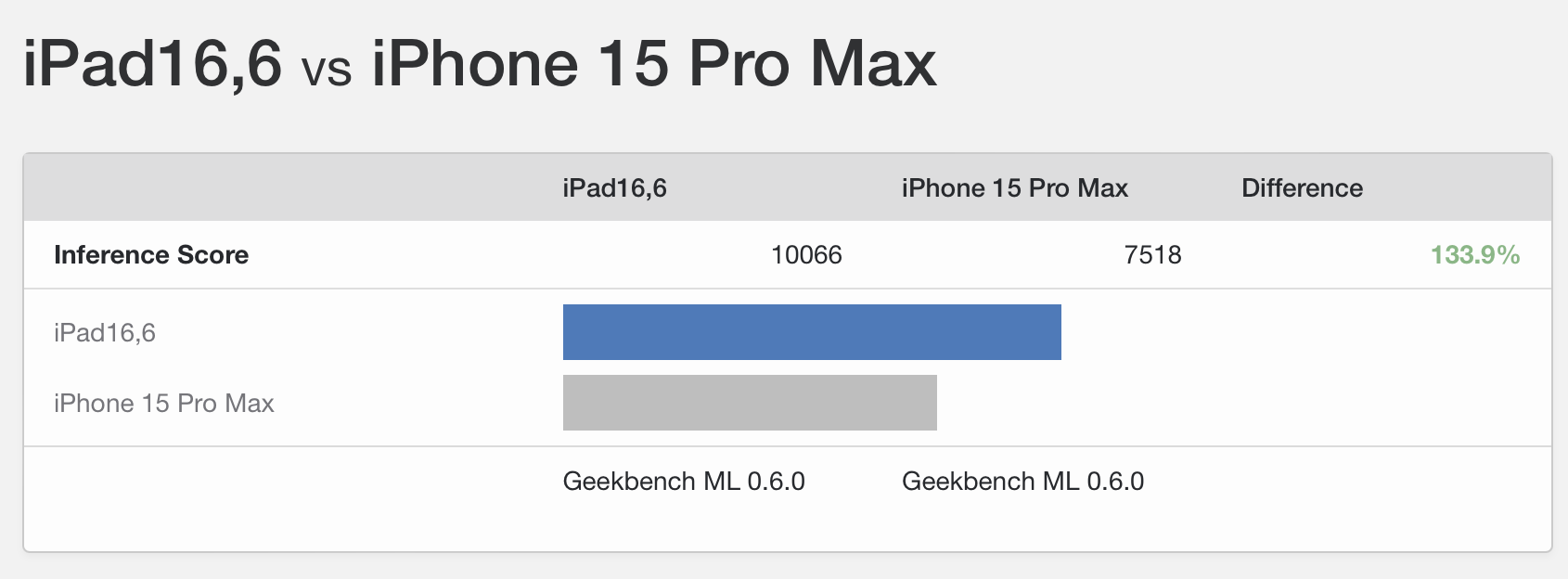

the miracle of ios 18 on neural engine ,hoping for the same results on M4 ne with sequoia
I'm guessing it will be like the M4 in the iPad Pro 🤷🏼‍♂️
Here is an example.
Of course those are very nice boosts 🙂,
but do you know for sure that the boosted benchmarks (ie the Transformer text based ones) are running on ANE?
The 32bit GB6 benchmarks always run on GPU and in the past I think the same was true for all the text benchmarks.
If you run restricting GB6 to GPU+CPU (no ANE) do you get different results?
My guess is what we are seeing is combination of the stateful support in CoreML (so more efficient use/update of KV cache) and the fused dot product attention (which is an MPS optimization, not an ANE optimization). Plus of course various other tweaks and improvements.

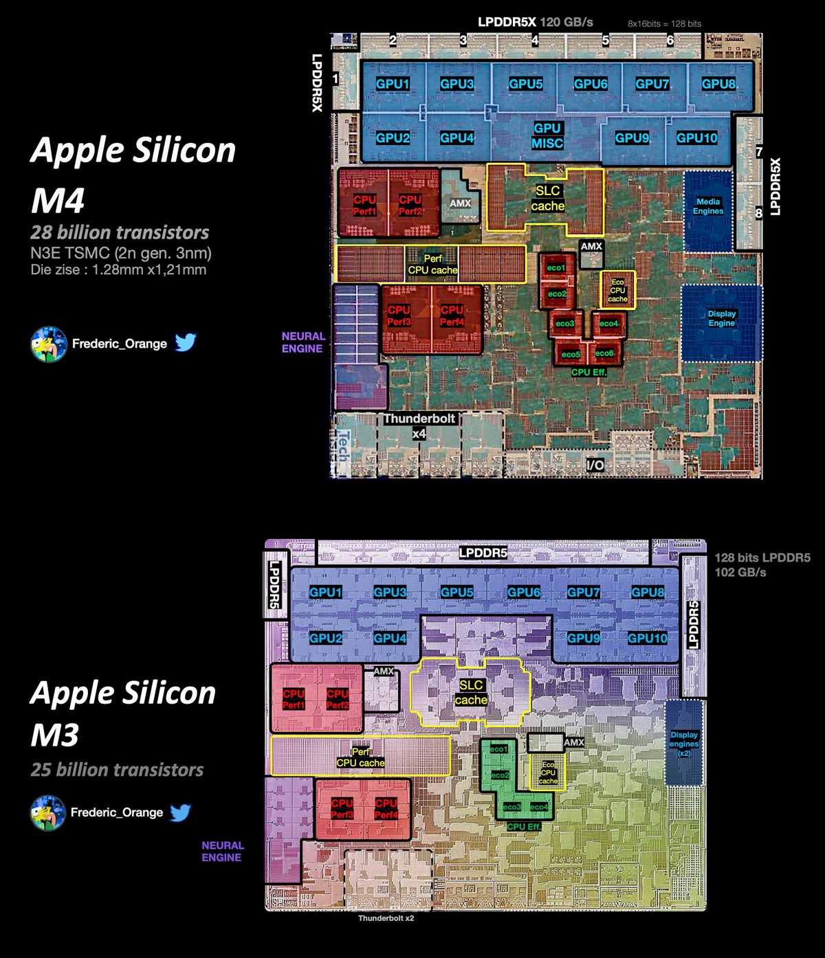

The Four x TB ports on the M4 die shot look almost identical to the Two x TB4 ports in the M3.

Ah I see. Is this die shot of the iPad Pro M4? And is it thought that the M4 that goes into the iPad Pro is likely to be the very same one that will go into the rest of the lineup later?
I ask about this in part because I am interested in getting an Apple Studio Display. People always say get what you need when you need it but in this case, it would be an upgrade and is not a must have, and if a better one may come out in a few months I'll wait. But if it likely won't come before the M5 desktops are out, then I might as well grab the current one....
Can you really tell that from a die shot?
Anyhow, I find it interesting that each Thunderbolt controller is bigger than two efficiency cores. Eyeballing it, it looks like the four M4 Thunderbolt controllers are equivalent in size to about nine M4 efficiency cores. That's a decent amount of real estate so obviously Apple deems them of significant importance even in this entry level chip.
Yes and yes.
