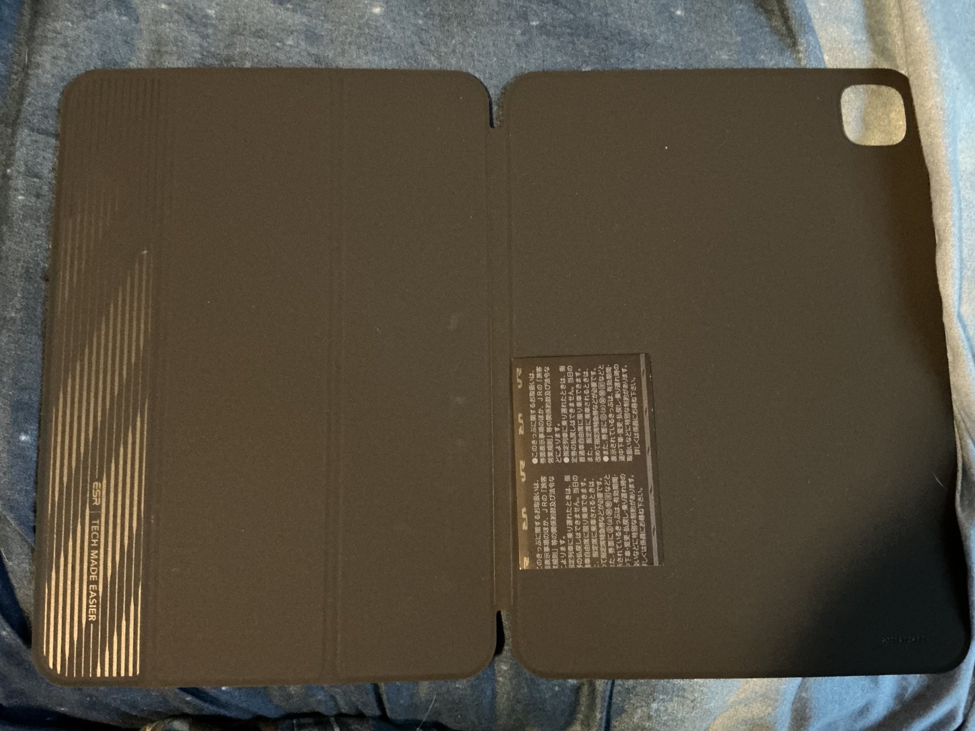

Just wanted to do another little update. With the ESR folio case for the 11. I found it if I place a thick cardstock in this location, the lock / unlock function works.
The iPad itself seems to lock and unlock when two magnets line up on either side of the screen while in portrait.
There must be a magnet out of place in the case or something causing the problem.

View attachment 2379218 Just wanted to do another little update. With the ESR folio case for the 11. I found it if I place a thick cardstock in this location, the lock / unlock function works.
Yup, exact same issue. Seems to be an issue with the ESR cases.
