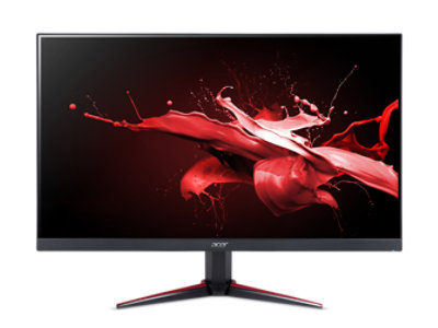

Are there any issues using a cheap monitor with the new M4 Mac Mini?
For example, this monitor.
Thank you.
You lose nothing out by buying a cheaper screen from a reputable manufacturer.
But it might be worth your time paying double to get a QHD monitor with a better response time and double the resolution.
But it depends on your eyesight. I'm in my early 40's and actually prefer the slightly softer look of 1080p at the distance I'd sit from my monitor
Thank you.
Any monitor with a low PPI is going to give a sub-par experience. Apple devices work best with retina displays.
Ok so here's my advice.. They are quite rare, but if you want retina-like display at a bargain price, try to pick up a used 24 inch 4k monitor. You can get them, in the UK at least, for around £100 - £200. This way, you will get something akin to the quality of an iMac screen for WAY less money.
Thank you.
I used a 2016 16:9 1080p $100 LCD for the first month with my Mac mini, until I got my imac Franken-monitor conversion done. macOS was fine on a low-res, cheap monitor. It was just a low quality monitor and I wouldn’t want to live with such a low quality display long term.
