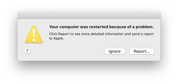

Hello everyone,
since installing the Mojave Security Update 2020-002 I do get a message that my Mac Mini 2018 was restarted because of a problem even I shut it down normally. The Mac Mini 2018 was running fine for 3 months. The Apple Hardware Check does not show any errors. Also tried to reset SMC and PRAM.
Is this a known bug? Just curios wether Mac mini 2018 users who also installed Apple's Security Update 2020-002 do see the same error message?
The Diagnostic Report reads as follows:
Code:
{"caused_by":"bridgeos","macos_system_state":"shutdown","bug_type":"210","os_version":"Bridge OS 4.4 (17P4263)","timestamp":"2020-03-28 22:10:39.00 +0000","incident_id":"907CAD79-9364-4588-A25A-3810D0E72F8F"}
  "build" : "Bridge OS 4.4 (17P4263)",
  "product" : "iBridge2,5",
  "kernel" : "Darwin Kernel Version 19.4.0: Mon Mar  2 20:38:56 PST 2020; root:xnu-6153.101.6~2\/RELEASE_ARM64_T8010",
  "incident" : "907CAD79-9364-4588-A25A-3810D0E72F8F",
  "crashReporterKey" : "c0dec0dec0dec0dec0dec0dec0dec0dec0de0001",
Update April 11, 2020: I did some further testing regarding my initial issue. I have restored from a previous system backup using SuperDuper. This backup clone does NOT include the Security Update 2020-002 Mojave and Safari 13.1. Surprisingly the shutdown message still shows up sporadically when I power on the Mac mini. I have completely shut down my Mac mini 2018 around 10 times. I have waited 5-10 minutes. 4 of 10 times the crash report showed up. It's really difficult to debug. What's interesting is the macOS Mojave Software Update does not show the Security Update 2020-002. So it seems to be already applied. I guess it is definitely related to the T2 BridgeOS Update or other firmware settings which have been patched during the Security Update 2020-002. Restoring from a 4 weeks old system backup does not resolved my issue
Update April 24, 2020:
Workaround: As user @wywh pointed out, do not use Safari until Apple fixes the bug. I have set the default browser to Firefox and the shutdown message no longer shows upon a cold boot.

Hi I have the same problem .After doing the same trouble shooting I thought i would just erase the whole thing and go back to my back up system witch did not have this problem.
So I erased the hard drive and reinstalled the backed up system, even this is now giving me the same message !!
regards
Chrisus

@chrisus Thanks for your reply and testing.
According to Mrmacintosh both the 2020-002 and 2020-002 Security Updates upgrade BridgeOS to version – 17.16.14263. So it is obvious restoring from a back up system doesn't not help.
Same issue here, 2018 Mac Mini running Mojave. This started happening after the security update, which seemed to complete without issue. Pretty damn annoying.
