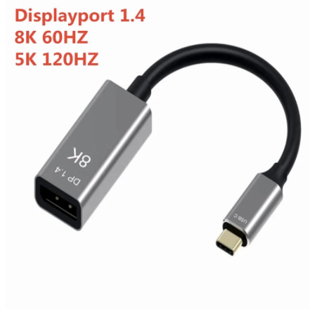

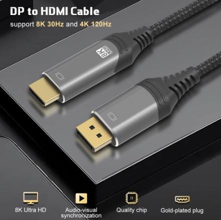

I have MacBook Pro M1 2021 TB4 and LG OLED TV HDMI 2.1.
As I understood there is restriction for 4k 120hz output and limited to 60hz in MacOS when HDMI on another side.
I wonder will it work 4k 120hz with dongle TypeC -> DP 1.4 female + DP 1.4 -> HDMI 2.1 cable ?
No it does not. I tried this with my 2019 Intel MBP 16" and tested the CableMatters USB-C to DP 1.4 -> Club3D DP 1.4 -> HDMI 2.1 adapters. This setup worked perfectly from the USB-C port on my desktop PC's 2080 Ti but on the MBP it worked the same as USB-C to HDMI 2.1 adapters/cables, namely you only get HDMI 2.0 performance.
Thank you for your answer. Helped me a lot. So The only way is to wait for MacOS HDMI 2.1 support atm.
Btw, its cool that you can connect 2080Ti without upgrading to 3rd series and have a HDMI 2.1 in your setup.
