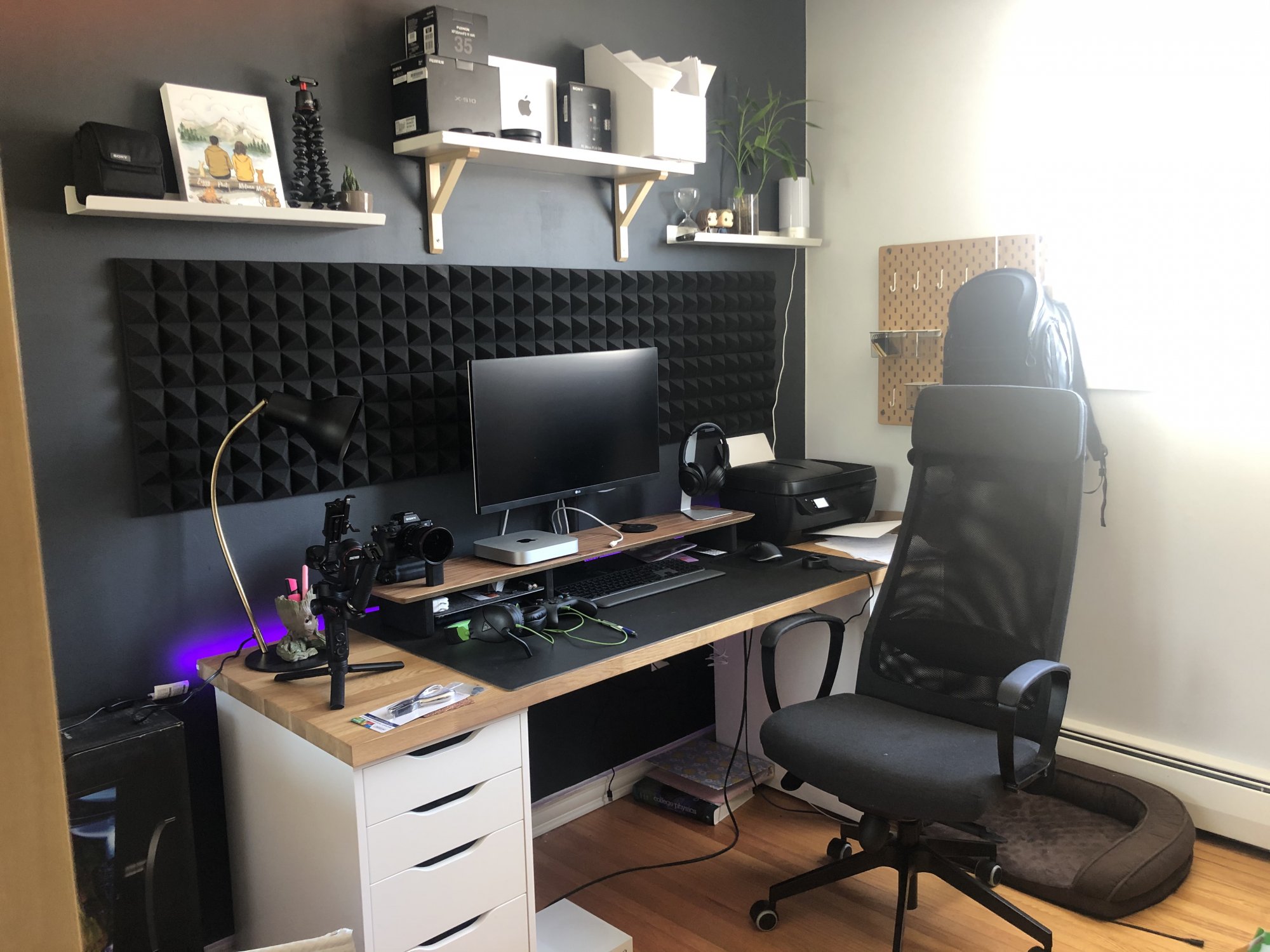

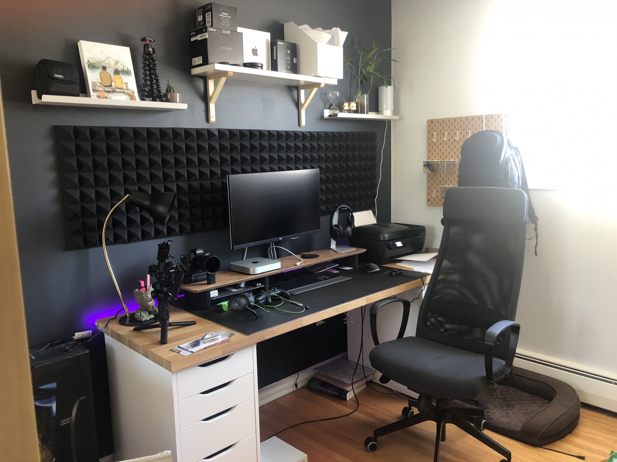

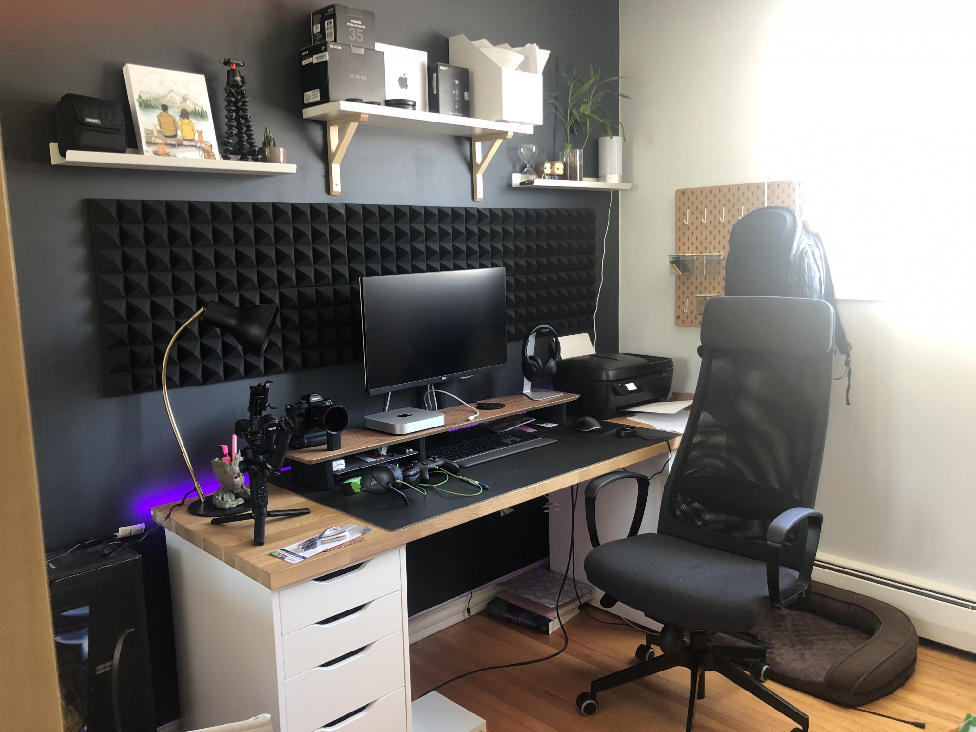

this is where it’s always stored. Right now, it’s u plugged and the fan is facing the side but usually fan faces wall
Very nice setup, even space for a Dog/Cat.
I see nowhere liquid could come from. And, to add, I do not subscribe to the condensation theory. To me, for that to happen, it would have to have been very, very hot, then very very cold.
To confirm, is there any liquid of any sort, on the monitor, or even on/behind the noise panels?
Thanks. Nice reply. I’m absolutely sure no one spilt anything on it. Literally never touched by another human and only by me pulling it out of the box and setting it down like a diamond with a choir singing hymns while I unboxed it. Can’t believe it. As you can see in the photos they’re nicely round balls of wetness too. Weiiiiiirrd. I’m strict about no liquids on or near the desk. I have an appointment with an apple approved store on Tuesday so we’ll see what happens

Have to agree with @Boyd01 somewhat. A pet...
I can say for certain no liquid of any sort came near this guy. That I know for sure, 100%. The odd thing is I didn’t even notice the liquid until I realized it was shut off so when I went to turn it on, liquid leaked out in very small smears and then I ran my fingers over the cracks between the black port section and the silver part of the Mac and noticed streaks appearing. Wipe them away, more appear. Took it apart to find more wetness inside

PS: I am sure someone probably asked this already. But, if you look up, at the ceiling above the desk, no water/liquid leakage, right?
Seems like you have to consider the possibility that a room-mate, guest or pet knows something they aren't telling you...

That plant is so dry. Hasn’t been watered in a while. Although when it is, it’s not done in the room. It’s brought to the kitchen and even if it was, it’s too far from the computer for that type of spread of water to be inside the computer only, not on my monitor or printer or anything else. No other electronics have any signs of it. I’ve also checked the wood, there’s no signs of a spill and clean up job. Or the wood on the desk, or the desk mat which shows signs easily
