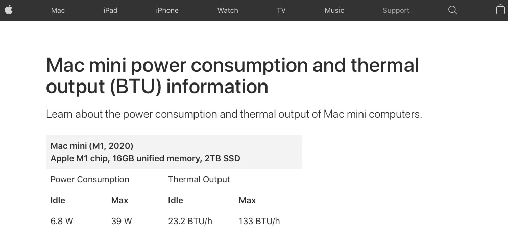

Does a sleeping MI Mini use power at the "Idle" rate? If it does then that is another hint that condensation was not the source of the OPs moisture problem. For comparison, an old school incandescent automotive dome light uses 4 or 5 watts of power. Inside of that room, even 4 watts should produce enough heat to eliminate the possibility of condensation in a device that size.
From the source:
