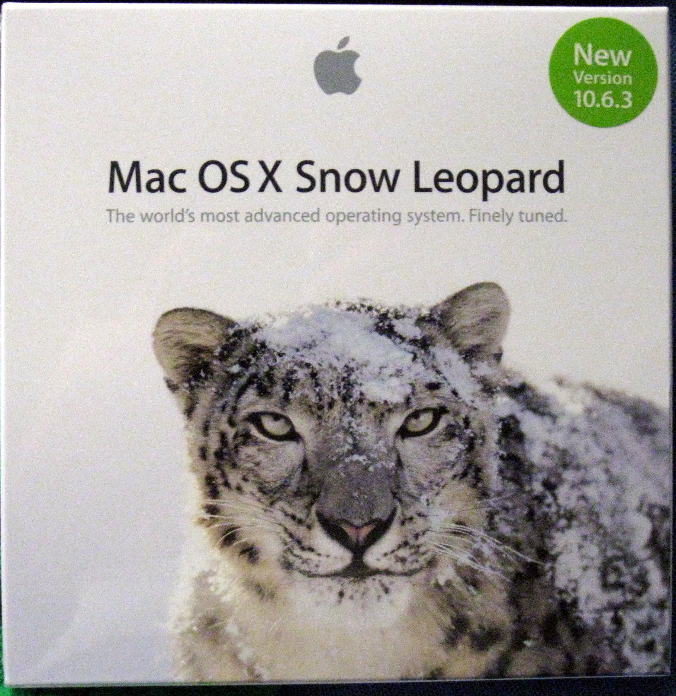

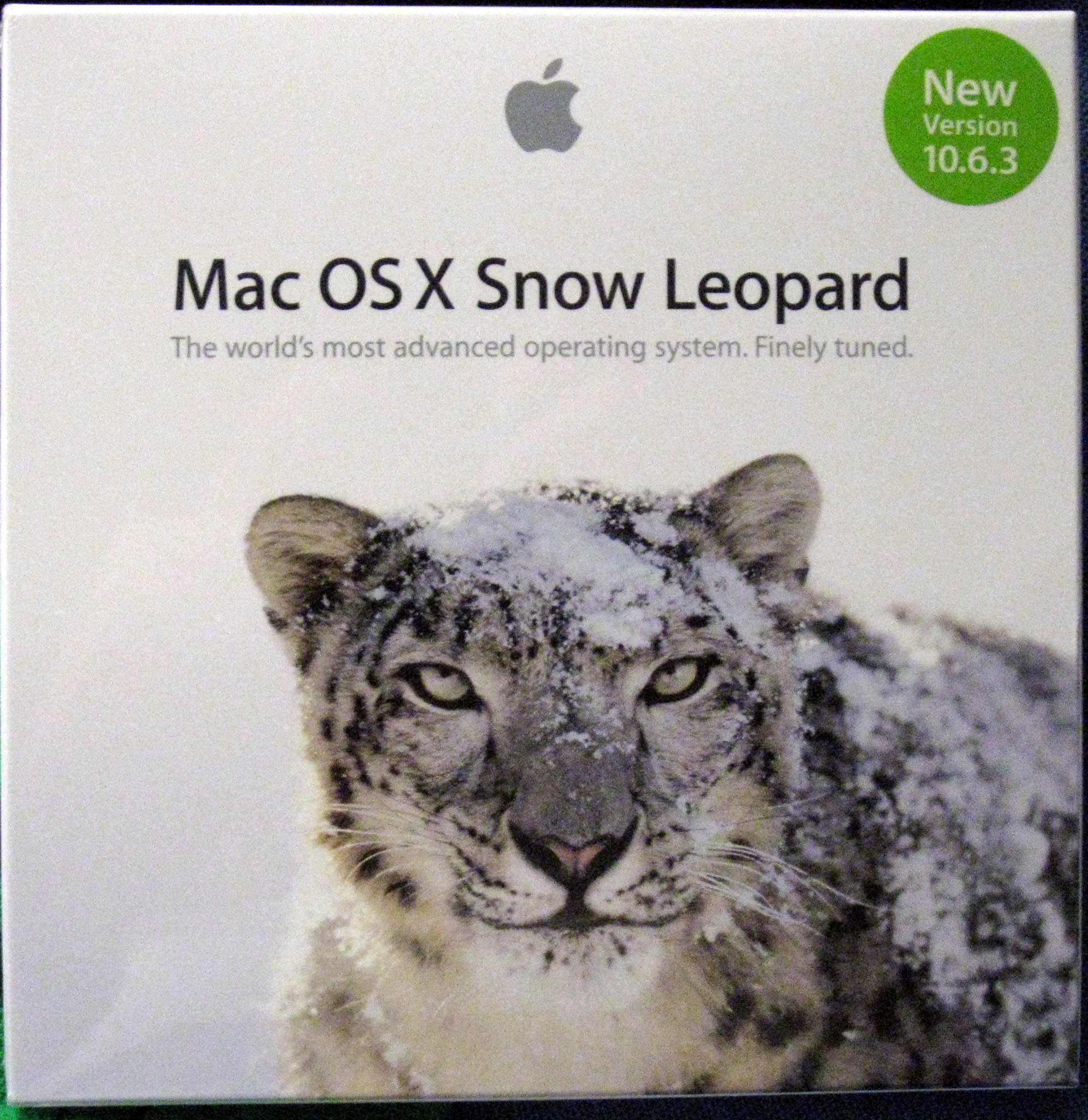

Dude sweet, so we need a 10.6.3 retail disc with a green sticker on them? Can someone post a picture of this?
-iGrant
iGrant ...
I can't post until late tonight and will not be able to test his theory until next week, but I'll try to put a pic up. If I can't, Ill send you an email w/ jpg.
Joe
Snow Leopard pics
Hi,
This is what I understand will work on new Mini Server w/o problems. Good Luck!
Joe
