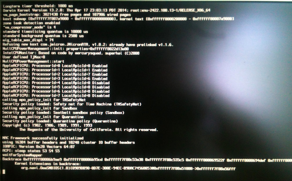

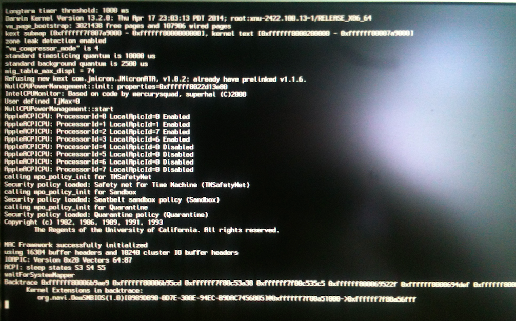

Setup : MP1.1->2.1 // 12Gb // 7300gt and/or asus 560Ti 1mb.
In short, did the 1.1 -> 2.1 update yesterday and after 6-7 tries with to create
a USB stick I finally managed to make a bootable one AND managed to instal
Mavericks...kind of.
The problem is that I can only successfully boot into 10.9.3 in safe mode.
If I try to boot it in normal mode the boot hangs after 10 seconds in a black screen with text (see attachment) . Nothing happens after that.
If I boot in safe mode I get to the desktop with both the 7300 & 560Ti.
Things seem to "work" there, obviously slowly with 7300 but with 560Ti
things seem to work a bit better. Safari lags with both etc...
Updated the CUDA to 6.0.46 but it shows in red "Update Required".
GPU driver version is greyed out and 8.26.21 310.40.35f08.
Nvidia Driver manager does not work, gives the "Unable to open...try again or reinstall.."
Have reseted the Pram & SMC, and have read this thread couple of times.
Boot.efi file is from the Tiamos post on page 2, 463kb.
So if anyone can give me some pointers I would be a happy camper! 🙂
It looks like there are some remains of the hackintosh way of installing Mavericks (or ML perhaps). I've only come across OemSMBIOS in that context, e.g. on tonymac.
Wow dude!!! Bang on! Thanks to your heads up I got things running!!!
