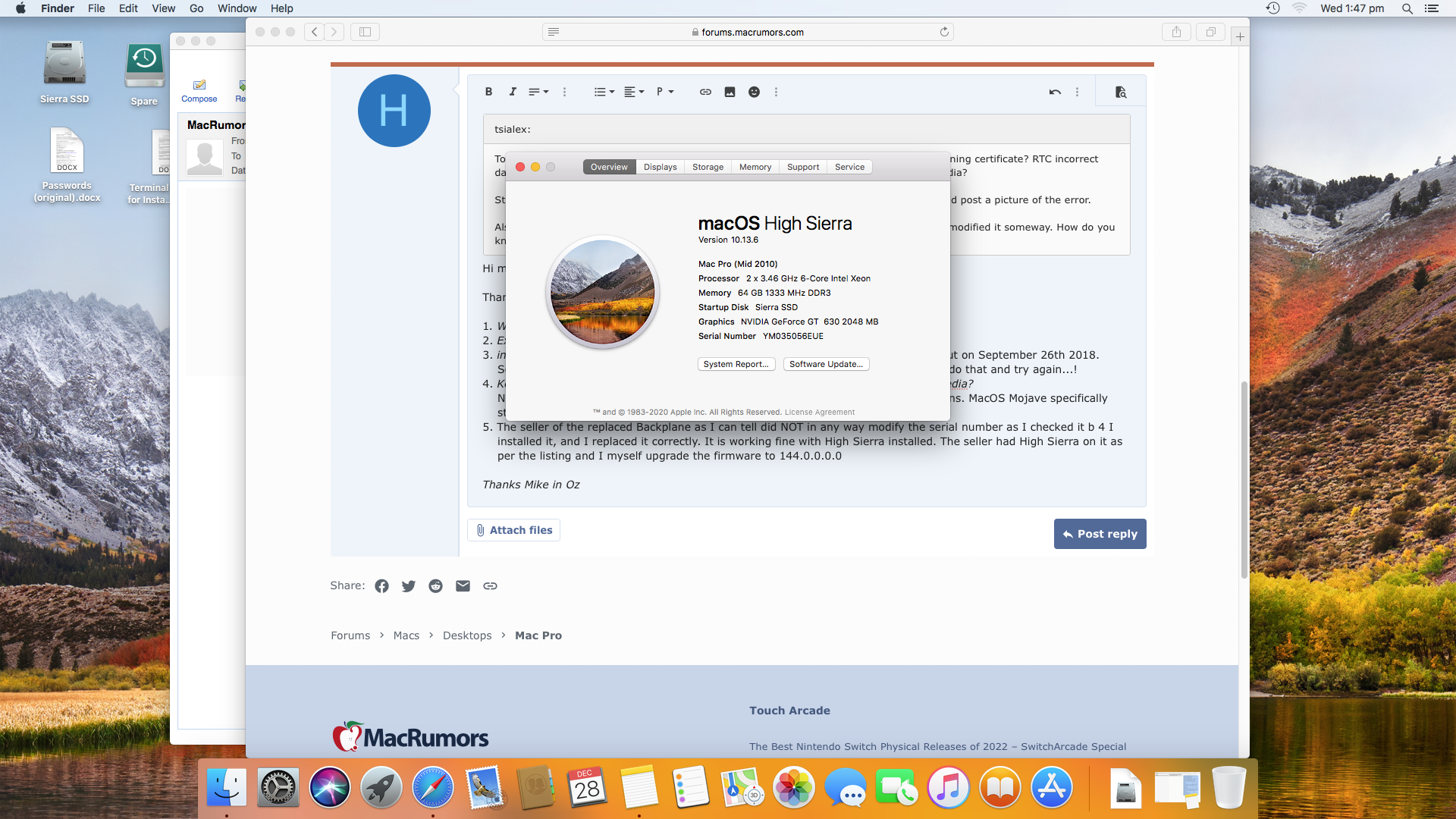

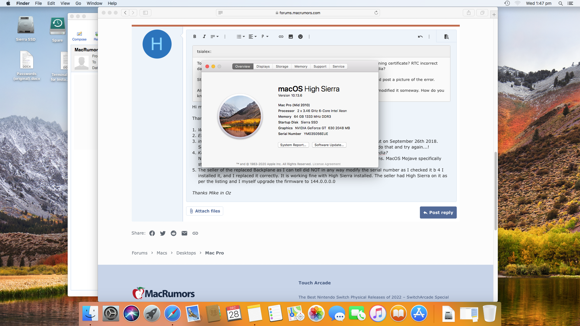

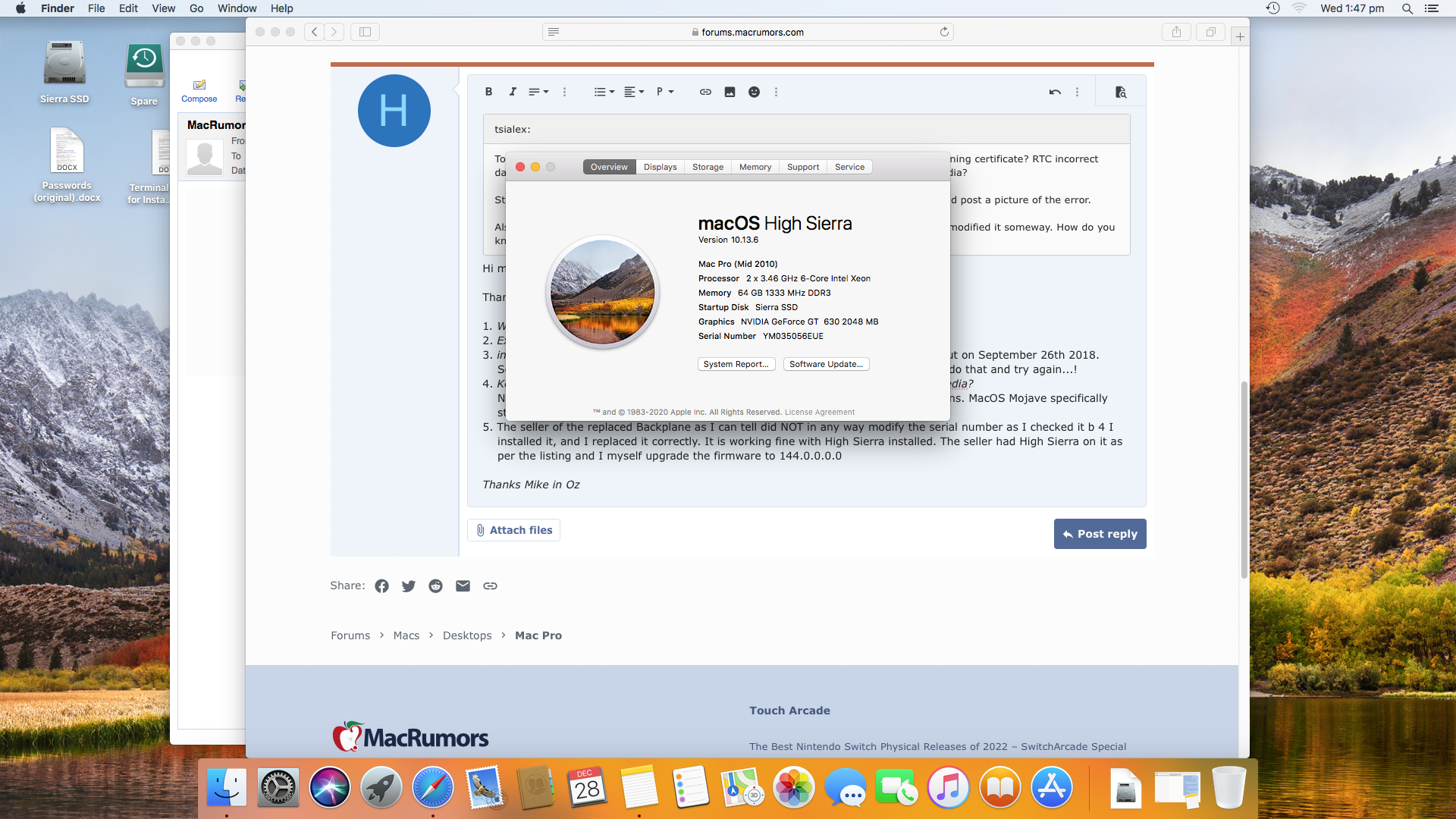

Hi mate
Thanks for getting back so quickly. To answer your questions.
1. Where the install is failing? - All the three installs would fail, about half way through.
2. Expired signing certificate? - Sorry, I don't know what that means.
3. incorrect date? - I did all the installs in the past 2 weeks. However Mac OSX came out on September 26th 2018.
So are you saying I should try back dating my computer using Terminal, if so, I can do that and try again...!
4. Kepler GPU that needs to be installed from macOS and not from USB createinstallmedia?
Not sure what you mean by "Kepler". My METAL GPU was installed B4 any installations. MacOS Mojave specifically
states that metal cards must be installed and FireVault disabled.
5. The seller of the replaced Backplane as far as I can tell, did NOT in any way modify the serial number as I checked
it before I installed it. I replaced it correctly. My 5,1 is working fine with High Sierra installed. See screenshot
below.
Cheers Mike

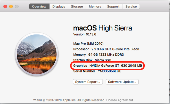

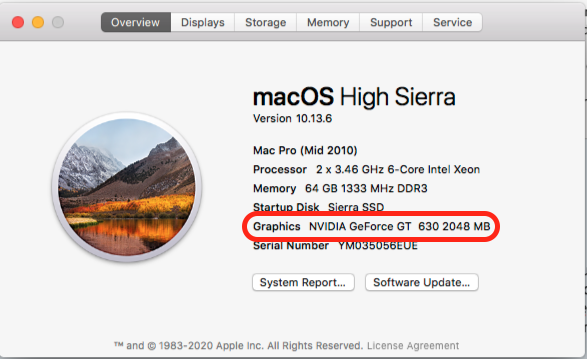

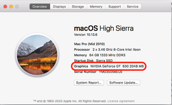

Do you even know for sure that the SSN that About My Mac shows, YM035056EUE on your screenshot, is the same as the one factory printed on the ESN label that is located on Mac Pro case near the video card outputs?
If is the same serial as the factory printed on the ESN label, the BootROM data was tampered since a replacement backplane will always have a different SSN or no SSN at all. Second hand backplanes always have the SSN from the Mac Pro case where the backplane originates. Apple bought replacement backplanes have no serial number at all and is the technician that will use a special Apple software called Blank Board Serializer that will write the Mac Pro case Serial Number to the blank backplane after the backplane is installed to the Mac Pro case.
Did you really checked it as you wrote on the first post here? The backplane seller asked you for the Mac Pro SSN?
